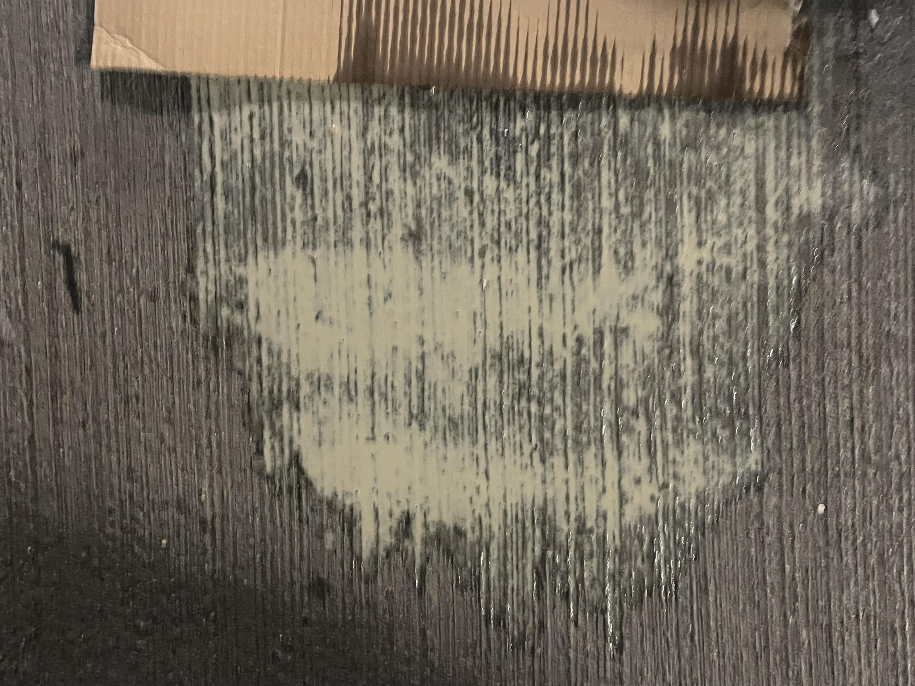

The gearbox was serviced about 8k miles ago. I thought maybe the oil was low so went to have a look today, and I was shocked that a load of milky oil came out the the fill plug (pics below).
Could anyone help me with how this might have occurred? And what next steps I should take (apart from obviously not driving the car)?

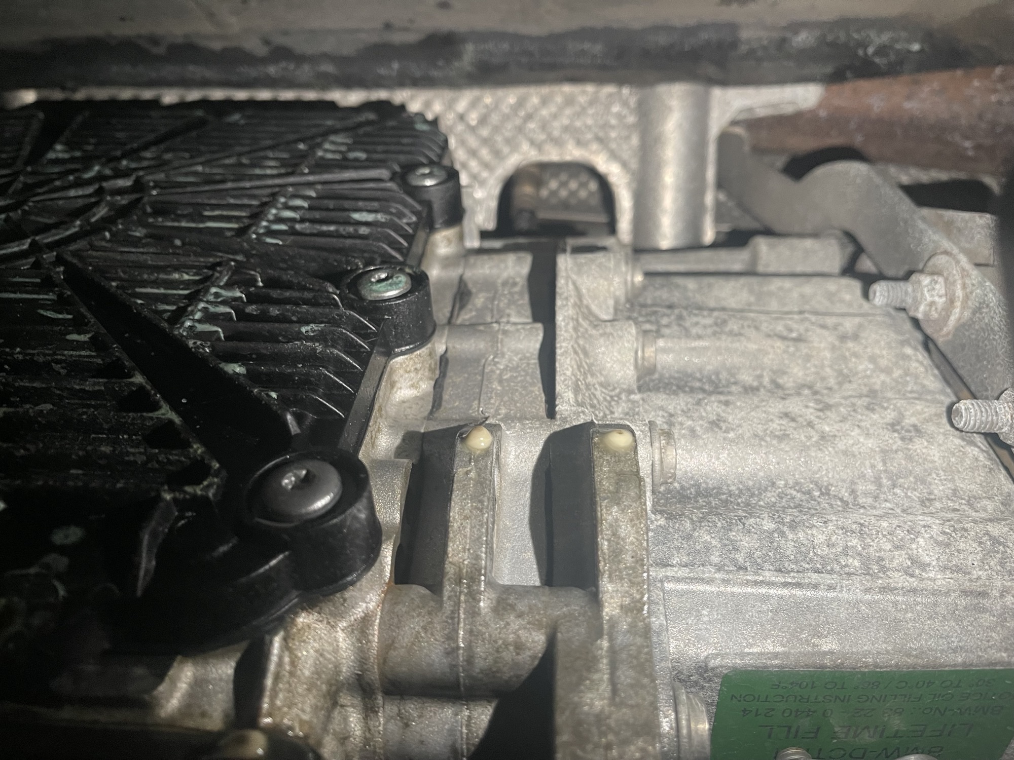

I have a small coolant leak from one of the o-rings on the engine thermostat housing which must have perished over time, and does drip a bit - you can see some dried coolant on the DCT pan. It was next on my 'to-do' list. But I can't imagine that this could have got into the gearbox?

There is a heat exchanger on top of your transmission that could have sprung an internal leak allowing coolant and transmission oil to mix. Sounds expensive.

Yup - was looking on realOEM and saw that. Would the oil not be under much greater pressure than the coolant though? i.e. you'd expect the oil to flow into the coolant?
I have no idea how I flush the milky coolant out of the box, plus I assume the clutches are probably cooked at this point.

Coolant dripping from one of the o-rings that comes out of the TSTAT housing and it does loose a fair bit of coolant when driving but I can clearly see it coming from here. Even if there was a way for it to get in to the top of the gearbox (I don't know if there are any open holes on the top of the gearbox - wiring harness?), I struggle to see how it would get in in such a quantity.
Which brings us back to either a) the heat exchanger, or b) incorrect fluid.
To address b) - here is the invoice from the garage that did the DCT service. It was a BMW specialist so I would hope they would use the correct fluid but as you say, stranger things have happened at sea. I do think it is correct though but welcome thoughts?
Also the gearbox is way overfilled - which makes me think somehow coolant is getting in. It came out at pace when I opened up the fill plug and I think if it was at the correct level, it should only dribble out.
