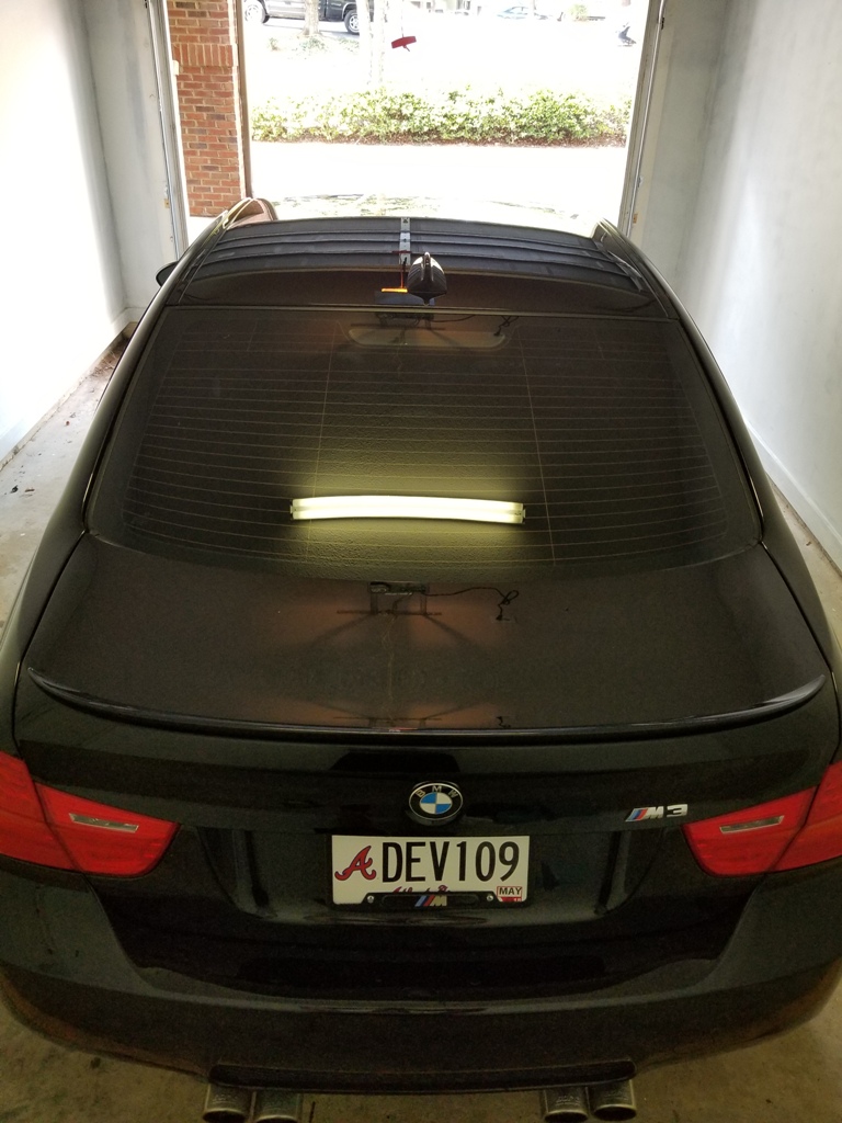

Tend to agree they are not great. Thinking about doing something about them, we'll see.
Speaking of which, do you have a picture? I ask because I bought my E90 with Borla already installed. I have always disliked the look of the tips and have always thought that they stick out beyond the bumper too far. I'm curious if the previous owner got an early example when they only offered the E92 and "made" them fit, or if this is just what the E90 system looks like.
I've considered, pretty much since the day I picked the car up, to hack off Borla's tips and replace with something more E39 M5-esque. Borla's are too rounded off. I like the straight cut off the MPE for example. Style aside, mine appear to stick out too far.
Dat sound doe
Right on! Have you tried to adjust? I've pushed mine as far in as possible and still the pipes are sticking out too far. Double checked with Borla it was the E90 rather then E92 shipped (11803 vs 11802 if I rem correctly) which they confirmed. Still putting on the S-type the fit and length was perfect. When they are hidden the way they should I think they are alright. Coming out too far = uggly. Also plan to have them cut off and get some polished single wall on, would be good. So far however haven't managed to find a shop who want the job. Keep searching!
Yes, sound is great. People claiming its too low must have an ear issue though, working mine to get aligned with the roar...
I have not tried to adjust anything in all honesty. I feel as if I'm a live-to-work instead of a work-to-live guy here as of late
My E90 is currently at the shop getting rod bearings, shifter, motor mounts, blah blah done. Otherwise I'd run out and snap a picture real quick to compare to what you have. Single wall is the ideal look for this car!
Wait edit... As soon as I typed that out I forgot that I had a picture of it in the garage from last summer. Best I got for now.

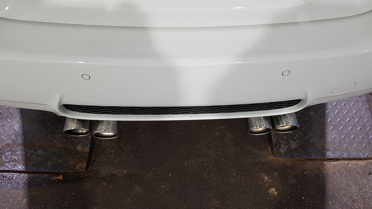

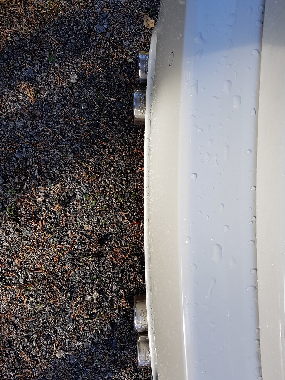

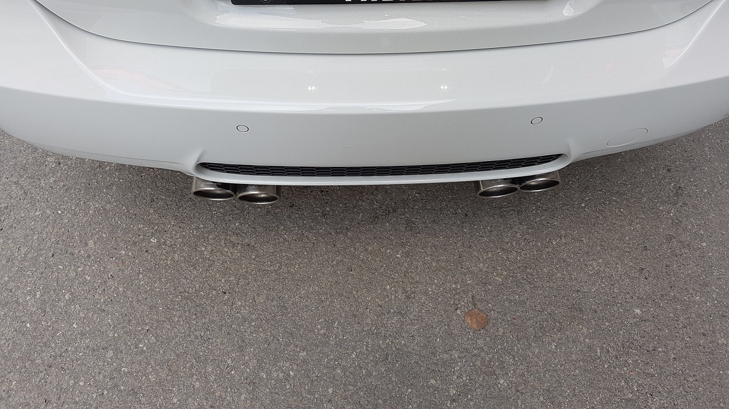

Spazzy, if they are cold yours seems worse and I bet there are possibilities to adjust. That is a 5min job assuming you have a pkace to lift her. I'll try to post a pic from here tomorrow. Nity!
Edit: Pics attached. First two of the ATAK, I probably managed to get them a tad more in than these pics.
Last pic is of the S-Type which clearly fits much better although still possible to adjust further in.
Sheesh, yeah yours are quite a bit further in than mine. I'd like to bring them in about 20mm.
My car is at the shop for the weekend getting various things done so I can't take a look. I'm assuming that there are just hose clamps of sorts holding the tips in place and then you can move them axially as desired?

The S-type on last pic for sure is but again my ATAK which is on is not far behind your. Yep, one clamp per side, very easy soon as you have access.
