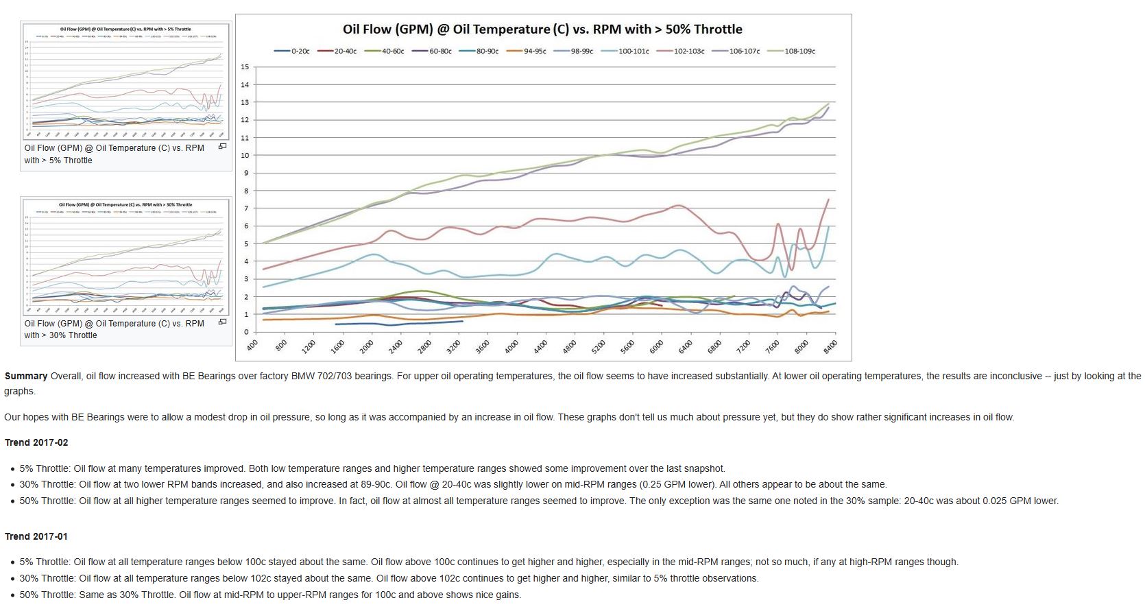

The first thing that raised my eyebrow was the section where they referenced oil flow:
Name:  BE Stock Oil Flow.JPG
The fact that oil flow never gets above 2.5 GPM until the motor reaches 100 °C, then has a roughly 300% increase in flow from 98 °C to 103 °C and a 600% increase in flow from 98 °C to 109 °C tells me that the sensor (Flow Tech, see the next image) was mounted between the oil thermostat and the oil cooler. This placement is H I H G L Y problematic-
Name:  Flow Tech turbine sensor.JPG
Placing the flow sensor between the oil cooler and the thermostat is problematic because, even when the oil is above operating temperature and the thermostat is fully open, a percentage of the oil can still bypass the oil cooler as a function of DeltaP between the two routes of flow- the oil cooler is a restriction on the system, as is the fully engaged thermostat. Pressure is a function of flow and restriction. More on that later.
This creates a multi-dynamic scenario in which one of your key data points is influenced by more than the single variable you are testing. In this case, the flow measured is influenced not only by the intentional change you are making, but also by the secondary effects your change has on the flow rates of the thermostatic bypass and the oil cooler, which will not necessarily be affected 1:1. There are a handful of easy workarounds for this that they chose not to do, either because they did not think it would matter, or because they were unaware of this issue. Either case is cause for concern IMO.

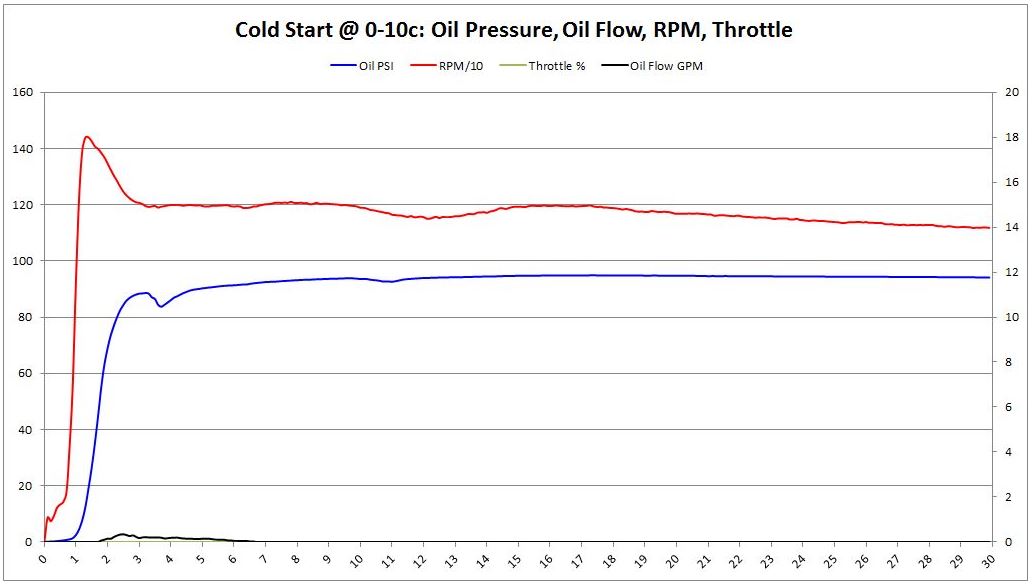

Then, I saw their claims about the time to pressure being significantly shorter
This honestly had me baffled- I was lost at how this could be possible. Maybe because the reduced restriction allowed any air in the system to escape that bit faster? doubtful. Maybe because the theoretically increased flow allowed the pressure to get to the bearings faster? I don't think that's how it works in a system like this- the pump is going to move a specific volume below its relief pressure. That line of logic led me to the smoking gun. RPM.
I am going to have a lot of screenshots of their graphs here; bear with me while I try to illustrate what I noticed.
0-10 °C BE 1.9 seconds to 90% pressure, OEM 2.6 seconds to 90% pressure.
BE:
OEM:
Do you see it? Why did they leave out start up RPM from the OE bearing test? Also take note of the pressure dip at ~3 seconds... That is a VANOS sweep... that will be important later.
How about now?
Name:  Startup Comparison 0.JPG
Size:  18.3 KBName:  Startup comparison scaled 0.JPG
The 2nd capture is after I scaled the RPM axis to match BE, so you could also see the difference in peak RPM without it being different for no apparent reason.
Why would they overlay the OEM time to pressure in their direct comparison, but not the OEM RPM log as well?
I think if they had, they would have seen where the faster time to pressure came from- not the bearings, but the different startup profile- possibly from a tune? These things matter.
Here are the rest for consideration of my overarching point- BE does solid work, they offer a great product, but this study is deeply flawed.

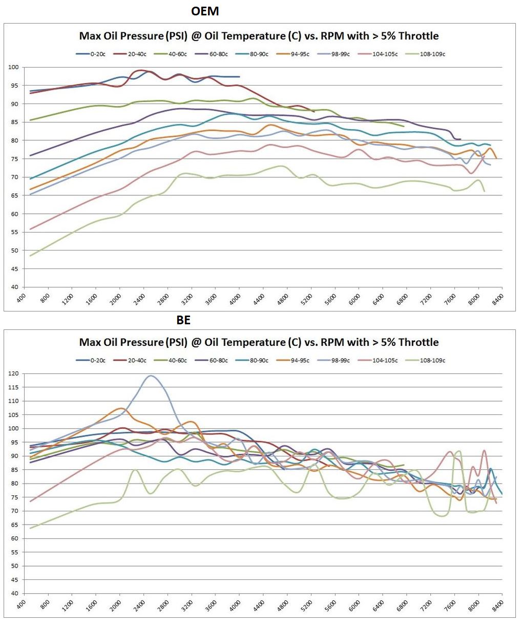

Moving on to measured oil pressures at given temperatures-
Mostly no notes. Except for a few.
These are WAY different. like... from different tests altogether, it stands out so much; not just different from each other, but also different in a way that makes no sense at all.
Name:  Max Oil Pressure comparisons.JPG
Also, why are these two graphs the only graphs that measure anything >5% throttle? you could theoretically get wildly different data for the same parameters without being outside the rules of this chart- one chart could be nothing but slow builds to redline at a steady state 20-50% throttle, the other could be WOT rips. We need live throttle data in these charts to make sense of them, not just "greater than 50%" as the tightest throttle constraint.

I cannot make sense of this either: how is it that you have both increased the volume quite significantly (we've covered why that claim is not necessarily supported) AND you've significantly increased Oil pressure in the 108-109 °C range? It is a fact that you've increased clearances, thus reducing restriction, which would theoretically increase flow volume at the same oil pressure, but how is it that oil pressures are RISING when the oil is at its least viscous? The only thing I can think of is a lack of data points for this specific range and/or an error in data compilation.
Name:  BE Oil flow chart.JPG
Finally, the claim that you have doubled oil flow volume while only losing 3PSI overall is just the result of bad data from a bad sampling point- I am sure you did increase volume throughput by increasing the clearances, and that is good for the rod bearings, but any PSI drop across the systemis going to be catastrophic to the mains due to their already sub-optimal geometries.

Moving on- here is what I am still trying to work out: The oil pump is a variable displacement rotary vane pump. It has no electronic controls whatsoever. I had one of these $3000 pumps apart last week, and I had another open several months ago (sorry Peter lol, I promise I put them back together properly). Ive been digging into them because I cannot wrap my head around the oil pressure behaviors I see in the datalogs.
What I know- the pump has two methods of bypassing excess volume, both based on pressure. Primarily, it uses variable geometry to reduce flow, thereby reducing pressure as a function of flow. Secondly, it uses a traditional bypass valve set to a higher pressure.
What doesn't make sense, though, is that if the pump is flowing more than enough oil to achieve the requisite pressure after X RPM, then the pressure should not drop off after it reaches the bypass pressure- this should happen smoothly as well, because of the variable displacement functionality. It should reach the target pressure, as dictated by the spring, and stay there. Period.
As VANOS consumes oil, the system should react nearly instantaneously to that increased volume demand- the 20 PSI swings we see in the chart below simply do not make sense in this situation. Dips and bumps, sure, but not such massive swings in pressure as seen below:
Name:  BE Bearing Min-Max pressures.JPG
What we suspect to be happening is that the oil pump is insufficient in stock form- this makes sense if you think about BMW's design goals in the early 2000s, when oil prices were at all-time highs- maximize performance, minimize fuel consumption. Maybe they thought that cars getting 20 mpg on the highway instead of 19 would sell 20% more cars, so they reduced drag wherever they could in the name of performance and efficiency. So they engineered a pump that was juuuuuuust right for the stock clearances.
Then we opened up the bearing clearances because thats what worked of the E46. Oof.
If the pump is NOT riding on the bypass spring much at all, which I doubt it is, then these variances would make a lot more sense. I cannot imagine that the pump is bypassing much at all at 70 PSI while flowing over 13GPM, if it's able to build 85 PSI at 40-60 °C at ~3kRPM and only flowing 8-9 GPM.
The bypass will bypass at a specific PSI- temperature or oil viscosity be damned. There needs to be sufficient pressure on the spring to move it. That pressure is a function of restriction and volume. At low temperatures, there is sufficient restriction (because of the significantly higher viscosity) to generate enough pressure at the volume of flow the pump is capable of producing to hit the bypass threshold. In all other times, it appears that this is not the case- even in stock form. Increasing clearances without increasing the pump flow rate will only exacerbate this.
This is a solid article on the functionality of a variable displacement pump if anyone is curious- although this one has an electronic control solenoid that allows it to be switched between high and low pressure- notice how locked in it is at its set pressure (although you have to be aware that this is a far less dynamic situation than an engine)
Performance_prediction_and_experimental_study_of_v (1).pdf
As AutoTalent said- testing equipment is expensive- the Flow Technologies turbine was $1000, and they bought it to attempt to gather more useful data. Hats off to them for their commitment.
We just spent $60,000 upgrading and redesigning our engine dyno (in addition to the initial $50,000 up front cost from SuperFlow) for the same damn reason. We want nothing but absolutely conclusive data on everything we do and every product we support.
Anything less is insufficient.
