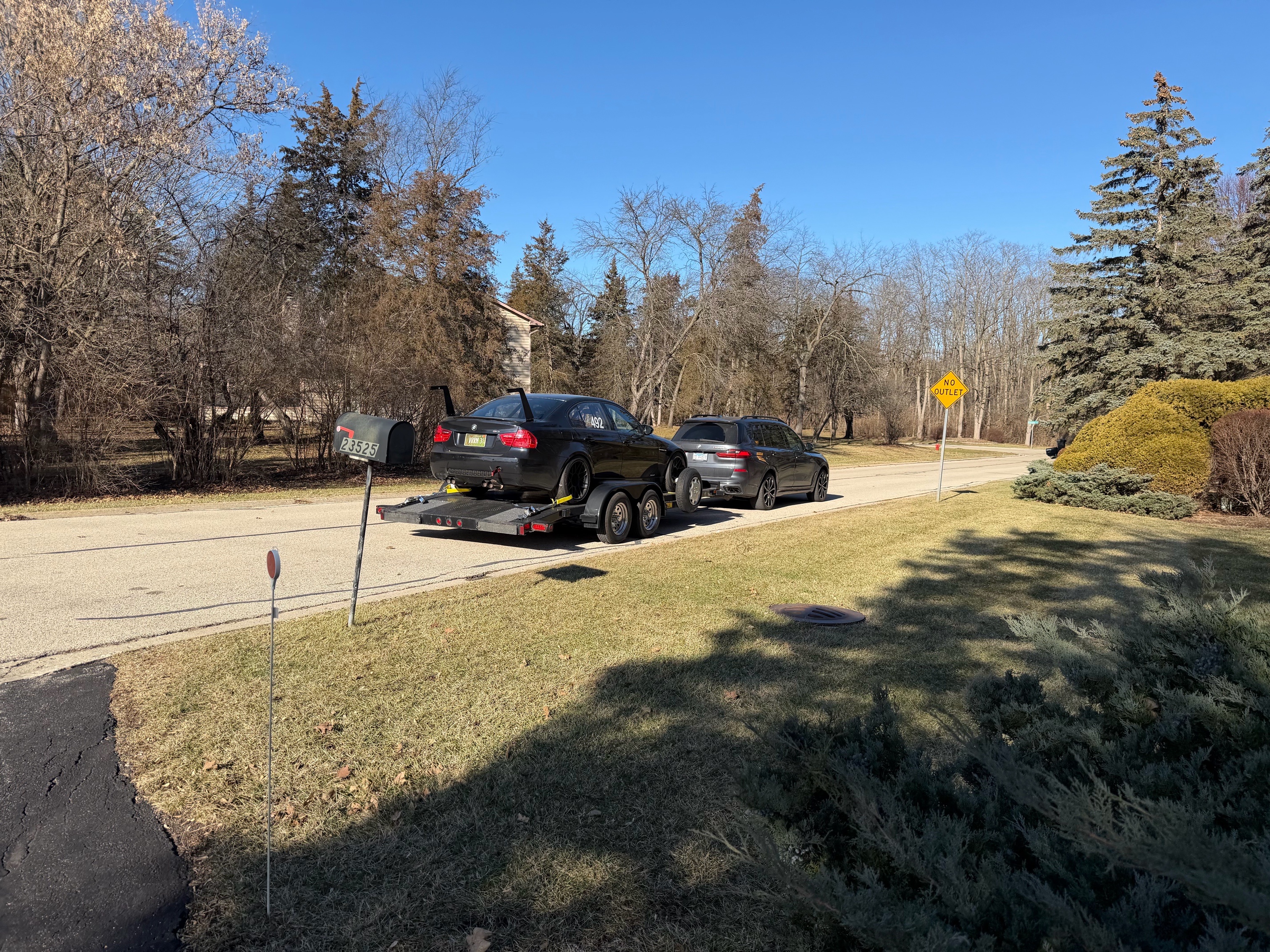

I found a picture of my strap setup.
Cool that’s pretty similar to my layout.
How tight do you go on the straps?

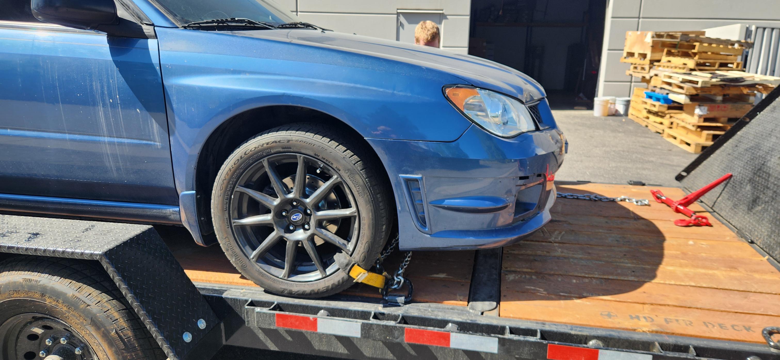

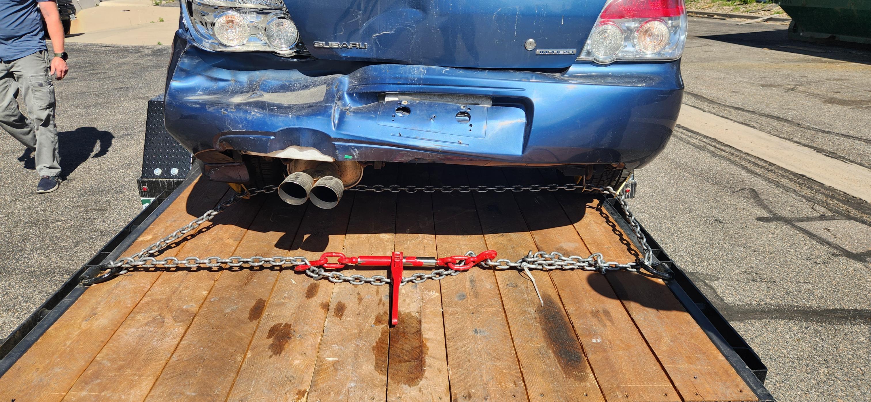

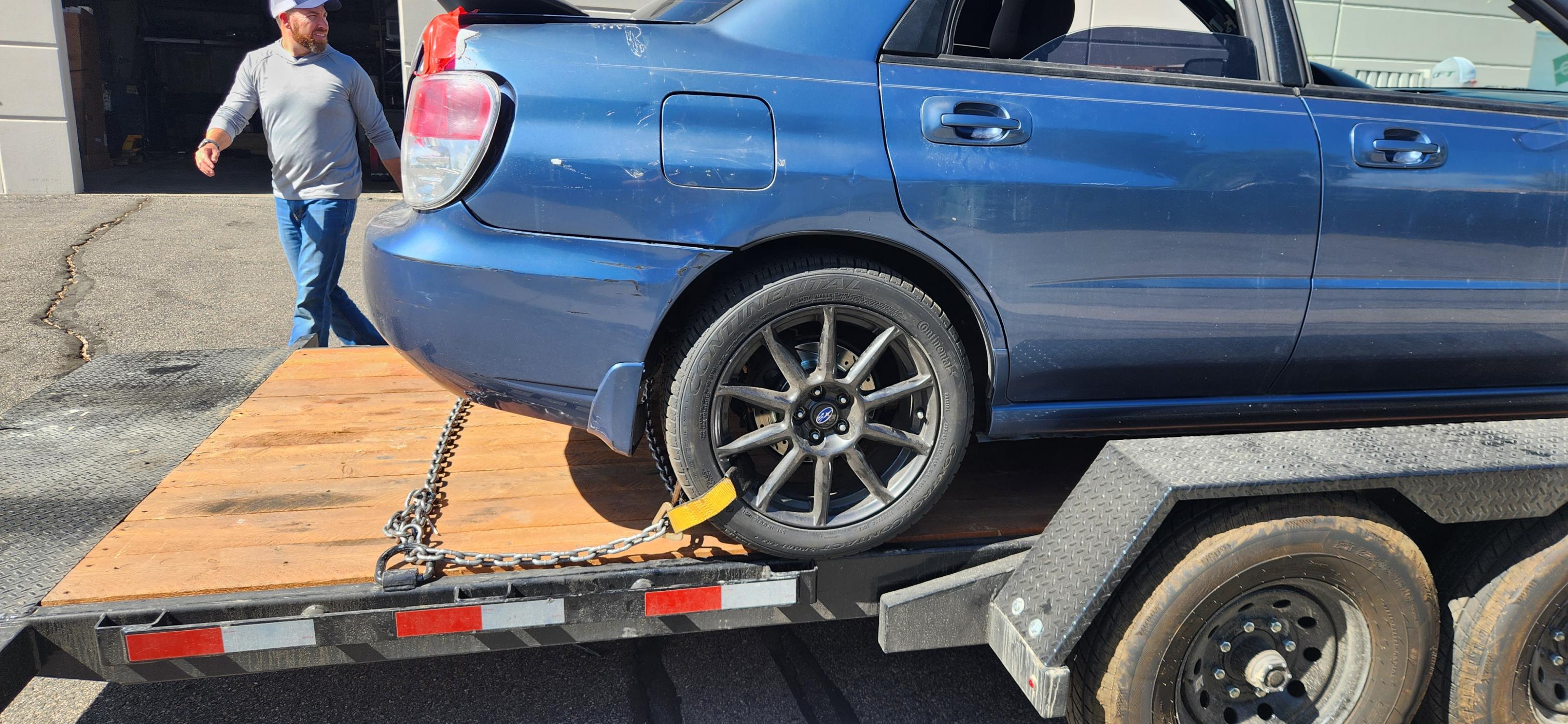

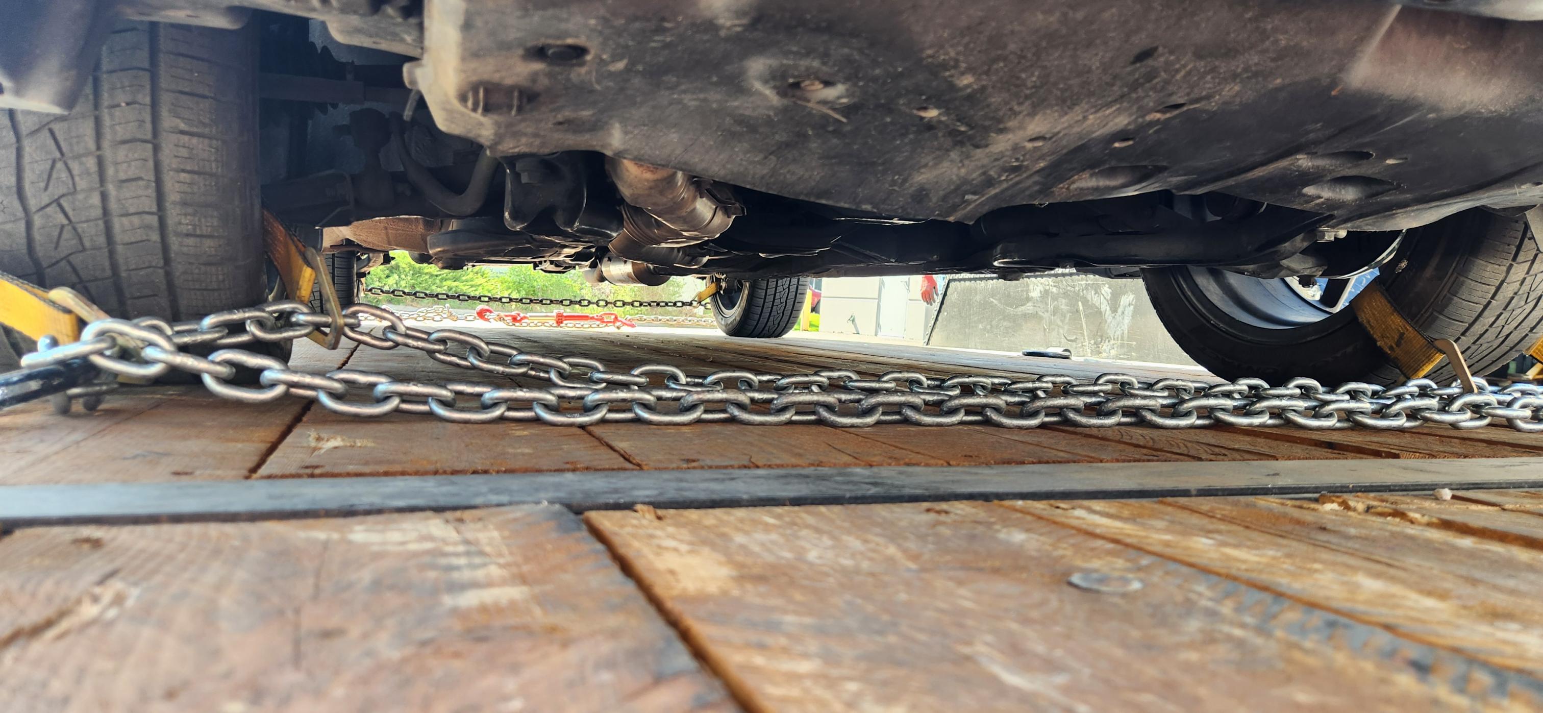

Here's our 24 hours of Lemons car. These chains are overkill but here is an option. You can change how tight you want them to be.
Attachment 3895143Attachment 3895144Attachment 3895145Attachment 3895149Attachment 3895150
Not sure if you noticed but there's a little dent in your rear bumper
I don't get too carried away, snug, but certainly could go a couple ratchets tighter if I had too.
I always place the 'D' portion of the ring on the sidewall like that, I found to far back and it'll hit the rim, to far forward and it will loosen as it'll pull the 'D' ring "forward."
So when I start ratcheting I watch how tight the strap is and how much pressure the 'D' is putting into the sidewall.
Brother, if that car was off the trailer with those "straps" then you would have much larger issues.
