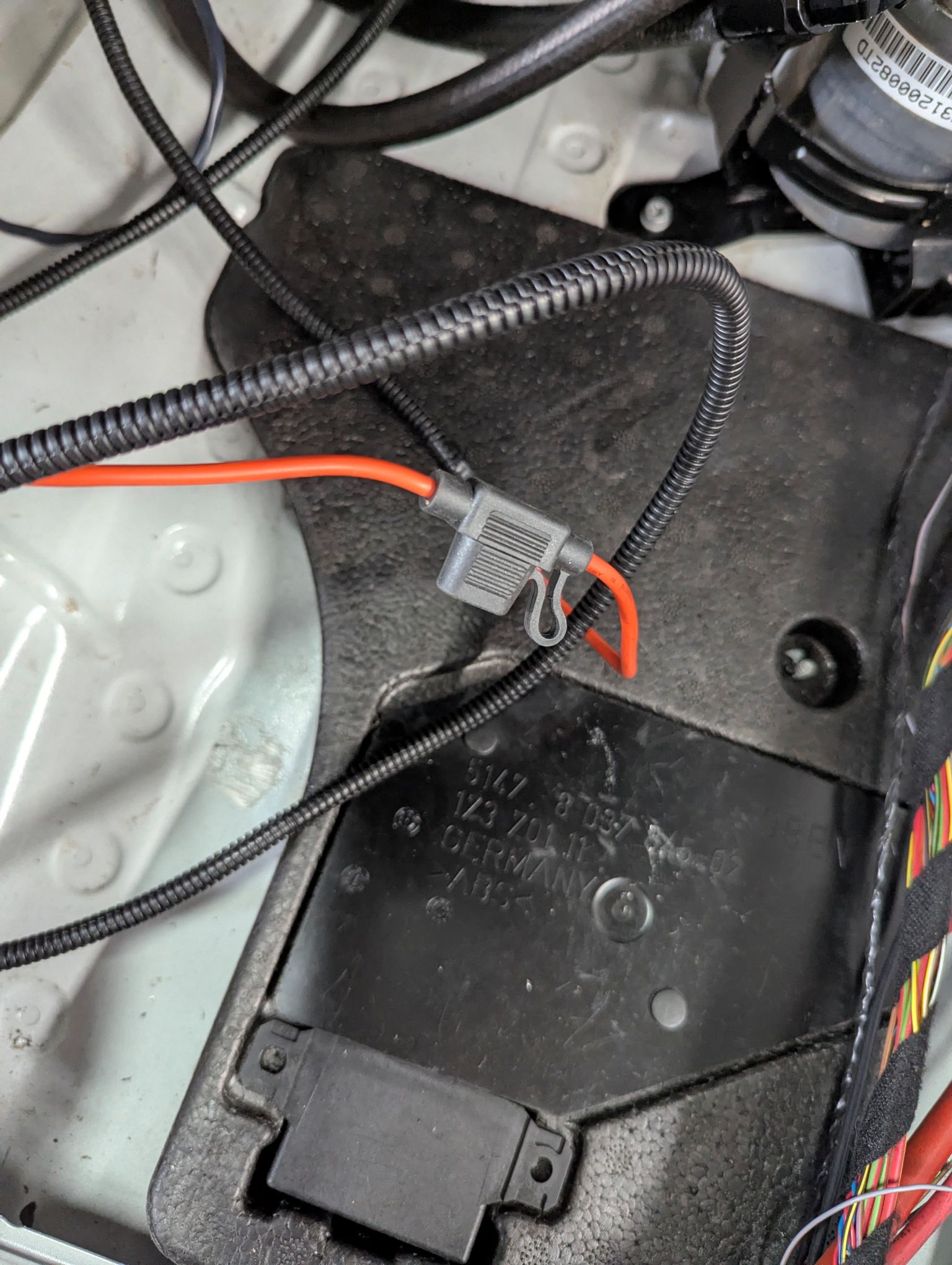

Few photos, it's a bit of a mess at the moment as I've pulled everything apart to fit a roll cage.
You can see I've put AN fittings with banjo adapters on the rack then run the lines into the passenger footwell using the hole in the firewall for a RHD steering column.
Power I've run from the jump post in the engine bay with a 60a mega fuse as the pump draws a lot of current, ground is just using the factory post in the footwell.
To turn it on I've just got a fused switch that's usually mounted on the dash when the cars not in pieces.
