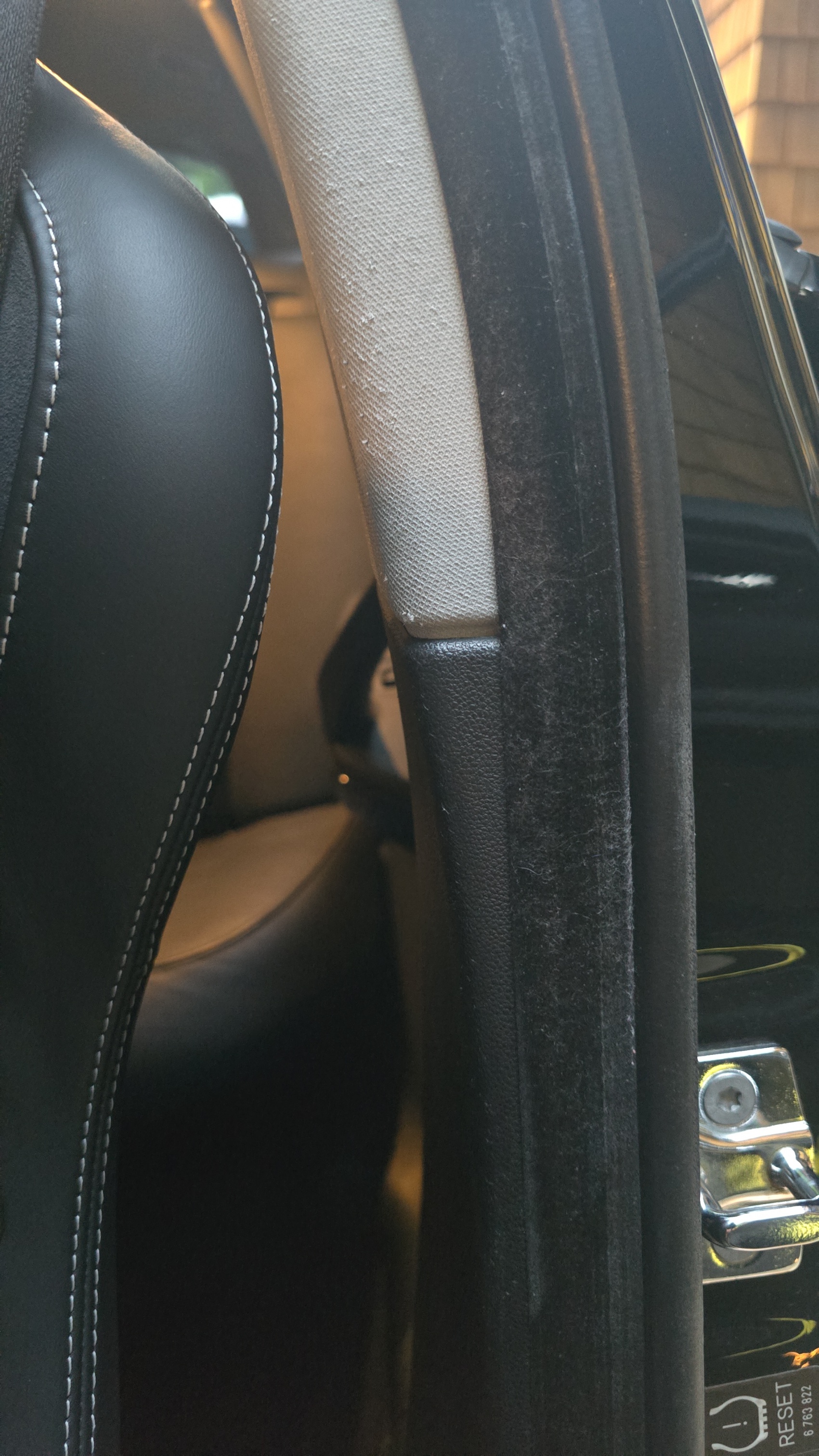

Sparco QRT Performance - Alcantara with leather and grey stitching. Mounted with Sparco side mounts, Sparco sliders, and Planted Technology base (Sparco base is a exactly the same base, labelled Sparco).
This seat does not fit well. I do not drive an M3 but a 2009 e91 LCI wagon.
1. Although this seat is advertised as suitable for both 3 point and 4 point seat belts, it is not ideal to work with the factory 3 point seat belt. Seat belt clip mounting point is not ideally located. Instead of clip mounted onto seat or seat bracket so it moves with seat when sliding back/forth, it is in a fixed location on the base. If you slide seat forward, clip is too tight/too far back. Slide farther back, clip is too slack/too far forward. Also seat belt clip isn't correct height and does not reach through the seat's seat belt hole, and is not tall enough to mount outside of the seat. Also, seat belt clip's mount is pressing too tightly into the center console.
2. I am 5' 9". When seat is slid into my ideal seating distance, the seat's right leg opening is hitting center console while left shoulder bolster hits b-pillar. I had to mount my seat onto the sliders by offsetting the right slider forward by 3-4 clicks to angle the seat and point slightly outwards (towards a-pillar).
I'll see how it performs at the track in 2 weeks but I'll likely take these out immediately after and only mount and remove for track use only. With the seat belt not properly fitting and the absence of side airbag, I am not comfortable dailying this seat.
Hey Busta did you ever find a solution to this fitment issue? I have the same seats and all the same issues with the same sparco bases. Im 5'10" and i run the seat fairly forward so the right side of the seat rubs the center console. My seatbelt just barely clears the side of the seat so I can clip it in and still get good placement and tension there but the rubbing against the console is definitely annoying. Planning to run a piece of felt there for now till I can figure something else out. I did tilt the seat on the mounts to center myself to the steering wheel so thats what contributing to the seat rubbing the console.
Not a 100 percent solution, but I did end up raising the seat a bit higher so I can slide the seat back a little, shifted the seat slightly to the left. Slide the seat just back enough to clear/slightly touch center console, and let the shoulder slightly touch the b-pillar. Downside is the seat belt clip will be deeper.
I also shoved some padding behind the Alcantara backing to push myself forward a little, bringing me slightly close to the steering wheel and giving my shoulders more clearance from the concavity. Also helps with lumbar support. I forgot to mention in my previous post, that the seat's shoulders are too narrow. I'm not a big guy but my shoulders have to round forward to fit in the seat. Then my arm has to twist awkwardly to shift gears. Going into 2nd and 4th gears, my shoulder would press up against the bottom of seat's shoulders pad. End of a drive or track session, I'd end up with a sore shoulder.
Not surprised. When I was seat-shopping I tried the QRT-Performance and also felt it was pushing my shoulders forward. I'd probably be fine like that for a track session but not on the street. Did seem like it would hold me snug though. And it was beautiful. I was looking at a red one.
