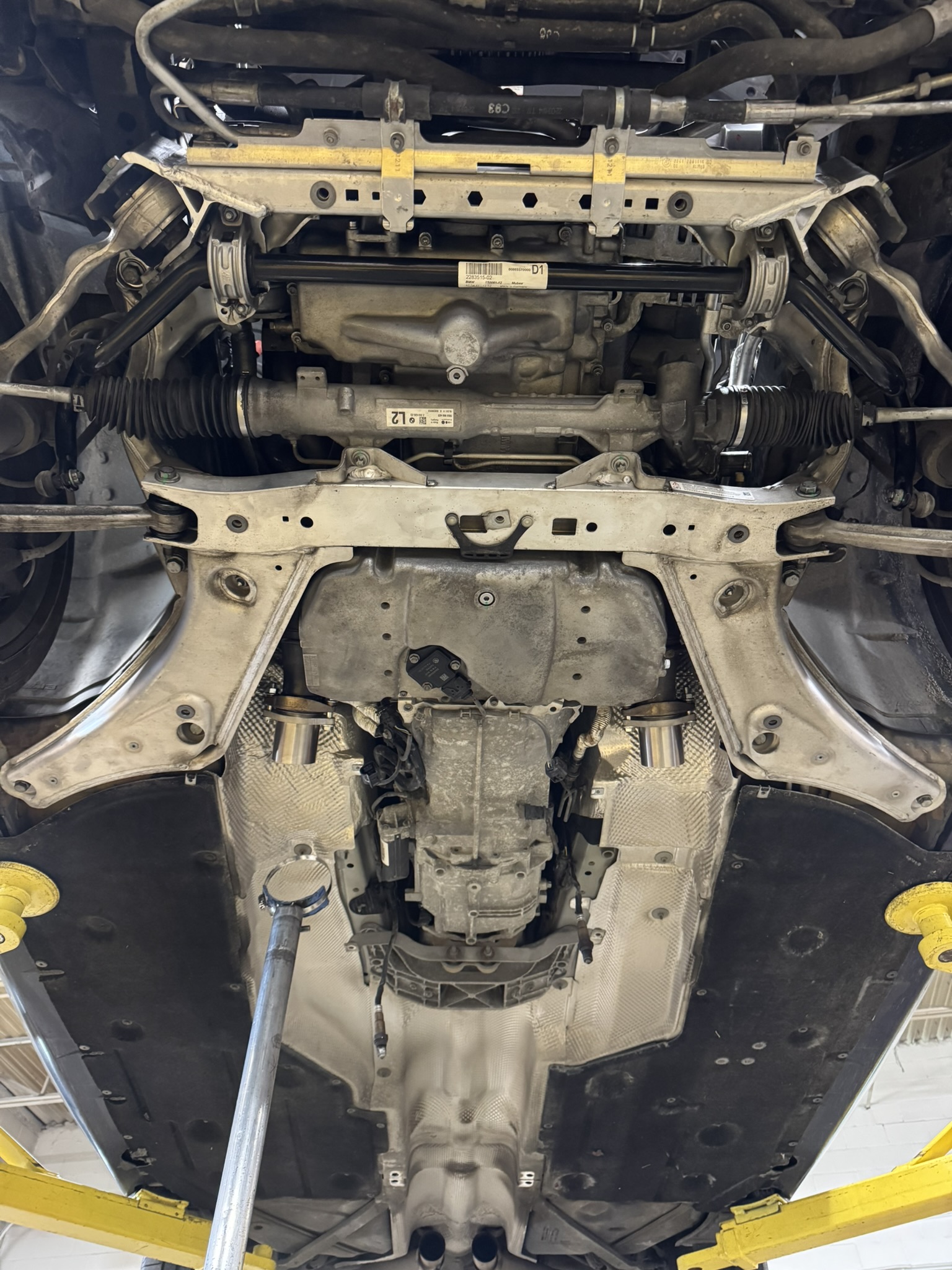

Engine mounts were toast, new ones installed alongside a refreshed front subframe.

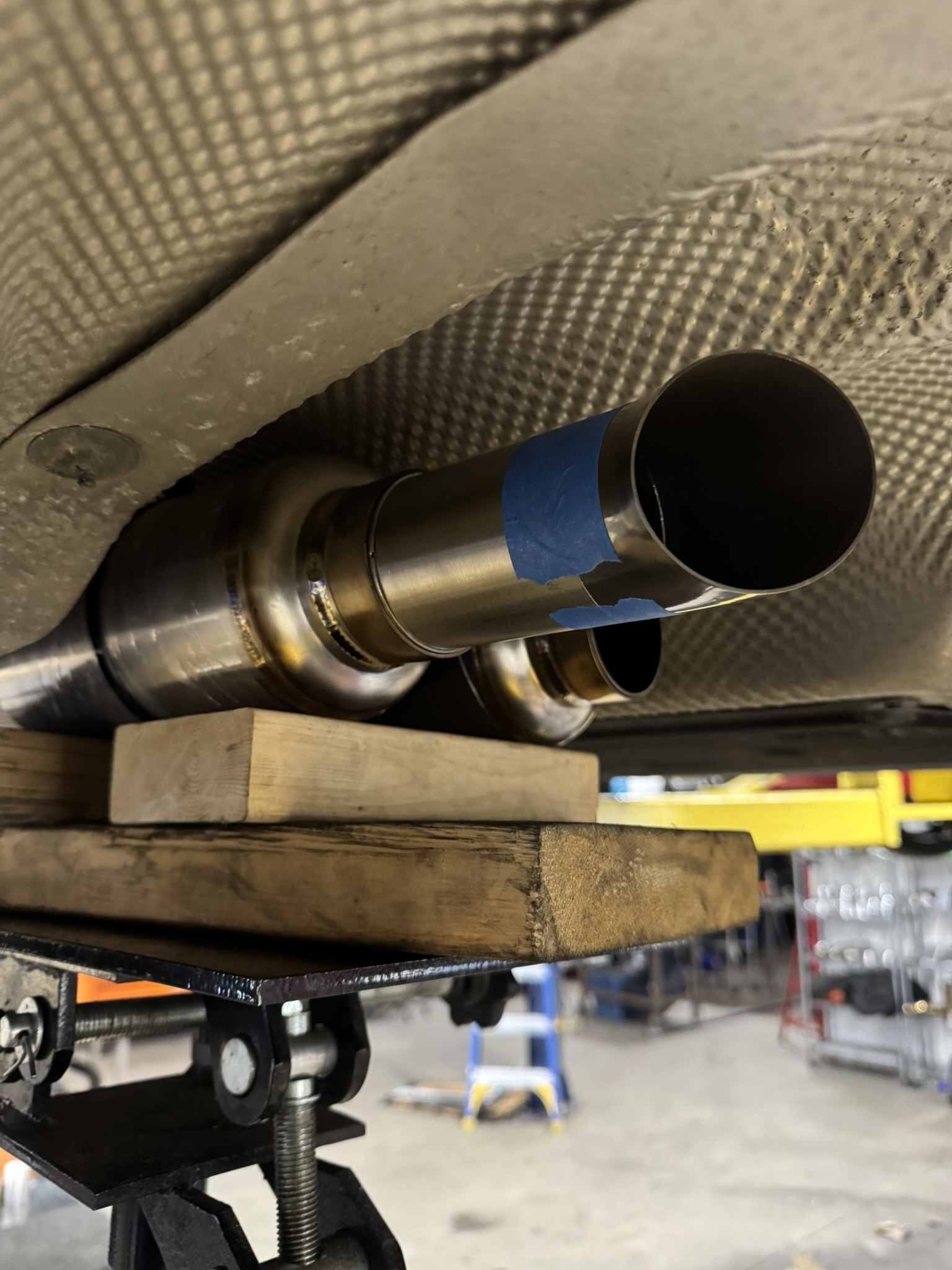

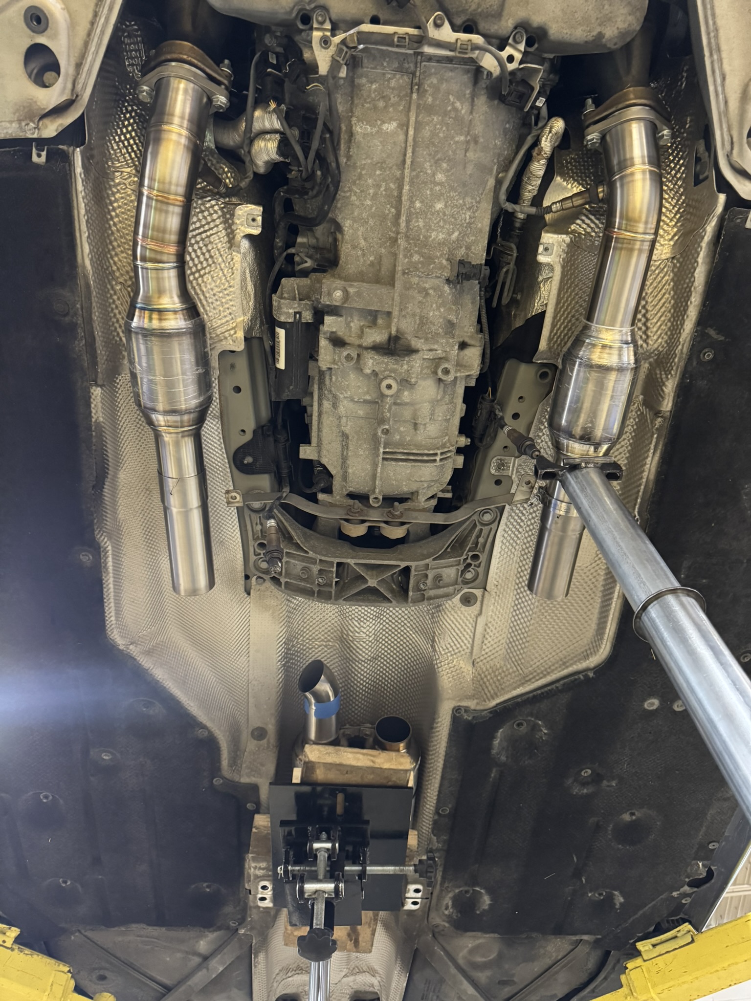

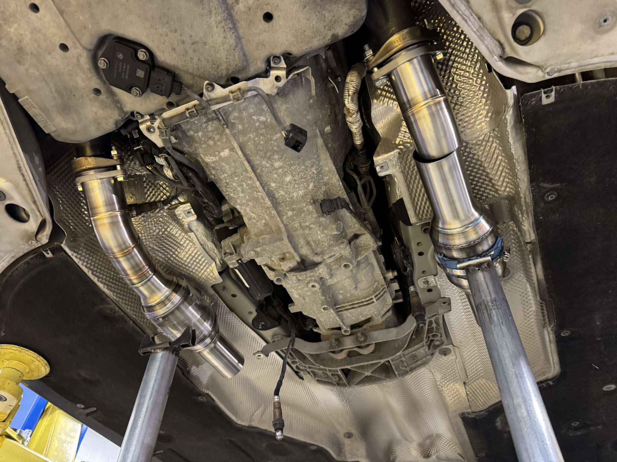

Some more updates. The custom Ti exhaust with valve controller and GESi high flow cats is progressing nicely. We're aiming for the entire system to weigh about a third of the OEM system that sits right around 100 lbs for the mid pipe and muffler.
We're also putting in a CF drive shaft with an upgraded dual plate organic clutch and single mass flywheel, as well as a Dinan CF strut tower brace.

WOW this is looking fantastic.
Those are some GREAT welds on the titanium also. What a build.

Man can't be cheap getting that custom Ti exhaust done in Canada! Looks good tho!
Yep, it's quite a small fortune but I wanted it!
Attachment 3848737Attachment 3848738Attachment 3848739Attachment 3848740Attachment 3848741Attachment 3848742Attachment 3848743
Yea, having recently looked into getting some cats and resonators added to an already built X-Pipe, can't imagine how much working with Ti is. But if you're getting what you want then that's what matters.
Are you not planning on lowering the car? That cat placement can become a clearance issue, especially depending on what kind of roads the car will be driven on. Also, are you going with a forward X?
From what I've read, hitting 400whp on this platform with bolt-ons is a nearly impossible task. EDIT: Nvm, missed the part about cams and ported heads. Maybe that is possible then without a stroker.
M3SQRD runs a shorter FD and loves it, so that may be the ticket to liven up the car.
