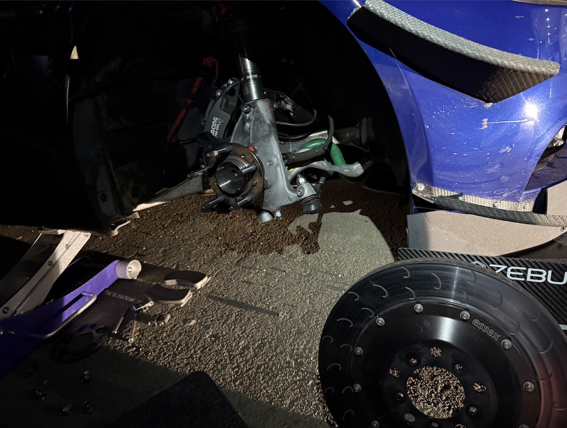

On Friday evening, while putting on my good Pirelli DH tires for Saturday, I discovered something was loose in the front passenger-side wheel assembly. When you grabbed the wheel, there was play and a clunking sound. Initially, I thought it was the hub. I thought, that's fine---I have spare hubs. So, I removed the caliper and rotor, annnnnnd it wasn't the hub. Before removing the rotor and caliper, I had grabbed a couple control arms to see if anything was loose, but nothing felt loose on those first attempts. What I think was going on was that the rotor and caliper were heavy enough to make it impossible to feel the clunk while they were attached. Once they were off, and I realized it wasn't the hub, I started grabbing the control arms again, and one of them was clunking. The bolt on the subframe was not tight. It wasn't loose, but it wasn't tightened to spec. Once I tightened it, the clunk and play were gone. Phew.
This was the scene Friday night. But I'm glad to say that I still made it to dinner with Charles from SDC and a few other guys at the BBQ joint!

The question is: why do these keep going bad so quickly? I think this might be the 4th set of bearings going on the rear hubs…..the original bearings and hubs lasted 9 years. And they were still fine when we replaced them. It was just done out of caution/maintenance.
For now, I’m just going to replace the bearings and, if needed, the hubs. If they go bad again quickly, I guess I may have to look at replacing the wheel carriers/uprights. Perhaps the hole that the bearing presses into is not perfectly round anymore? I dunno…..this is a weird one.
I checked with Bimmerworld and Turner to see if anyone makes an upgraded bearing for motorsport for the E9x M3 platform. No one knew of any. They do make an upgraded bearing for the F chassis.
