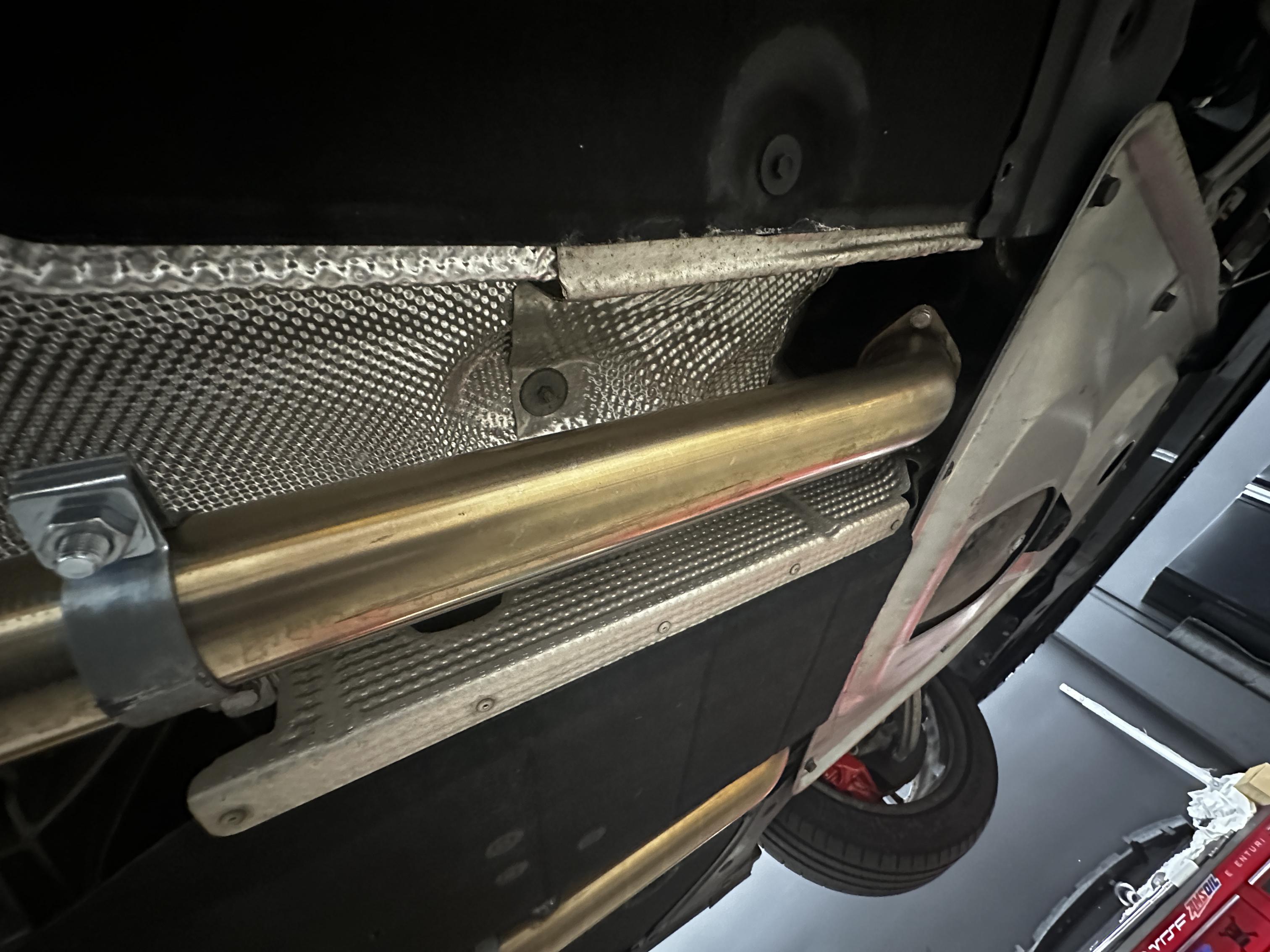

Previous owner of my car installed turn down cutouts and vacuum actuated valves tapped into the brake booster. Not my favorite configuration but I’ve managed to live with it for now. I’m considering putting the solenoid on a relayed circuit but I’m garbage at electronics.
valves open
pulling away
Hwy 20 tunnel
I’m also considering going back to a more stock config sans valves. But I’ll probably wait for them to break before I do that. You will hurt feelings with those valves open.
