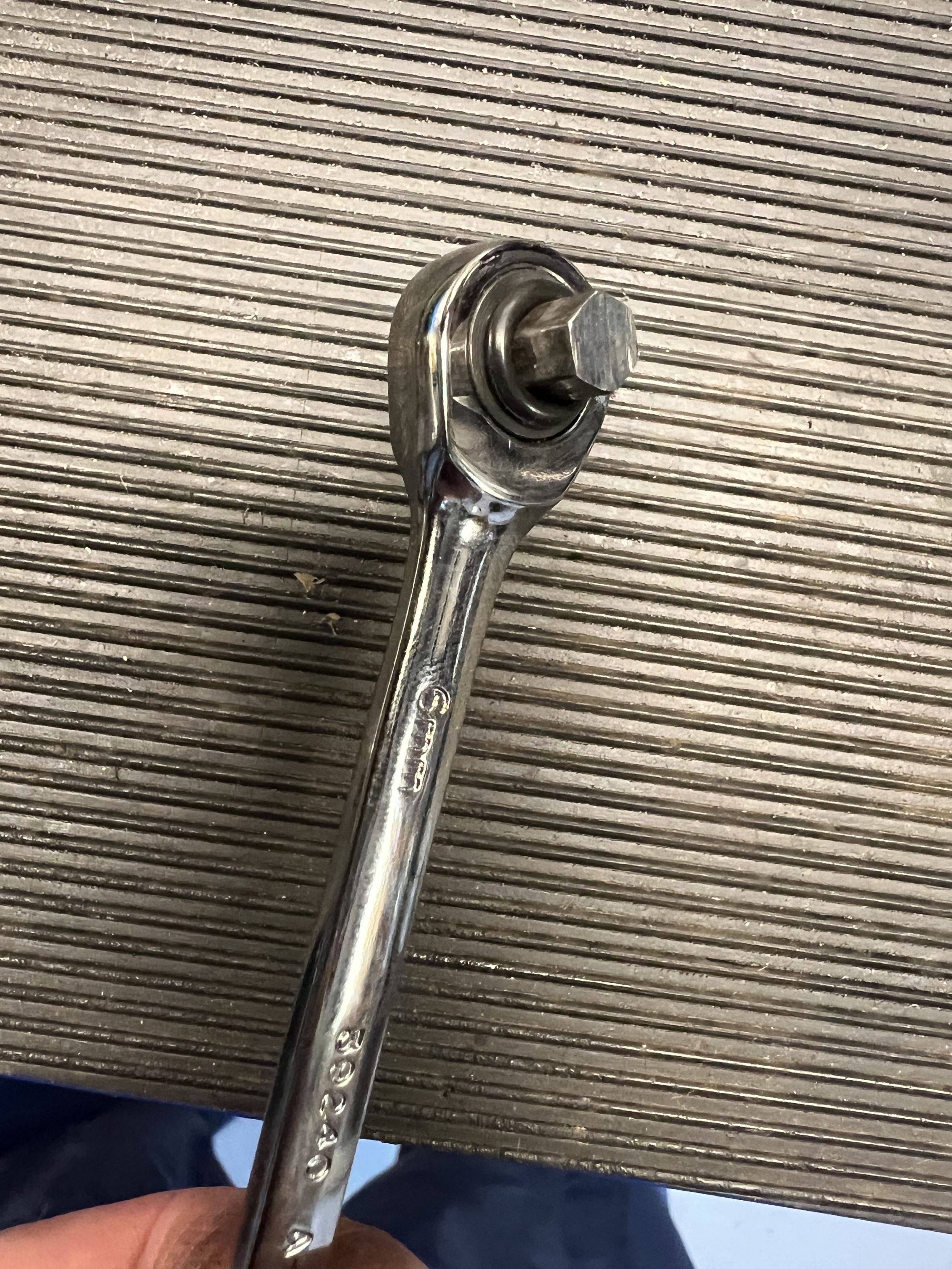

Replacing the rear sway bar bushing?
For anyone that is trying to replace the rear swaybar bushing, it is almost impossible to access the 6mm socket cap screws holding it on. I ended up making a tool from a 6mm box end wratchet and a cut piece of 6mm hex wrench. I used some orings to hold the cut piece in place.
