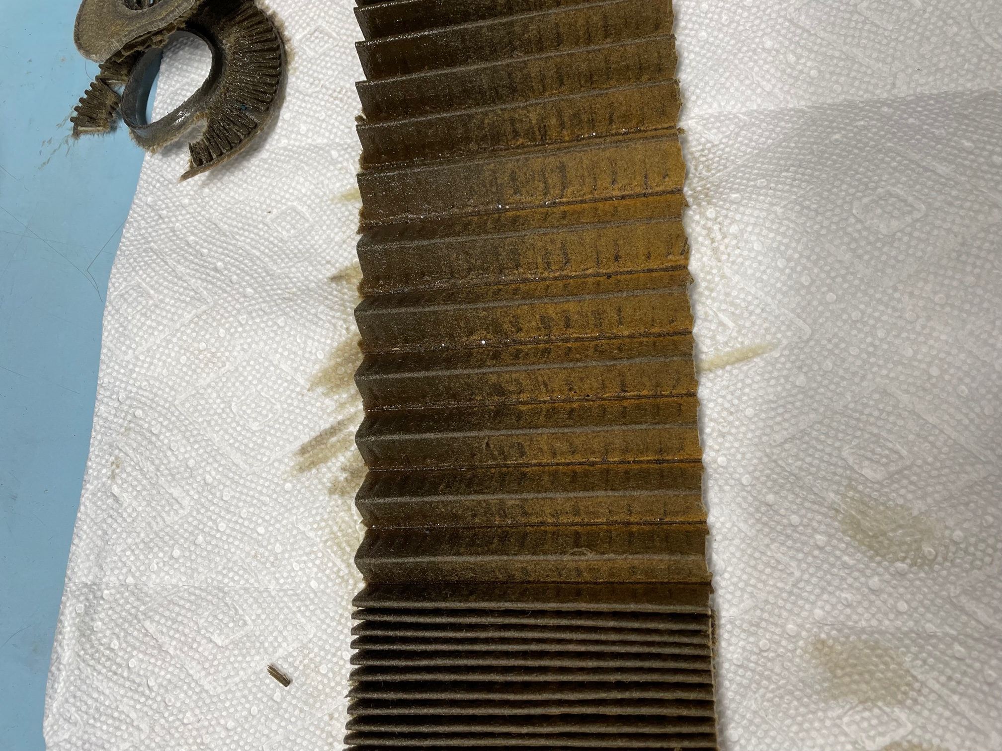

Hey everyone. I S65 swapped a 1 series last winter and when I did I did rod bearings. 52k miles engine, peace of mind. Then a couple weeks ago, with about 800 miles on them blew an oil cooler line on track. I got it stopped and shut off pretty quick but when I went to fix the cooler line there was very little oil left in the engine, maybe 1-1.5L. I decided to cut open the oil filter for kicks and saw some sparkles, not that bad but enough to worry me:
There were no sparkles in the oil, or in the pan. I did notice a few similar looking specks here and there around the inside of the oil pan gasket... makes it super easy to see them since it's black. I assume there are more floating around.

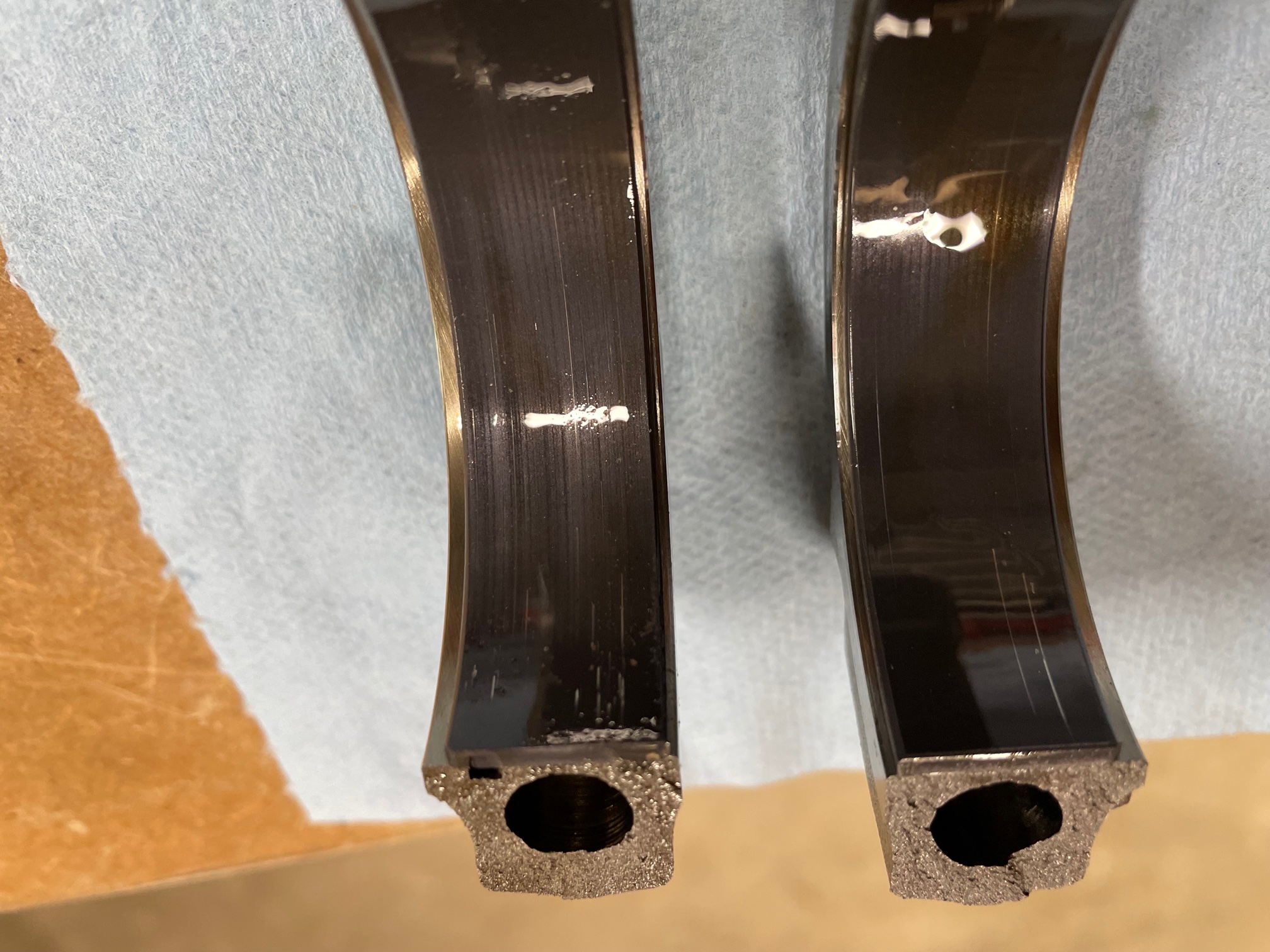

So I figured the worst... rod bearings shot, welded to the crank, motor shot. So I tore the whole thing apart again to see the damage and... there was none. Very slight scoring in the bearings that I can't even feel with a finger nail but other than that they look like brand new BE bearings:
Some scoring near the edge:

  1. Do the bearings look good? Worried about the minor scoring?
  1. Does the "sticky" bearing look ok? Obviously it didn't spin but I'm not sure why it would be black like that. Maybe this one is the source of my metal?
  1. Is it kosher to just reinstall the same bearings?

  1. Any other ideas where the metal came from? This is the first filter after fitting a new oil cooler, maybe it's that?

Yes that's the conventional wisdom but what are they going to tell me that's better than actually looking at the bearing? There will not be bearing material in the sample, the bearings look mostly perfect.

I think you're fine; throw some oil in it and run it. To be sure, you can plastigauge the journals.

I had some flakes in my filter after that changed my bearings too. Freaked me out. Sent a sample away and it was totally fine.
That was 35,000KM ago. Every oil change since has been totally fine. Have tested the oil once more and it was good. Not sure where the swarf came from but it is gone now.
Put it back together and try again. Your bearings look fine to me. Perhaps @Green-Eggs can offer some insight.
