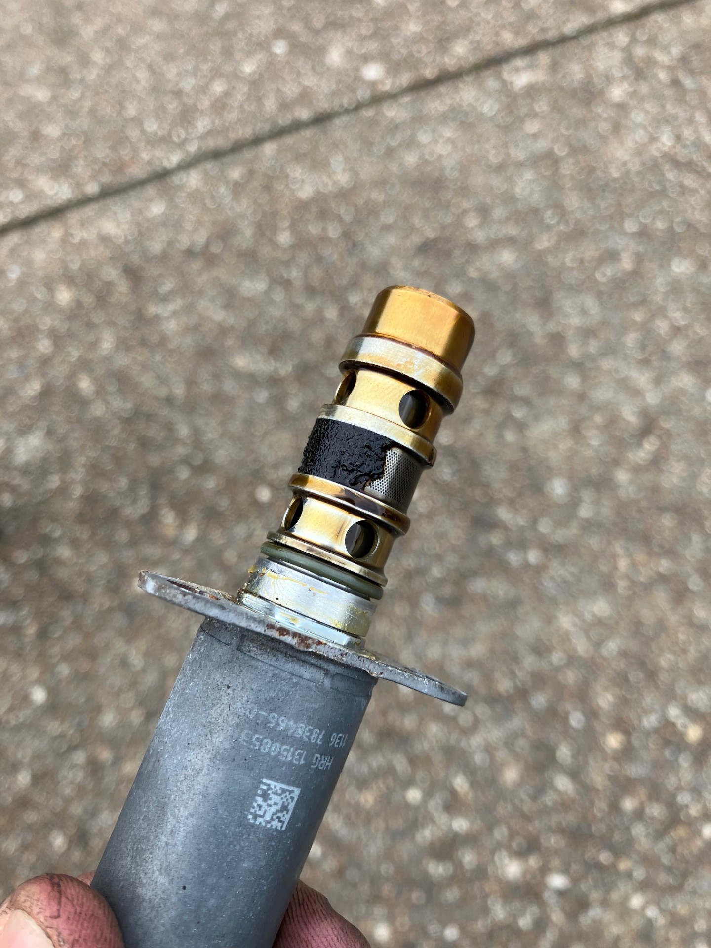

Had already taken all 4 vanos solenoids out and cleaned them.
Although the code was for the exhaust of bank 1, both exhaust solenoids were fairly clean however both intake solenoids were half clogged with debris (picture of 1 below, both were the same). Name:  thumbnail_IMG_0070.jpg
I'm having the rod bearings changed next week, will put some liqui moly in before the oil + filter are changed to see if the code is due to dirty oil. Although the car has had oil services regularly throughout its life and looking down the oil filler cap looks clean enough.
Due to the code coming up so intermittently I assumed (never assume) that it wouldn't be a solenoid fault as surely the fault would return every time I drive but I've realised this isn't based on any actual knowledge so, I'll switch the exhaust solenoids over and see if the code changes side if/when it next pops up.

The vanos system can only tolerate so much delta between variators before it complains. I’ve seen as much difference as one reporting 3 degrees different than the others yet no warning. That solenoid looks terrible, glad the filter mesh seems to be doing something.
Although the code was for the exhaust of bank 1, both exhaust solenoids were fairly clean however both intake solenoids were half clogged with debris (picture of 1 below, both were the same). Attachment 3639465
Harry
OP, thanks for posting that picture.
I think that's very indicative of the maintenance of that vehicle. Don't get spammy started on the oil change intervals recommended on these cars. Even tho there is that screen mesh there to help prevent debris flowing through the solenoid, that doesn't mean it prevented everything from damaging the solenoid bore and such.
Changing the oil to some magical brand won't fix a solenoid with excess leakage or excess flow when material is no longer there.
These engines also have similar VANOS systems to the N5X platform in that the sealing ring that rides the camshaft could also have the potential to wear into the housing causing excess leakage. The fix BMW did for this was add a teflon sealing ring instead of the metal ring, but only did this for the N5X platforms during that time. Also, this tended to happen more on the hydro-formed camshafts vs the cast camshafts in the N5X platform in my experience.
Denoted as item #3 as the rectanring.
https://realoem.com/bmw/enUS/showpar...diagId=11_4124
