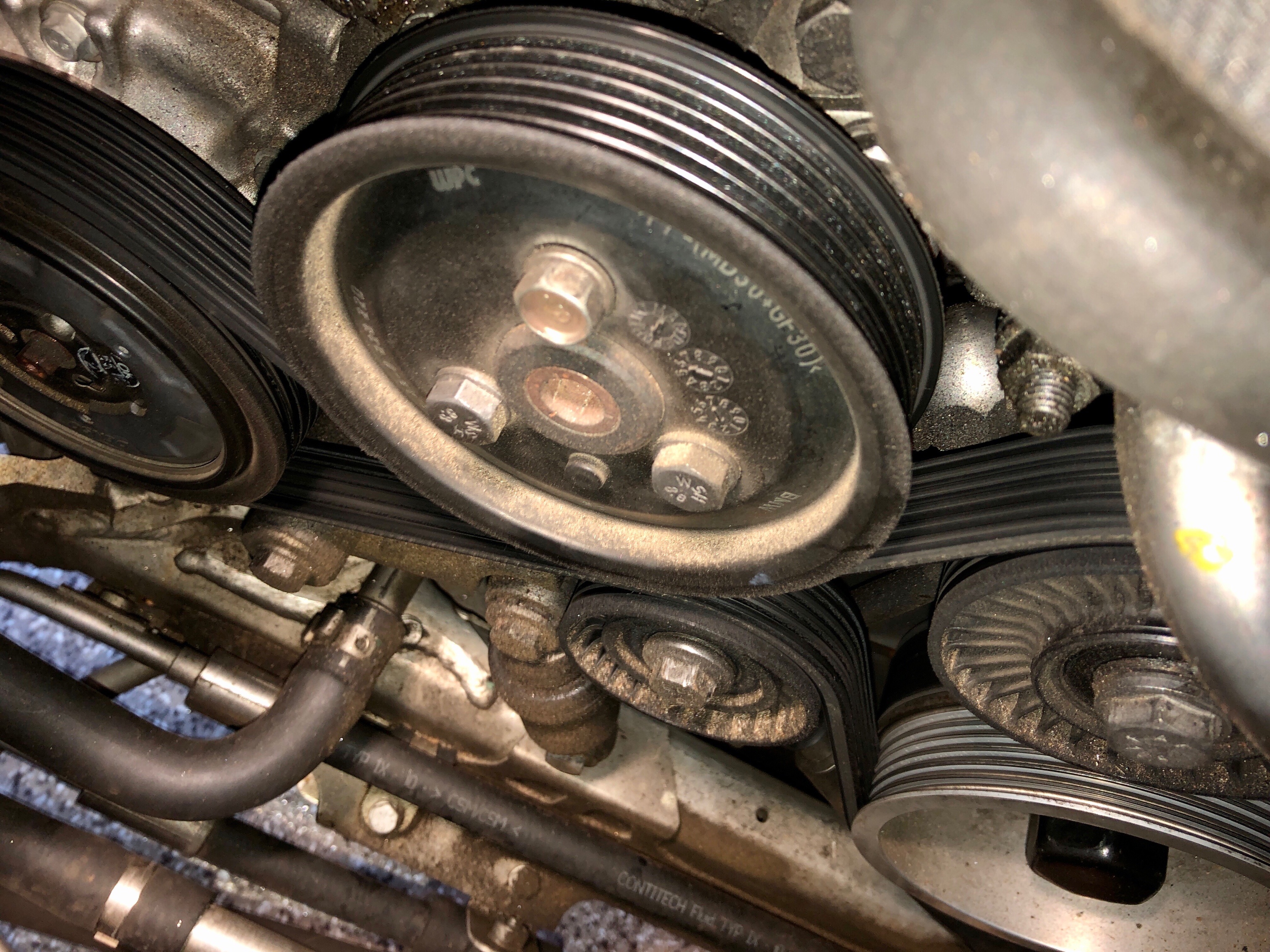

i removed the AC and swapped my 2011 pump for a pre-09 one, and ... now have no power steering. no bad noises, no groaning, no nothing. i followed the bleeding procedure (disconnected return hose, drained all the REAL gross fluid until clean pentosin started coming through, and then connected it back up).
i can only think of two things:
- the pump i got was bad. possible, but not sure how to test that short of buying another one
- long shot, and hope this isn't it, but i also installed the BW ps reservoir, and in doing some digging i found a post that someone lost their PS rack after installing it. something about the reservoir possibly having leftover metal shavings from manufacturing that it blew up their rack. i did also install a filter, but it's in the return line so if there *was* glitter in there, it would've gone through the system before being filtered out.
idears?
here's how it's plumbed in right now:
i didn't see any leaks, especially ones bad enough to impact the hydraulic system.

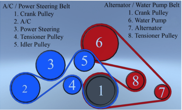

The pre-mid-2008 pump is designed to run in a clockwise direction whereas the post-mid-2008 pumps run counterclockwise. This is the reason the pre-mid-2008 E9X M3s A/C+Power Steering serpentine belts follow a different route path. Post-mid-2008 pumps use the route shown in blue on the image below.

The pre-09 pump is designed to run in a clockwise direction whereas the post-09 pumps run counterclockwise. This is the reason the 2007-2009 E9X M3s A/C+Power Steering serpentine belts follow a different route path. Pre-09 pumps use the route shown in blue on the image below.
Correct, which is why when removing the AC you end up needing to switch to a clockwise pump as you lose the AC pulley.

Oh and that’s the post ‘09 layout. Crank turns clockwise, loop runs clockwise, ps pump is on the outside of the loop and gets turned counter clockwise. Pre 09 the loop goes around the ps pump pulley, not below it.
How strange. Mine is a 2008 and the belt routes below the pump just as shown in the image I posted above (#3) and here below.
been doing more digging on this, the production switch over date is 5/15/08. if yours is a later build date it could still be an 08 but have the ccw pump.
Great sleuthing, and this makes much more sense now. Mine is July 2008 build date from what I recall. Hence, I updated my post #2 above. Thank you.
