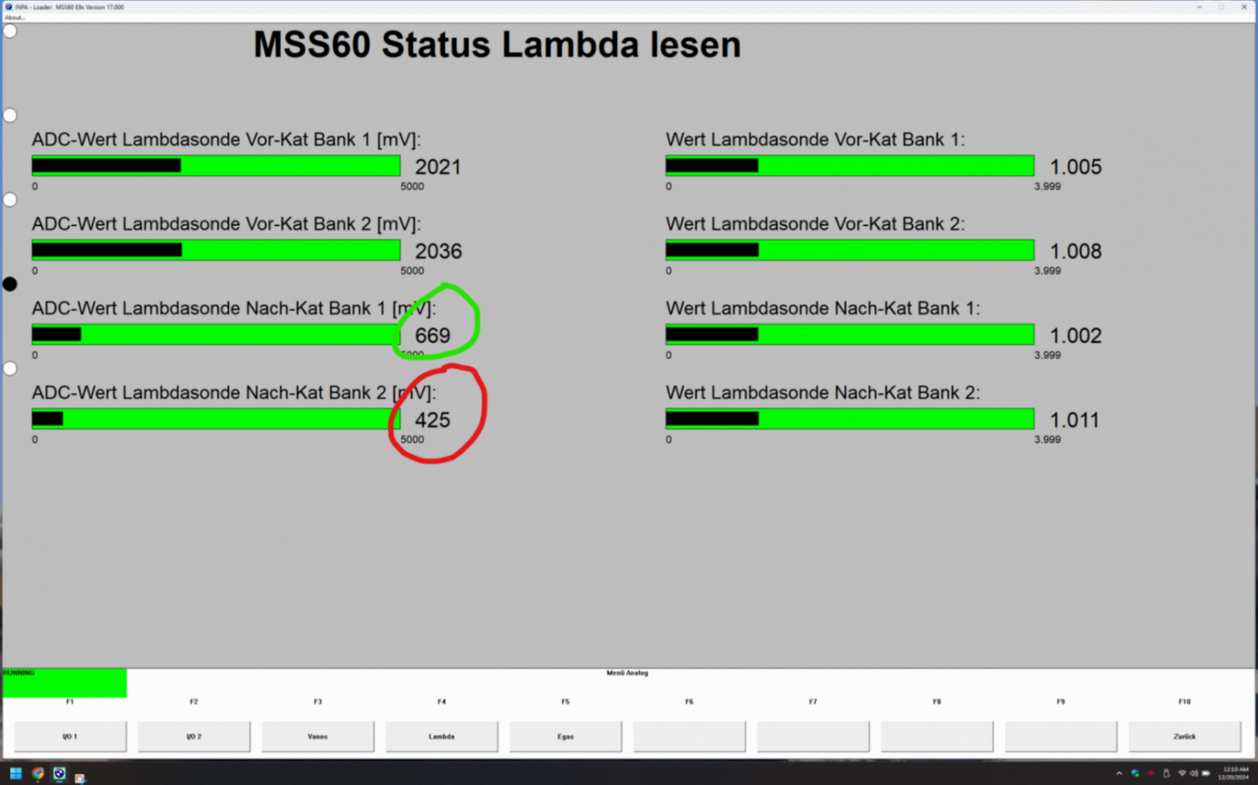

I think it’s my bank 2 cat. Both cats have an inlet temp around >300 degrees. The bank 1 sides outlet is around >360. Bank 2 outlet is >315. This may be expensive to rectify with X-pipes costing greater than 7k.

Got the flu and have been down this last week. I finally got to dig back into this issue. I followed the diagram RocketyMan provided and started at the ECU with my meter. I pulled the plug that connects the O2 after cat wiring to ECU. So on pin #5(white) I get 12-14vdc which is bank 1 after cat O2. On pin #6(white/purple) I get nothing which is my bank 2 after cat sensor. This confirms a wire problem. Not sure how I’m going to resolve this. I’ll probably have to bite the bullet and take the car to my dealer. I have no means of dropping the motor and front subframe to access this wire on top of the trans. Bummer!
Thanks, Scrippy, for reporting back and posting a picture of x6200.
Couple of Q's:
1. How are you measuring the voltage? Are you back-probing with x6200 plugged in?
2. Did you try clearing the code to see if supply voltage would return?
These are FET controlled--meaning the DME can turn that circuit off.
3. Did you try testing continuity on pin 5 right to the O2 connector?
This would be a good double-check scenario.
4. Did you also try investigating the DME connector, X60105?
Does x6200 have continuity to the DME connector? 6 to 44?
2008 BMW M3 E93 MT, 3.15 FDR

1-I measured that voltage with the connector unolugged. I put positive lead on 5 and negative lead in engine bay ground. #5 gives the 12-14VDC. #6 gives nothing.
2-I did try clearing error with ISTA but it still shows existent.
3-Did not run continuity from connector to O2. I will get the car up and try that soon.
4-I did not do anything from connector to ECU. All does look good however when I unplug the connector. No corrosion or bent pins.
Got any ideas other than continuity check from plug at ECU to O2 plug?

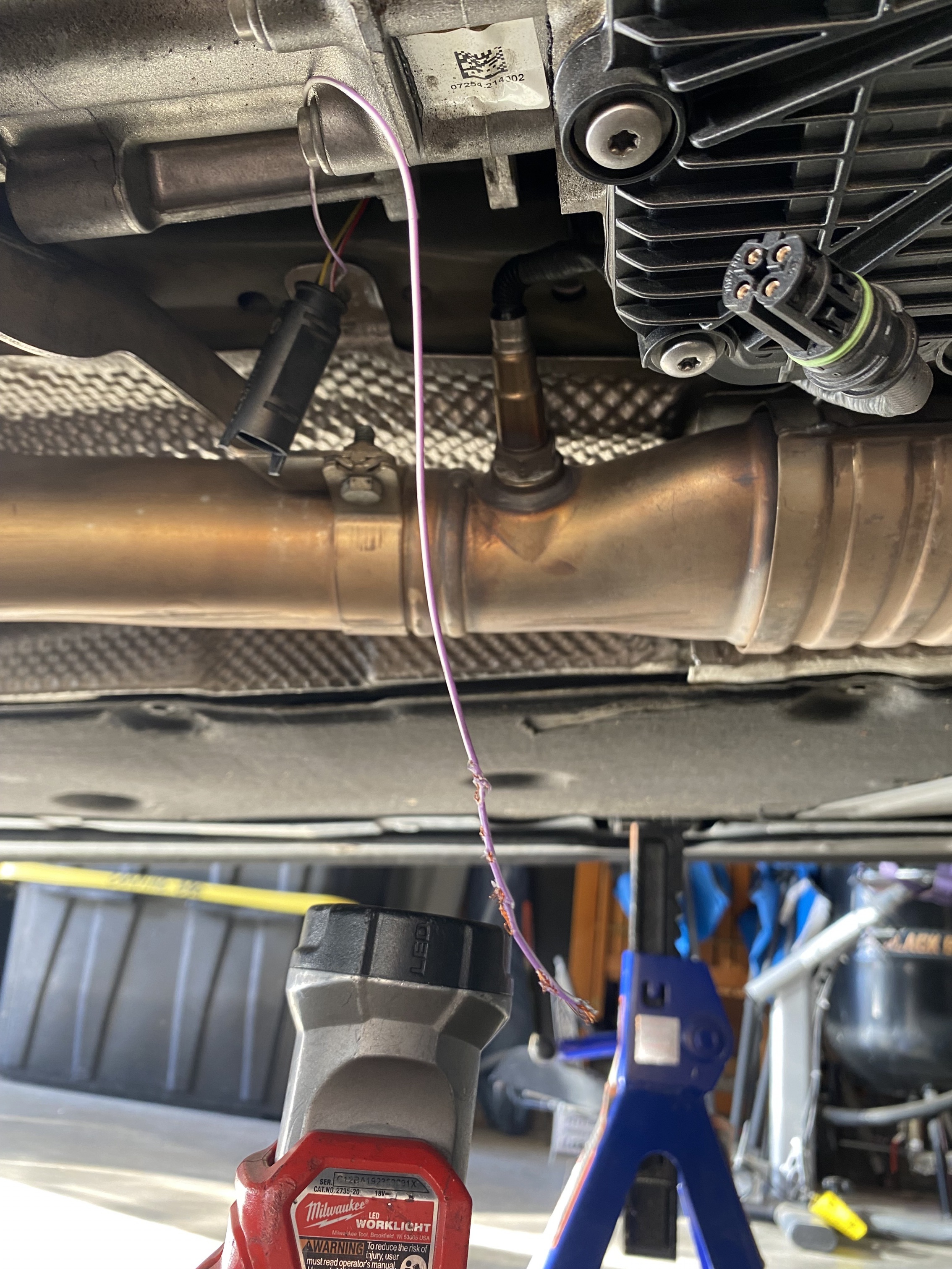

So good to know the issue but sucks that the motor and trans will have to come down to fix it properly. For now I will run a temp wire to get back the sensor functionality but it was in fact that white/purple. That was the wire I was not getting my 12vdc on a few posts back. It’s all chewed up. While doing a continuity test from ECU to the O2 plug, I did not get cont on that white purple so I pulled it and about 9” came out all chewed up.

Ran a temp wire to replace the broken wire. Cleared error and all good now. Does anyone know if I can gain access to the wire harness by removing the center counsel or anything like that?

Thanks for reporting back with a picture! Confirms where the problem was exactly. But very interesting how the wire was damaged. I would be curious if that wire wasn't the only one. Maybe you can share some insight in that?
As for your Q, the center console will not gain access to this area as this would be a very tight squeeze. The front O2 sensors run down towards the rear-right of the engine. I'm not sure the exact route of the rear O2 sensors.

So I did get a view of the damage with my scope. The plastic loom is bashed up. I presume this happened the last time my dealership took the motor and trans out and the wire finally vibrated apart. I recon they banged shit around putting the car back together and pitched the wire on the trans tunnel. The dealership is the only shop I use when I can’t do myself. I was chasing a vibration on hard acceleration that ended up being my constant velocity joint. They threw a harmonic balancer, dual mass flywheel and other goodies at it which required tranny out. None of it fixed the vibration until I made them look at the driveshaft and nothing else. All reasons why I cringe thinking about them doing work for me. I’m being quoted $4700 just to get trans out for me to fix the wiring myself and then have them put it back. I may just attempt to lower trans myself at this point.
