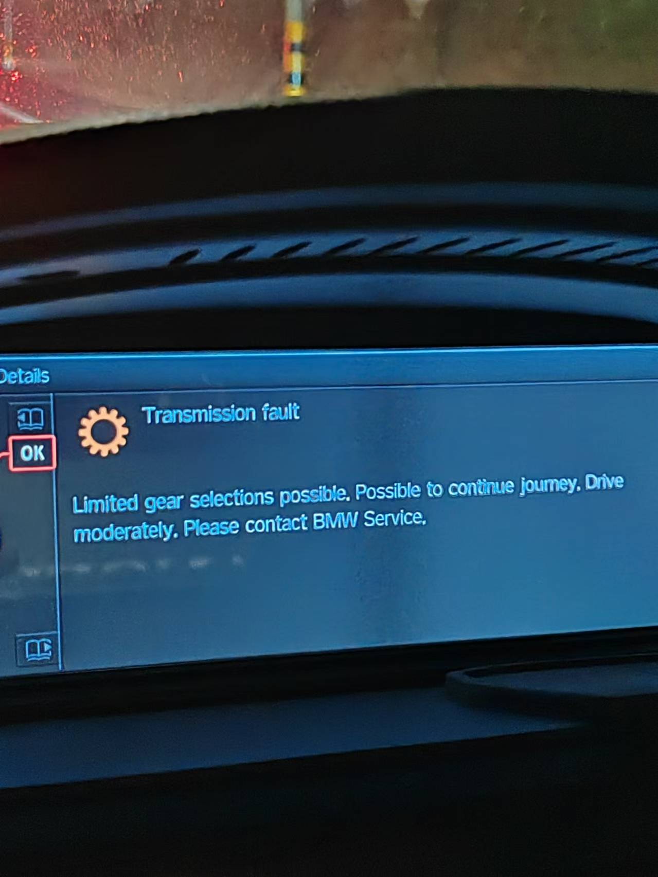

Welcome to the club ... of mechatronics failures
Symptoms are similar- been driving normally, and a few more aggressive shifts would trigger the transmission error code, and odd/even # of gears would be gone. In my case I lost reverse too.
Either you'd have to swap for a new/used transmission or at least replace the mechatronics.
Some evidence I've found:
Mechatronic Problem
If you read the codes, you may get fault codes related to the valve body also known as the BMW mechatronic. BMW ZF mechatronic are notorious for problems with 2 to 1 st gear downshift or shift flare during the upshift. These harsh upshifts and downshifts are often due to a TTC clutch failure, overheating, damaged solenoid, worn solenoid springs and other problems with the mechatronic unit.
If you checked everything above but are still having problems with your BMW transmission the cause most likely is the mechatronic unit. If you are looking to save money, you can consider replacing only the solenoids in the mechatronics unit/valve body. If you decide to replace the solenoids yourself, remember to change the foam strip that goes between the solenoid terminals and connectors.
https://www.youcanic.com/bmw-transmission-problems/
Indy shop said its the Mechatronic Unit. Which comes to a total of 8k parts and labor haha ooph.
So from my research, it seems best just to replace the whole transmission right? because I've read where people in the same spot as me, replace the Mechatronic, and still the problem persisted.

Starboy - hesitantly, I want to say it should not cost $8k - not sure if this is USD or RMB (looking at your location). Even at a fairly expensive local shop (because of labor rates in my area lol) I paid around $7k for my fix (add $2400 + tax for the used DCT I got). For me, the math did not make sense to try and repair my transmission rather than to just replace it with an used unit based on labor costs.
These were the codes I had at the time my mechatronics failed (5A62 and 5A63, for any future people searching):

Oh sorry the $8k was from Saint_M3 when he mentioned he's got a quote from his local indy shop for the Mechatronic unit, presumably in the Washington area back in 2022.
Asked my dealership for parts and they gave me crazy numbers like:
$6.8k for a new mechatronic unit
$22k for a new DCT trans
$0.6k for labor (lol)
But if I go for a used transmission (including mechatronic) it'll cost $2k with labor, so it really doesn't make sense to repair, should just go for a used one.
For records, I lost rod 5/7, error code: 5A6D
