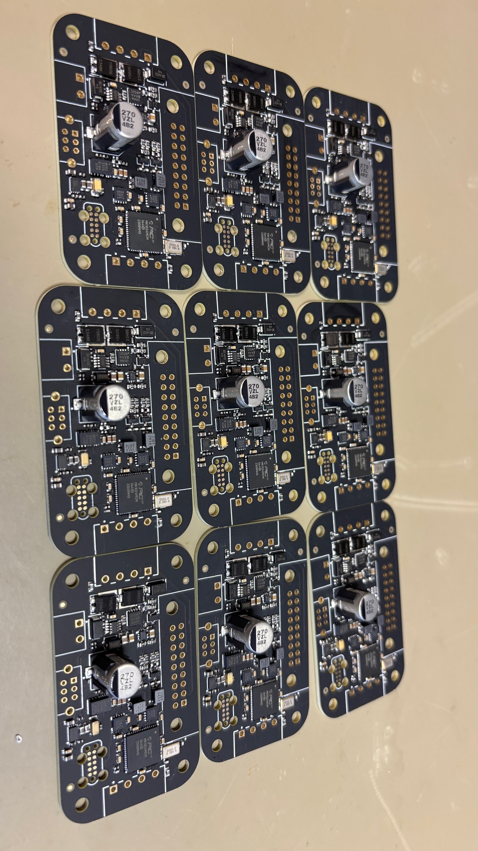

Got the first batch wrapped up. I have OEM matched wire coming in Monday or Tuesday to make the pig-tail and then I can ship out the pre-orders. I'll be in touch via PM to give everyone payment info. (Shopify store coming soon)
Boards with just the SMT assembly done (how I buy them)
Adding the through-hole components, done in-house:
Size:  377.3 KBName:  thumbnail_IMG_1122.jpg

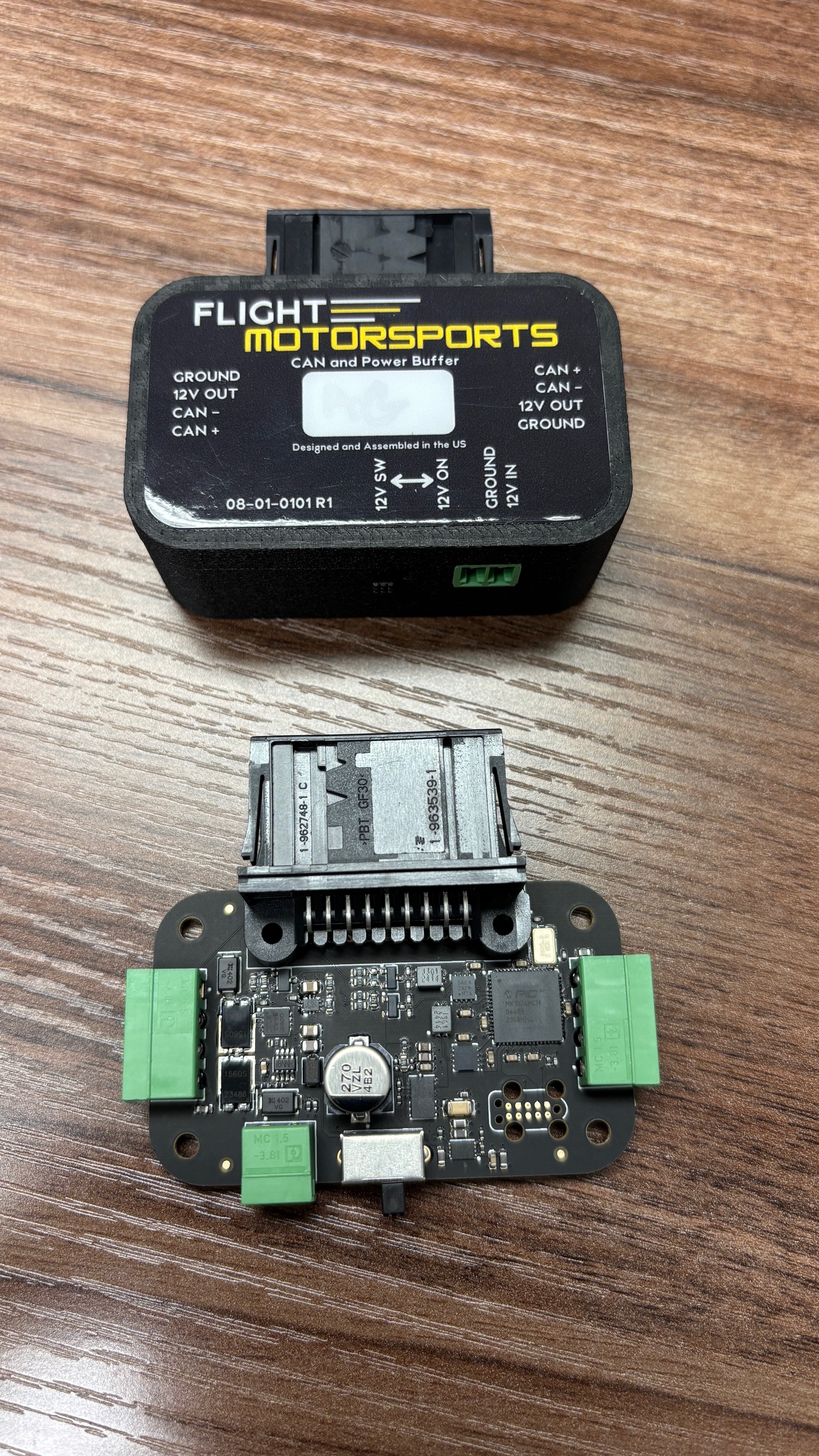

Testing:

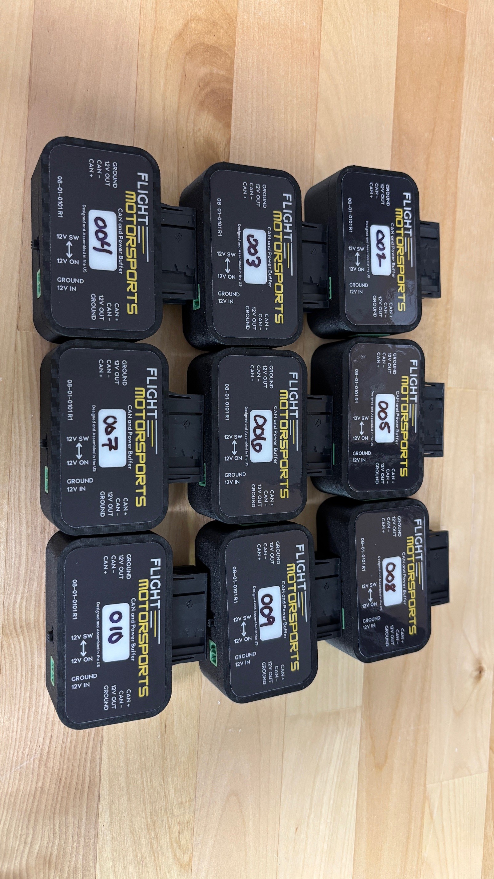

Assembly and Labeling:
Size:  497.0 KBName:  thumbnail_IMG_1132.jpg

Wire in, cut stripped, and terminated. Last things missing is the packaging, which will be in tomorrow, and install doc that I'm hoping to get done tonight.
This is how the unit will be sent:

Got some time to create the installation guide. Let me know if this makes sense or if something isn't clear and I'll update it.
Units going out today to those who paid!
CAN and Power isolator installation.pdf
I'm also not totally sure about the JBBF87 vs JBBF70. According to TIS either was valid but neither of them look exactly what's in my car.
