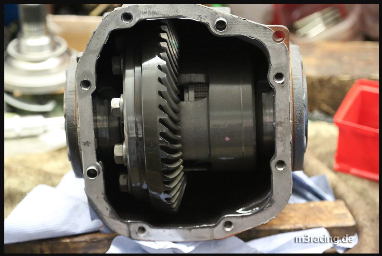

The clunk sound in the video is primarily the sound of the backlash between the ring and pinion gears being taken up when on and off throttle. The backlash increases with wear but is initially set when the Diff is assembled with a dial gage. If it's set incorrectly then overtime the gears wear and by around 50K miles many BMW's have worn diffs with the clunk. Search the forums using the Advanced Search page with keywords "Diff Clunk" for the thread title. Additionally, the OEM E9X M3 Diff uses the Visco-Lok Limited Slip mechanism which is also prone to wear. As tdott mentioned and linked, kits exist to repair the Visco-Lok clucthes.
The backlash between the ring and pinion can be adjusted by a competent shop. The key is knowing what value the set it too. driftflo is your man for all things BMW Diff related but he's in Germany. See his thread for more information:
https://www.m3post.com/forums/showthread.php?t=788992
More on OEM Visco-Lok:
https://www.m3post.com/forums/showthread.php?t=1404054
https://www.n54tech.com/forums/showthread.php?t=36093
https://www.m3racing.de/sperre.html
Example of ring gear teeth
