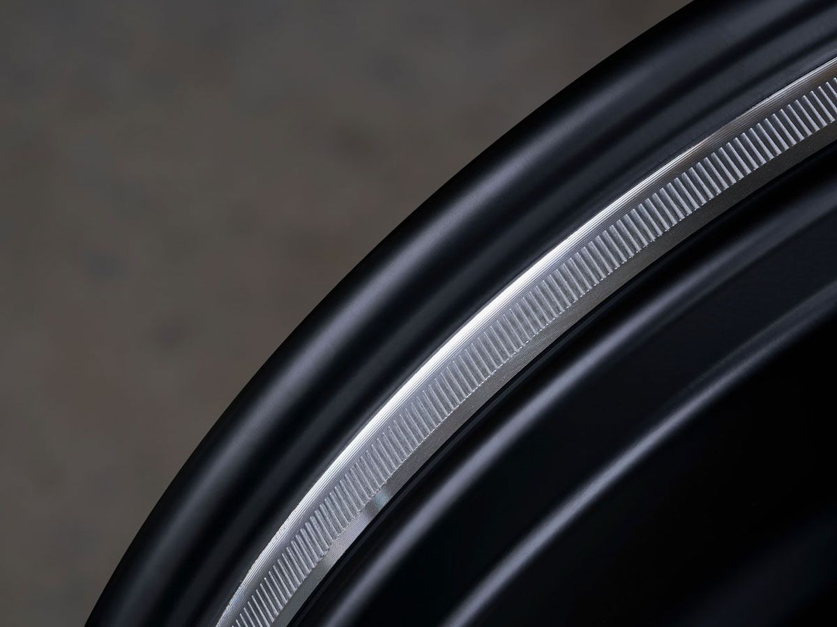

DTC80 can easily exceed the grip from street tires causing the tires to rotate on the rim and cause excessive ABS use. It’ll overpower stock suspension setups in the braking zone and trail-bracking into a corner. My guess is the OP is over-using the brake system which results in really high brake pad-rotor temps. Late braking and getting off the brake pedal sooner is easier on the brake pads and rotors. Stepping up to the f8x blue brake setup is a nice step up in performance for a reasonable price (especially if adding RB steel domed pistons and placing titanium shims between caliper and pad). It’ll be a while before you outgrow this brake setup.
Running fully spherical/geo corrected setup on 200tw’s (700lb f, 1000lb r springs), going to dip my toes into slicks later this season.

DTC80 can easily exceed the grip from street tires causing the tires to rotate on the rim...
Uh, no. A lot of people claim that happens so for science we chalked a ton of different cars at Watkins Glen and not a single one moved a millimeter. Street tires, slicks, OEM wheels, aftermarket wheels, didn't matter. Tires do not rotate on the rim.
This also would have nothing to do with what the pad was, the limiting factor is the friction between the tire and pavement, not the pad and rotor.
Yes it can and that’s why knurled beads are applied where the tire bead is located. You clearly are nut pushing hard enough because it’s been a common occurrence over the 35+ years of tracking.
Again not true. The max torque occurs early in the braking event which overcomes the tires ability to resist the applied torque. Ask any wheel maker that adds knurled beads to the wheels, what’s their purpose.
My tires spin on my wheels every single track day. I make a vertical white paint mark exactly in line with the valve stem before every track day, and they all move. Interestingly enough, the rears always move substantially more than the fronts.
In this picture, you can see my white paint mark in the 7 to 8 o'clock position that originally started exactly in line with the valve stem at the 3 o'clock position. This is on DTC60 front and rear OEM brakes, first gen RE71r 275mm square setup with DSC off.

Originally Posted by M3MATT View Post
I think that’s what he’s talking about, the amount of friction on the pad/rotor is much higher than the tire/ground. So it makes the brakes “too strong”. I.e. ABS goes crazy and you have little modulation
Correct. Pads with a CoF from 0.55-0.65 produce a much higher instantaneous torque that far exceeds the tire-rim capability. I’ve found tires rotating for three decades. Current high end brake compounds have a much higher CoF than pads from 30 years ago.
are your wheels powder coated or factory coated? I don't think Volks have the Paintless Knurled Bead like the Apex forged wheels have.
I haven't had this issue with more aggressive pads and tires than you run.
Properly knurled wheels create a huge number of “teeth” biting into the tire bead and eliminates the rotating tire issue.
My Volks are the Dash White OEM original finish (not aftermarket coating). Sadly they do not have knurled beads. However tire imbalance has never been a real issue for me and I melt the wheel weights off at least one tire each time anyway, so I either let ride till the tire is dead or I just throw it back on the balancer.
Volks introduce the knurl bead into the TE37 Ultra onward in most of their new releases now.
for what it's worth TE37 started in 1996, the SL was introduced in 2010, The Ultra somewhere in 2016? and the SAGA 2021..
