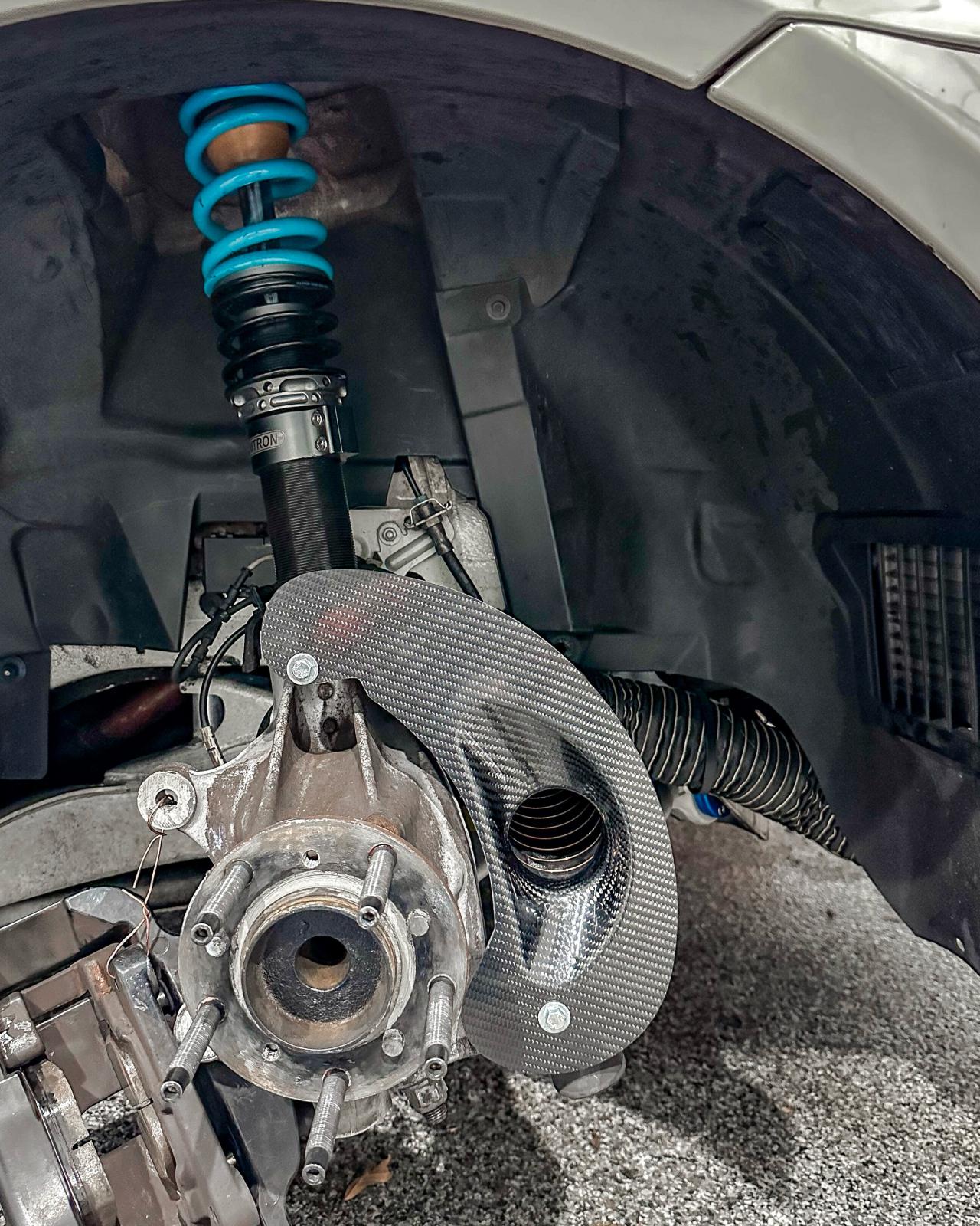

i just installed Burkhart Engineering carbon brake cooling plates and 63 mm hoses to a gt4 lip. Went together very well. The hole in the carbon cooling plate is centered half way between the rotor center hat and inner rotor face, but seems like air would want to move back toward the center hat when the car is at speed.
Does it work? I have no idea yet, but we will find out Dec 1 at Road Atlanta.
sexy. how does carbon do in high-heat applications?
CF can withstand high temps. The limiting factor is really the resin used and how the parts were cured. You can raise the glass transition temp with a post-cure elevated temp cure.
