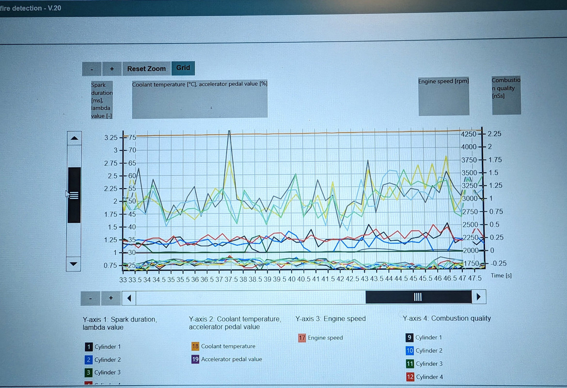

ISTA misfire detection chart from cold start, screencapture:
Bank 1 (Cyl 1-4) combustion quality is consistently lower than Bank 2. Bank 1 is bearly above 0, and Bank 2 is closer to 1. Bank 1 has random misfires, you'll see a certin points above cyl 1, 2, 3 go to 0. But all 1-4 have misfires at certain points.

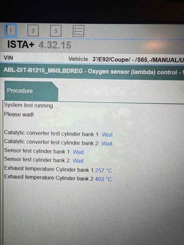

I noticed a difference in exhaust temps after I had held the rpms around 2500 until it warmed up.
The o2 sensor test won't complete because of this.

I tried to run the o2 sensor test in ISTA but because it detects the egt on each side being different, it doesn't start the test as shown in the above screenshot.
