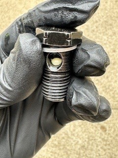

it was a freaking banjo bolt!!!
RocketyMan, i owe you a drink!
pictures of the failed banjo bolt.
the ball should not stick out that much...

      10-19-2023, 02:05 PM   #12
RocketyMan
RocketyMan's Avatar
772
883
Drives: E53 X5, E83 X3, E93 M3
Join Date: Nov 2022
Location: PNW
2008 BMW M3 E93  [10.00]
Awesome!! Thanks so much for reporting back with pictures. This is very helpful for anyone perhaps experiencing the same problem.

      10-19-2023, 02:14 PM   #13
Audioslave686
Audioslave686's Avatar
177
127
Drives: M3 E90/X4 F26
Join Date: Dec 2016
Location: Columbus, OH
yup, cause no way i would catch that without comparing to the good banjo bolt side by side
Attachment 3303075
Attachment 3303076
Dam...that's the second one I've seen this month. I saw one on an E46 M3. Glad you got it fixed. I'm pretty sure this was causing a couple of other people headaches too.
