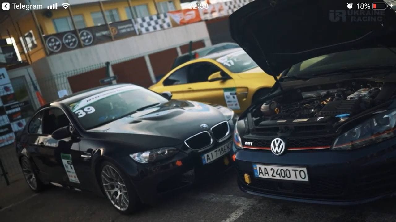

I finally have already found the topic I needed on this forum))
Will use ps4s 4 times a year on track days, thanks for useful info, I will give feedback, or ask some questions.

4 track days with ps4s 255/275 zcp stock setup camder Front-1,4 Rear -1,8 , condition is still good, but not so much grip as Federal RS-RR. Overall distance at this tires near 2000 miles. testing continue...
