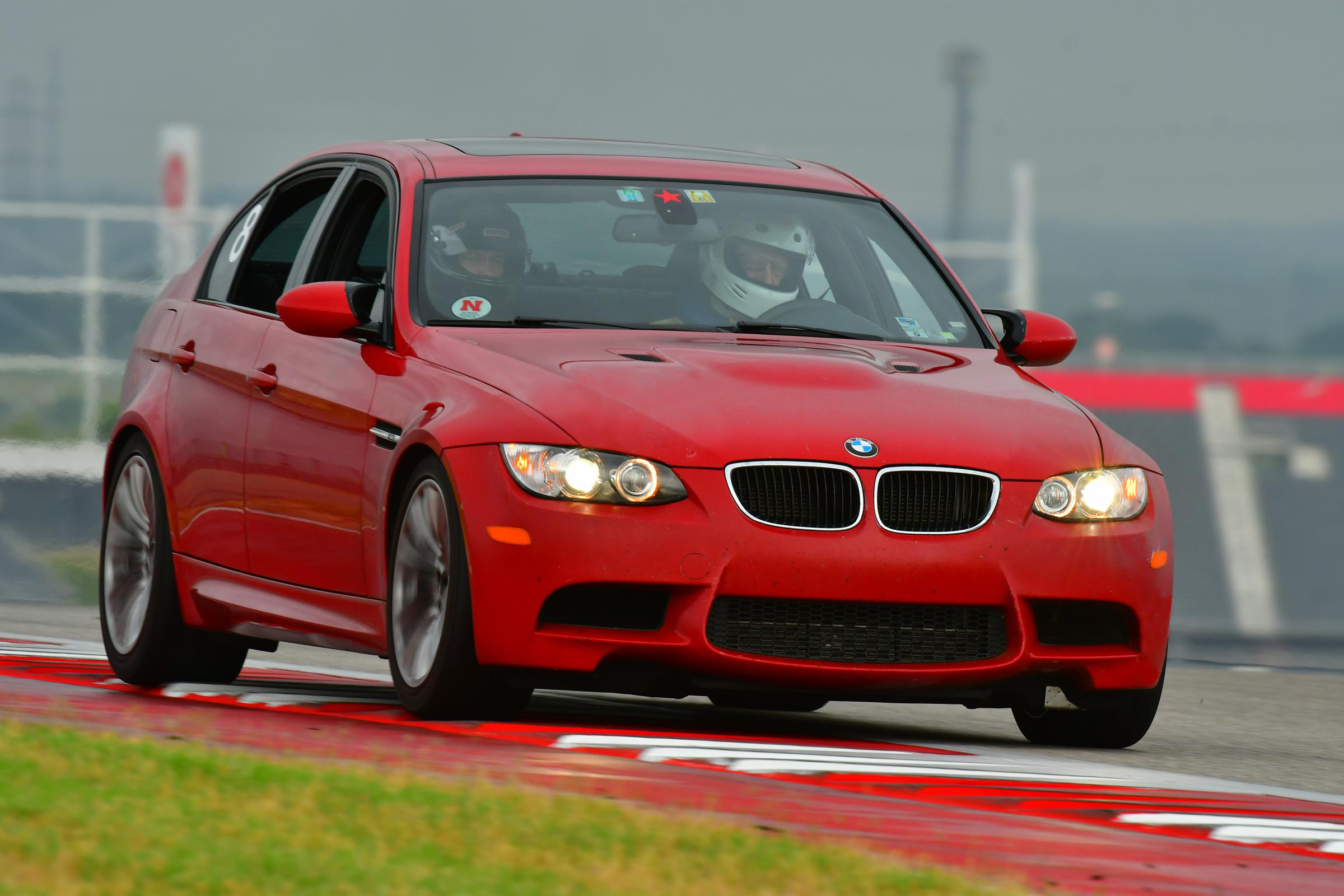

All this talk about COTA brings back fond memories. Took someone else's student for a ride (always risky) in mixed conditions. He dropped 2 seconds off his personal best next session.
Kinda wish I didn't have the paint protection goop on the car as this picture at the exit of turn 9 is money.
Goop? I don't see any goop. And I don't see any cracks in the bumper on the driver side either!
Those cracks were a monster buck rabbit playing frogger on I-10 between Palm Desert and the Chuckwalla exit. The rabbit and I both lost. He lost more.
