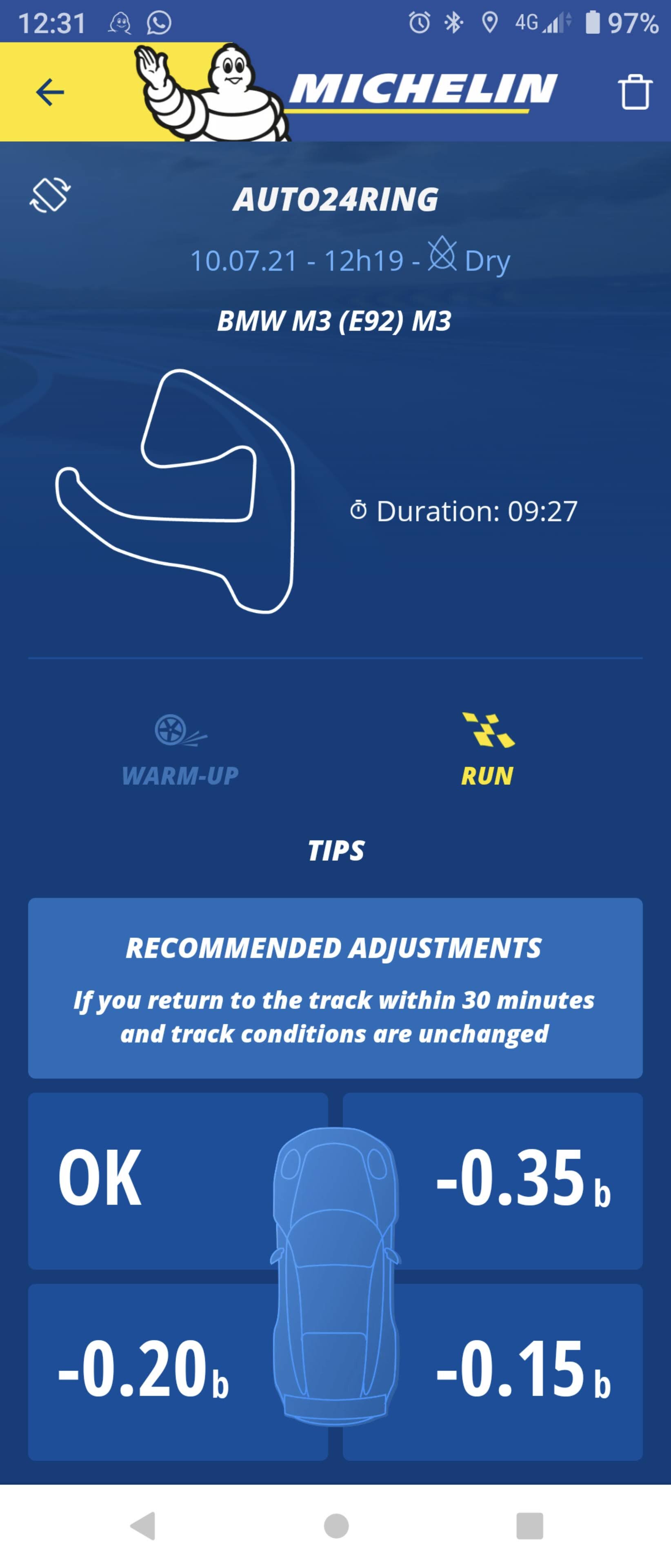

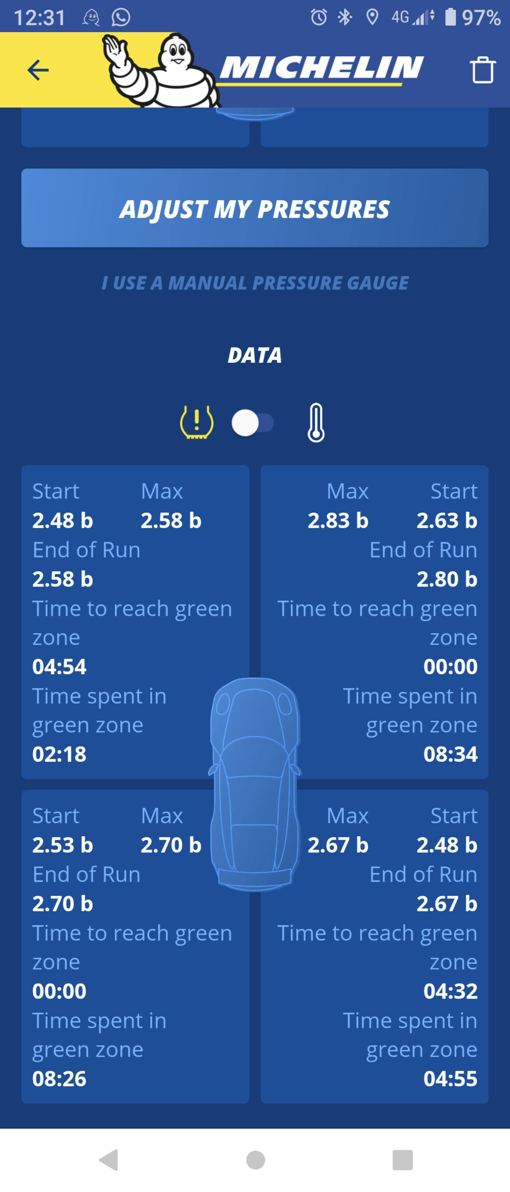

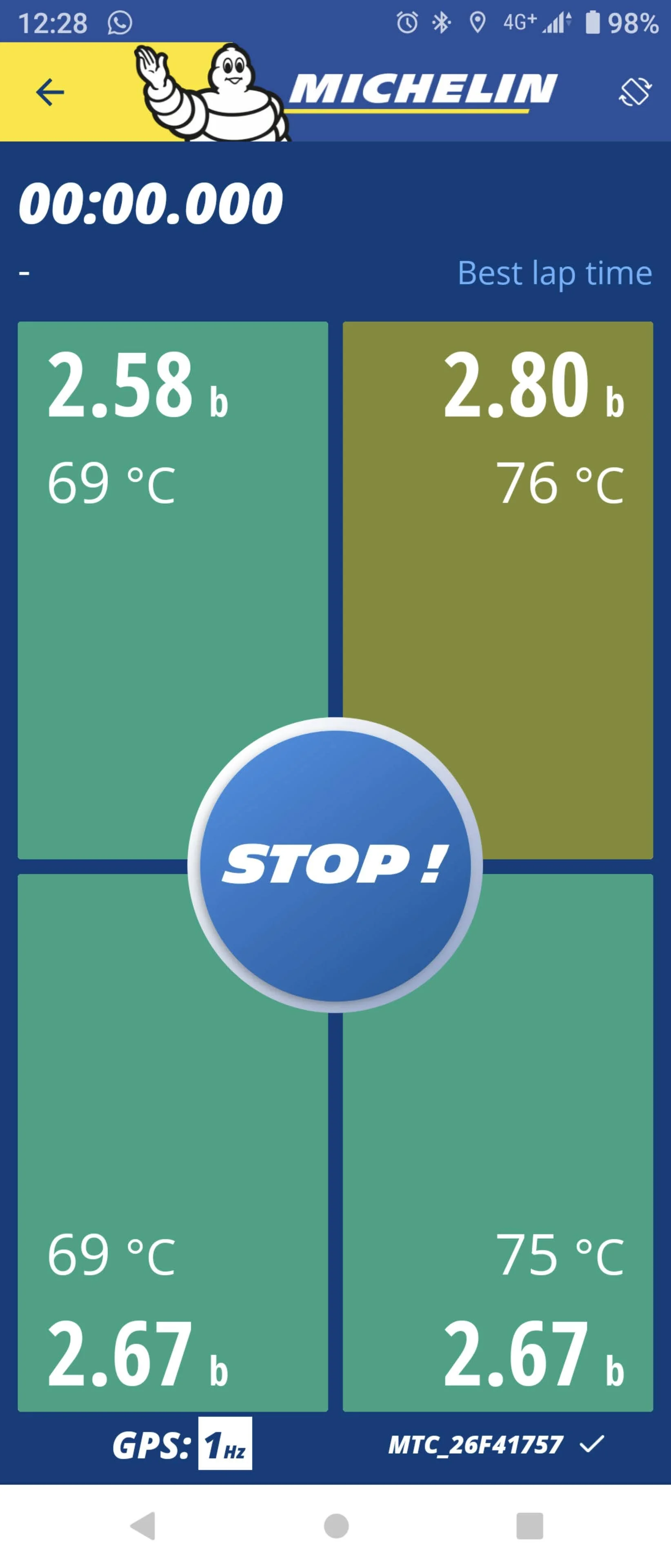

Did first laps, using Track Connect app and Cup 2 Connect tires.
Pretty helpful tool to keep the tire parameters under control on a race track
More about my experience here: https://www.expressivedrives.com/blo...-track-connect

Originally Posted by Rochen_00 View Post
What pressure does Michelin recommend for those tires on the M3 e92?
Track connect recommends front and rear interval 2.5 - 2.8 bars. Yes, BMW recommendation for street use is 2.4 bar front / 2.6 bar rear. But based on my experience, 2.6 bar front pressure is correct. I have 2.5 degrees camber in front and at lower pressure inside edge of the tire warns way faster.
But, I believe that Track Connect recommended pressures are track, temperature and weather related, not one for all.
