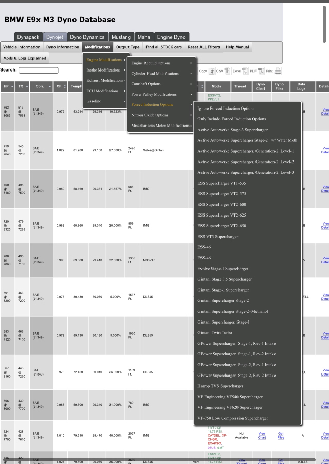

How about the G-Power SC?
See the S65 dyno database for plots and data..
http://www.s65dynos.com/DynoDB.php

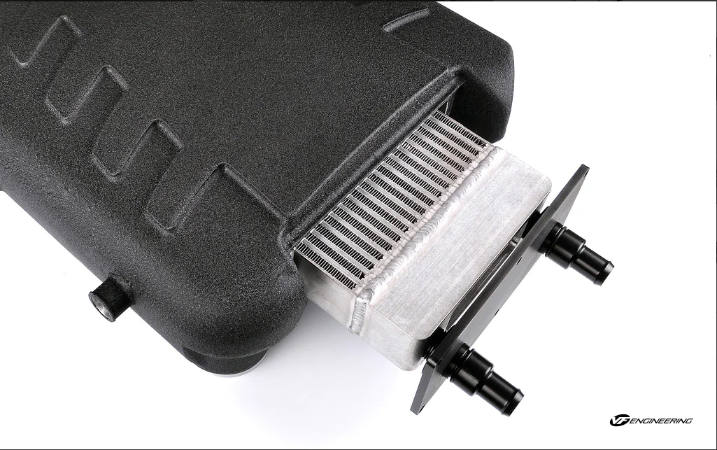

Prior to buying the Harrop SC, I also appreciated the VF-Engineering kit design approach. Especially the air to water charge cooler inside the Plenum - which is the same compressed air charge cooling philosophy Harrop uses - though Harrop use two smaller units instead of one. I just noticed VF have dropped the price on their 595hp kit (to $6995) - and they still sell their 620hp and 650hp SC kits. It seems VF are not as well known as ESS, but the hardware (Vortech centrifugal blower), aluminum castings, and engineering look pretty good for the money IMO. Thoughts?
PS:
I'm not affiliated with VF Engineering.
https://vfengineering.com/products/b...supercharger-1

Originally Posted by hofmandi View Post
I was always under the impression the Active Autowerke solutions where higher in HP and Torque with respect to other comparable offerings, mainly due to the Rotrex Supercharger. I do not have any dyno examples to back that up, was just wondering what the original poster saw that made him even look to remove those results from the data he posted?
Lots of dyno data at the S65 Dyno Database link below. Use the filters to find what you need.
