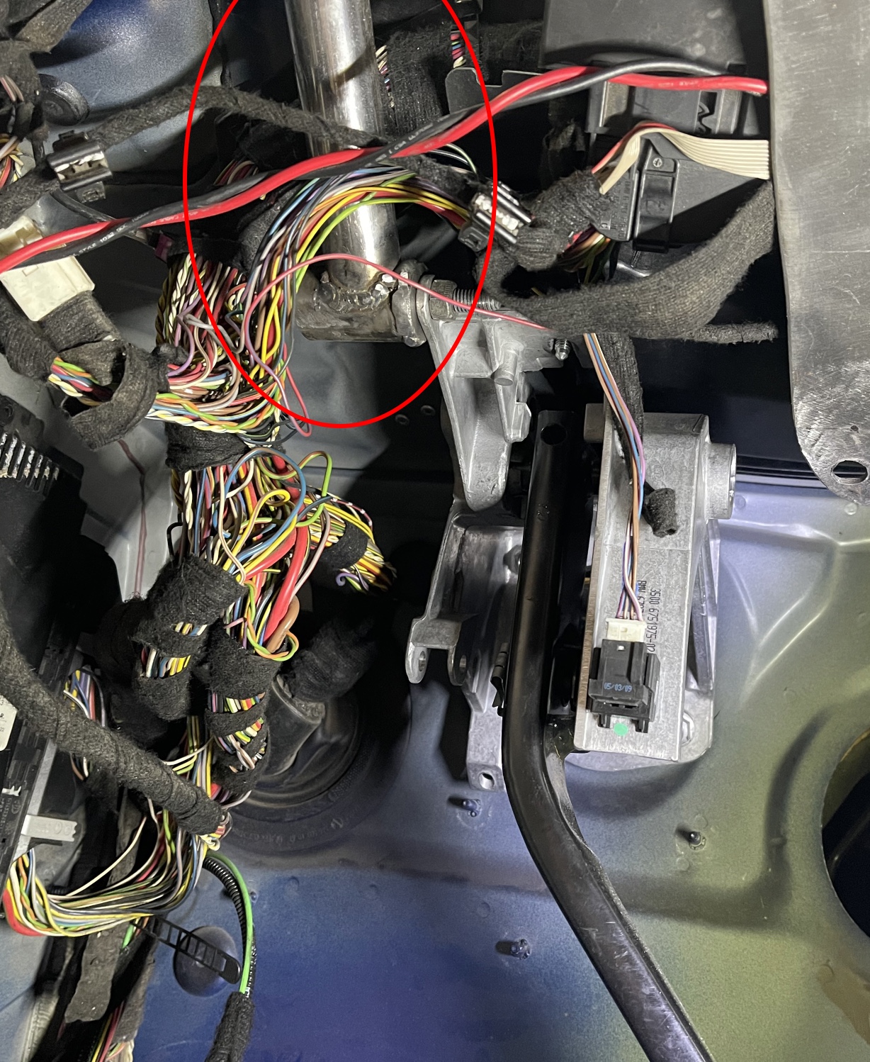

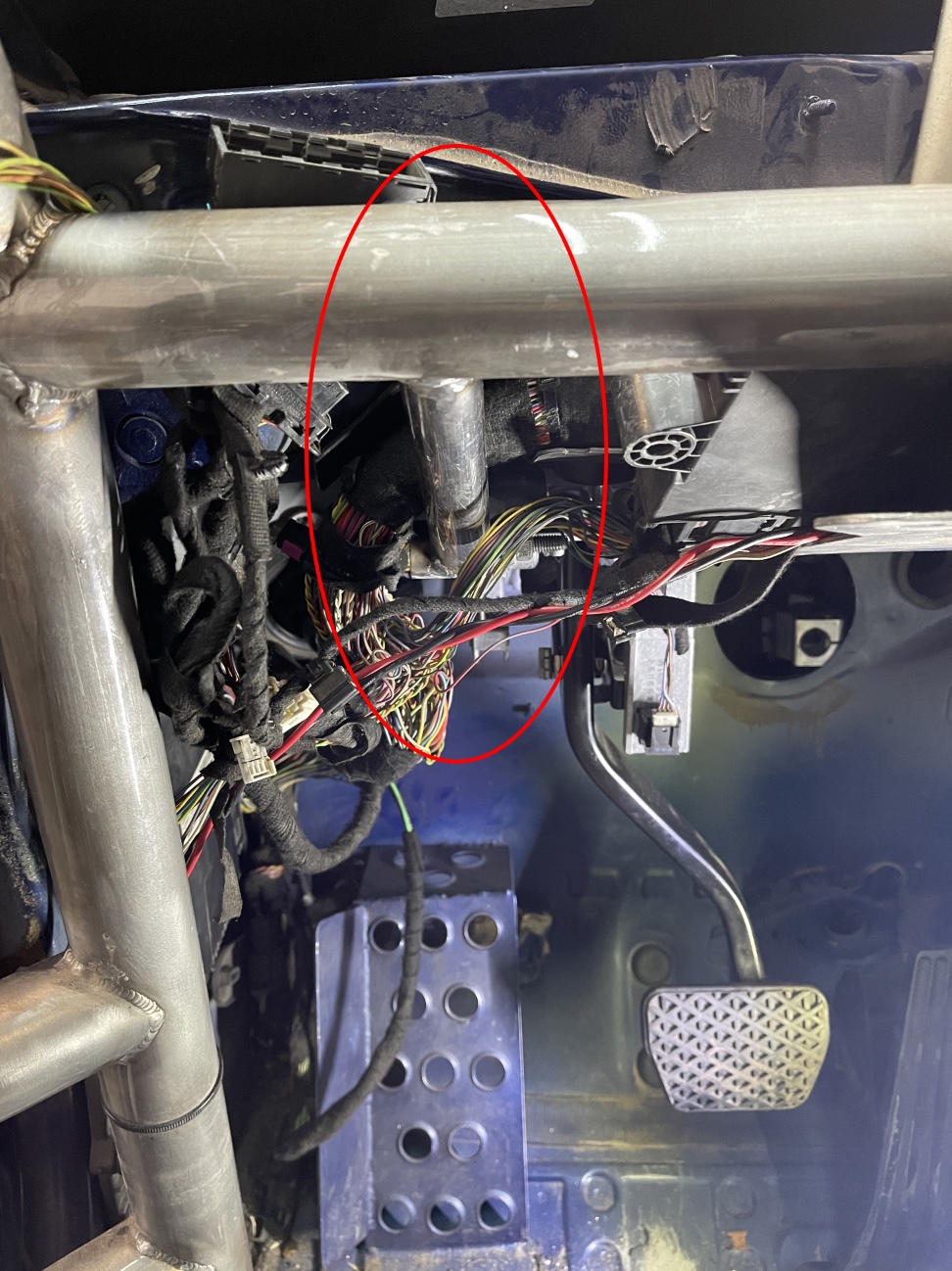

Got the car back last night from the shop. They welded a support tube from the cage's dash bar down to the brake assembly for support. We ended up having to replace the brake assembly with the one we got from the junkyard because the assembly was fatigued. I ended up with a larger brake pedal which I've been wanting for some time. They also took care of some other mounting stuff behind/under the dash that has been lingering for years.
Also, one other mod has been done to the car which I've been wanting for some time. It's operational but not fully finished yet. I don't have a good pic of it yet, so I'm just teasing it for now. I am signed up to run NASA TT at Pueblo this weekend so I'll get a picture of it soon.
It looks like I will run TTU this weekend to try to activate the tire contingency. TTU has 4 guys in it now. If I move over to TTU, then there would be 5 and we have a chance at tires. TT1 only has 2 guys. Looking forward to getting back out there!
Here's a couple pix of the support tube.

Let's file this one under: Well......back to the drawing board.
I'm disappointed to report that the fix for the brake pedal did not hold. I got through the practice/qualifying session ok. Qualified 1st. Then, in the first competition session, on the first hot lap, in the first big braking zone for Turn 1, something broke/snapped again under my foot in the pedal assembly. I was so annoyed, I didn't even bother finishing the lap. The track has a mid-course exit at Turn 7. I exited there.
Looked under the dash. The new support bar that had been welded to the cage was still intact. But the aluminum eyelet hole on the brake assembly that bolted into that support point had cracked and broken away from the support point. What we are taking this to mean is that the firewall is bowed out so much, it's lowering the brake assembly so much that too much stress is on that top support eyelet and it broke under the strain. It's looking like we are going to have to weld plating in front of the firewall to create a new support for the brake assembly that was bolting to the firewall. sigh.......
So, the competitive aspect of the weekend was over before I could get a lap in. But I had something else to consider. I have been thinking about doing NASA TT Nationals at Daytona in September. You need 5 days of registering laps in competitions to do Nationals. I decided that I should at least register a lap in the competition so I get credit for the day. The brake pedal was operational if you pressed it gently----you just couldn't press it hard. I decided to do another session where I would simply go out and register an officially-recognized lap on the transponder. Went out at the back of the B group and slowly cruised the track without hardly needing to brake. Got my lap in, and then left to take the car to the shop.

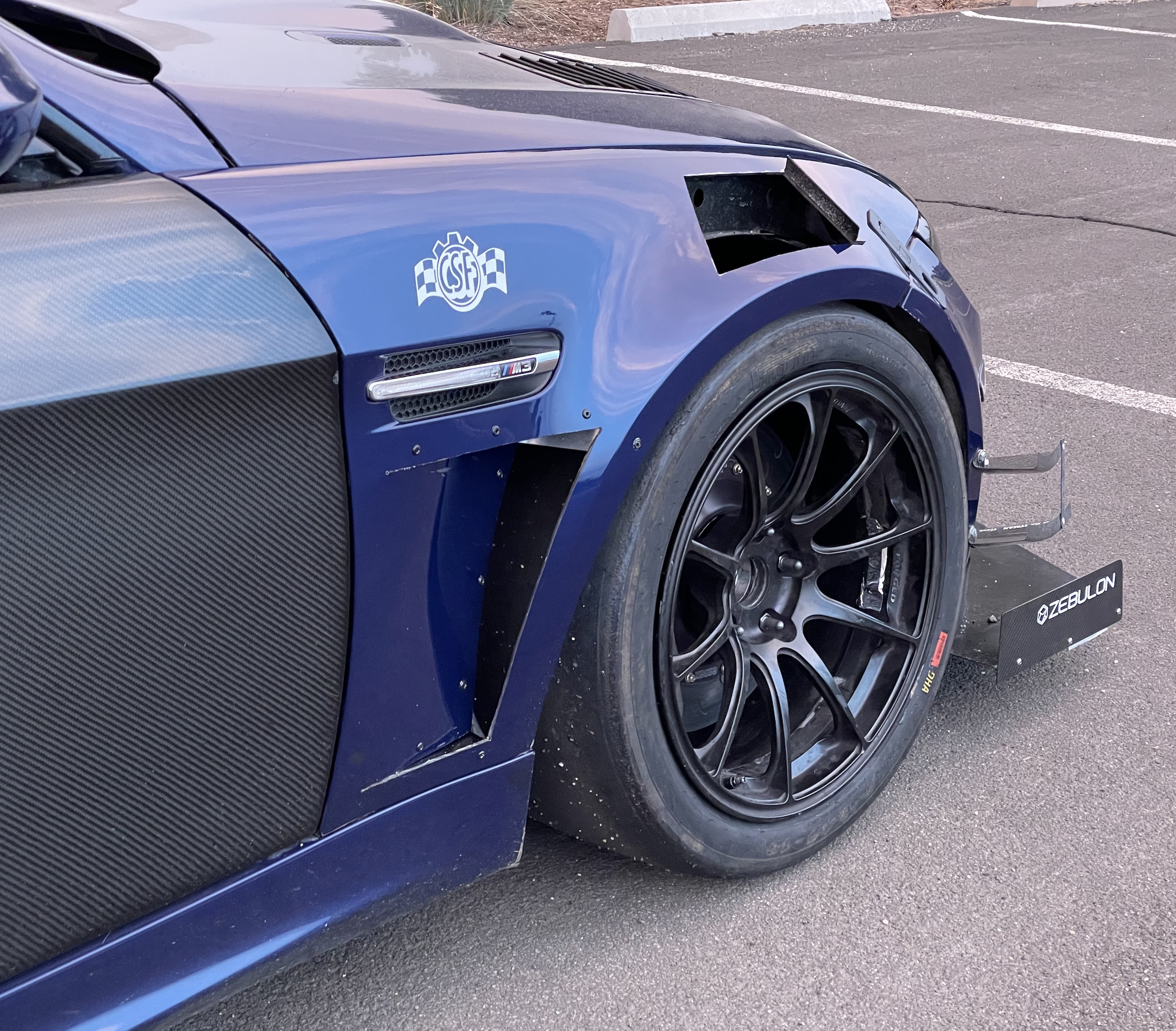

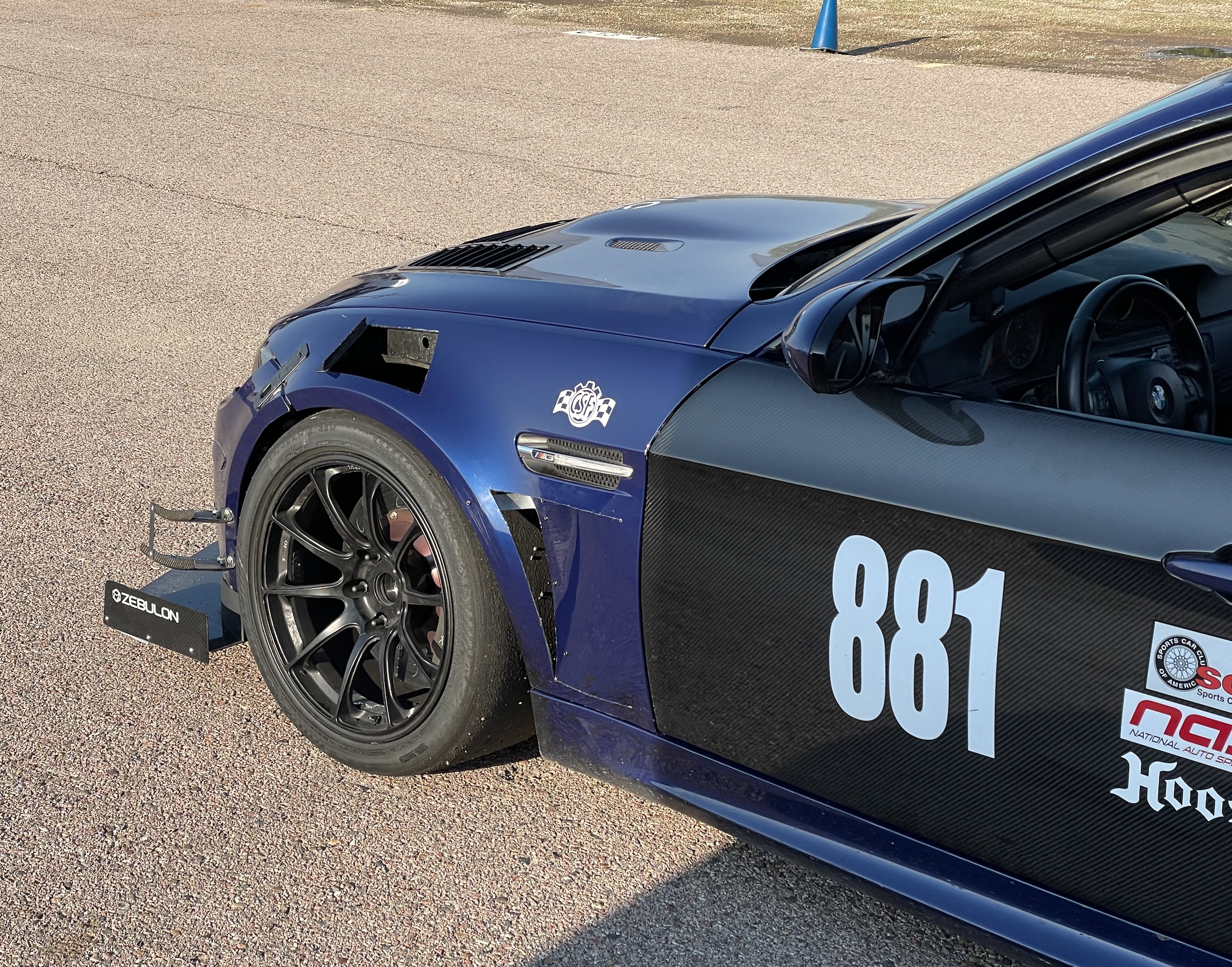

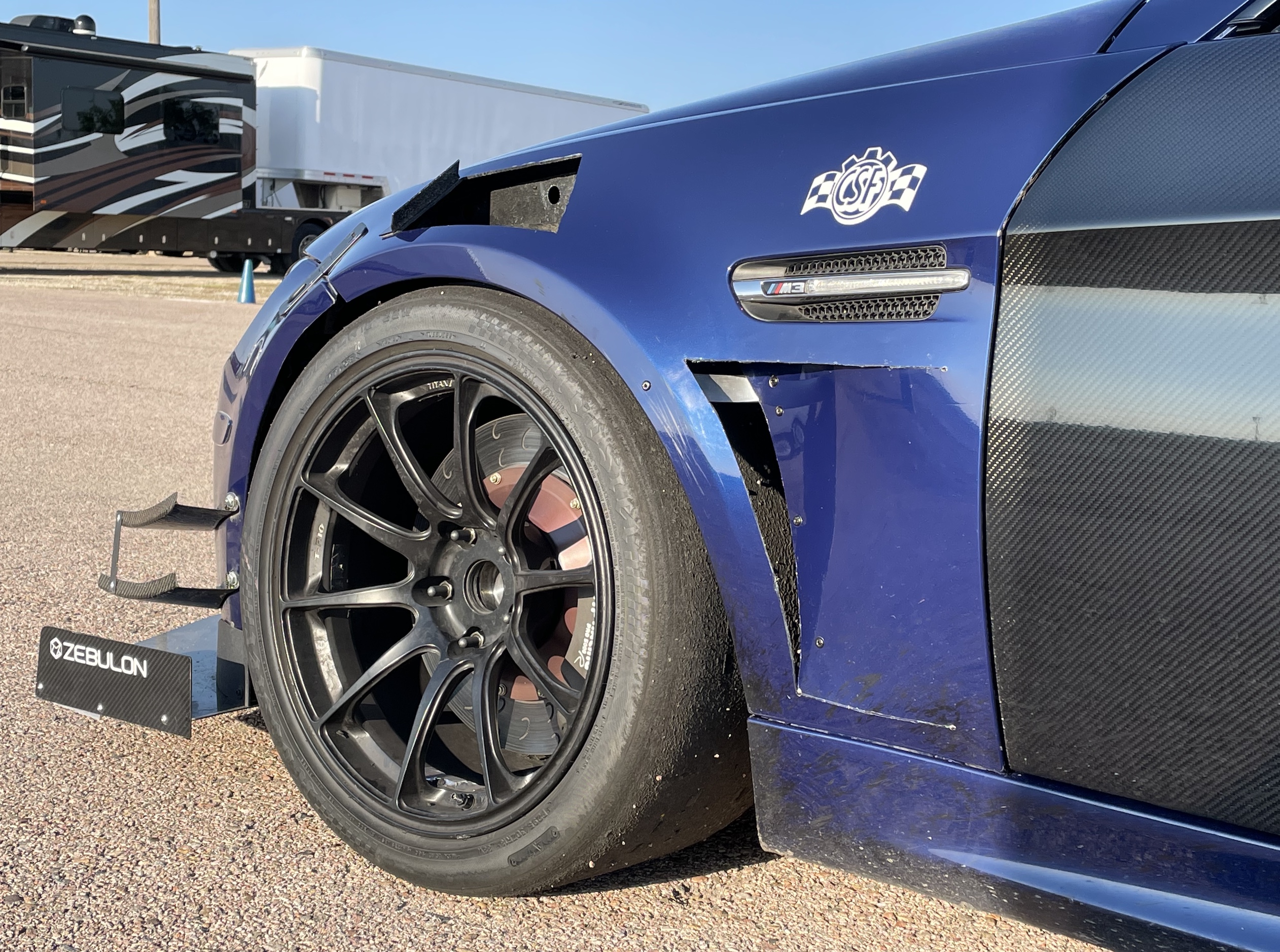

I mentioned a mod that's been done to the car. We cut the front fenders so that the wheel well can vent out the back in addition to the top. For now, it's still in the concept stage. It's not pretty, but the cuts are done and a brace has been fabricated for the inside to hold the plastic parts steady. There's going to be more "prettying-it-up" work on it later. And I think we are going to have to move the brake booster to finalize it.
I didn't get any awesome pix, but here's what it's looking like:
Other than the brake pedal, I am satisfied with how the car is working overall. I believe I like these current rear springs. I am hopeful that once we get past this brake pedal issue that the car can be in decent working condition. But I gotta tell ya.....this brake pedal thing is......frustrating.....

if you are running in the GTA event in long beach, i'll make it a point to be there. at the very least, you'll have to stop by my pad for a beer and a burger.
also- if you're not running fender liners, have you considered cutting away the fake vents on the blinker badge and making that a functional vent? might be fun.
Appreciate the offer! Would be great to catch up in person.
I think the venting I have now is enough—-top and rear. Plus, on the sedan, it’s a bit different than the coupe.
