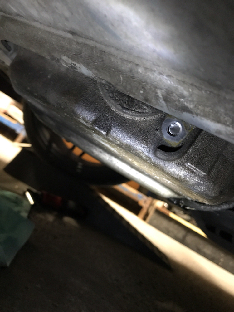

Engine grounding help
Hey guys, I messed up bad. I broke the engine ground strap bolt in the oil pan flush off. I'm panicking pretty badly, because I think this is going to be a pricey job to fix.
Any ideas of how to get the bolt out of the pan? There is little to no room (had to fabricate a shallow socket)
Is there anywhere else I can ground the engine?
Or I my only option to drop the pan and drill it out?
Please help

There are a few places to ground the motor but not all are easy to get to. When my ground broke, I temporarily made one from the engine lift eye on the top of the motor to the factory ground point next to the coolant reservoir. I used some battery cable as the ground cable.

It needs to be bare metal. I had to remove the lift eye and sand it to bare metal. Paint interferes with the ground. The more you look the more places you might find. You can buy replacement ground straps at auto parts stores. If the ring terminal is too big, you can use a bolt with a washer.
Probably you can drill out the broken stud. But be very patient about that. It must be done carefully.

U can attach to alternator directly to chassis from there

If u have a Dremel u can create a small slot on the broken bolt and then use flathead screw driver to remove it

An Easy out seems like it would work just fine?

The only problem is the lack of room, I'll try the Dremel method and see if that works. A drill with an easy out wouldn't have enough room
Ideally if I could find another grounding point that's permanent, I would just forget about the bolt and move on. Any ideas on another ground point?

Any hole on the engine block or accessory bolted to the block can work. You just have to look carefully to find ones you can get to. Might not find any empty holes. Might have to remove a bolt to attach a ground cable. My temporary one is still in place a year later and I will probably leave it as an extra ground.

This is exactly what I'm looking for! Thank you so much! I'm going to do the exact same

It’s ugly. Most would rather have a ground that is out of sight but at the time, I could not quickly find an easy place underneath. There probably are some. Remember clean metal works best (even though the bolt is going into the block) so grind off any paint.

It worked great! Thank you!
Turns out the route of my initial problem was the starter after all. Changing that tomorrow. $450 later...
