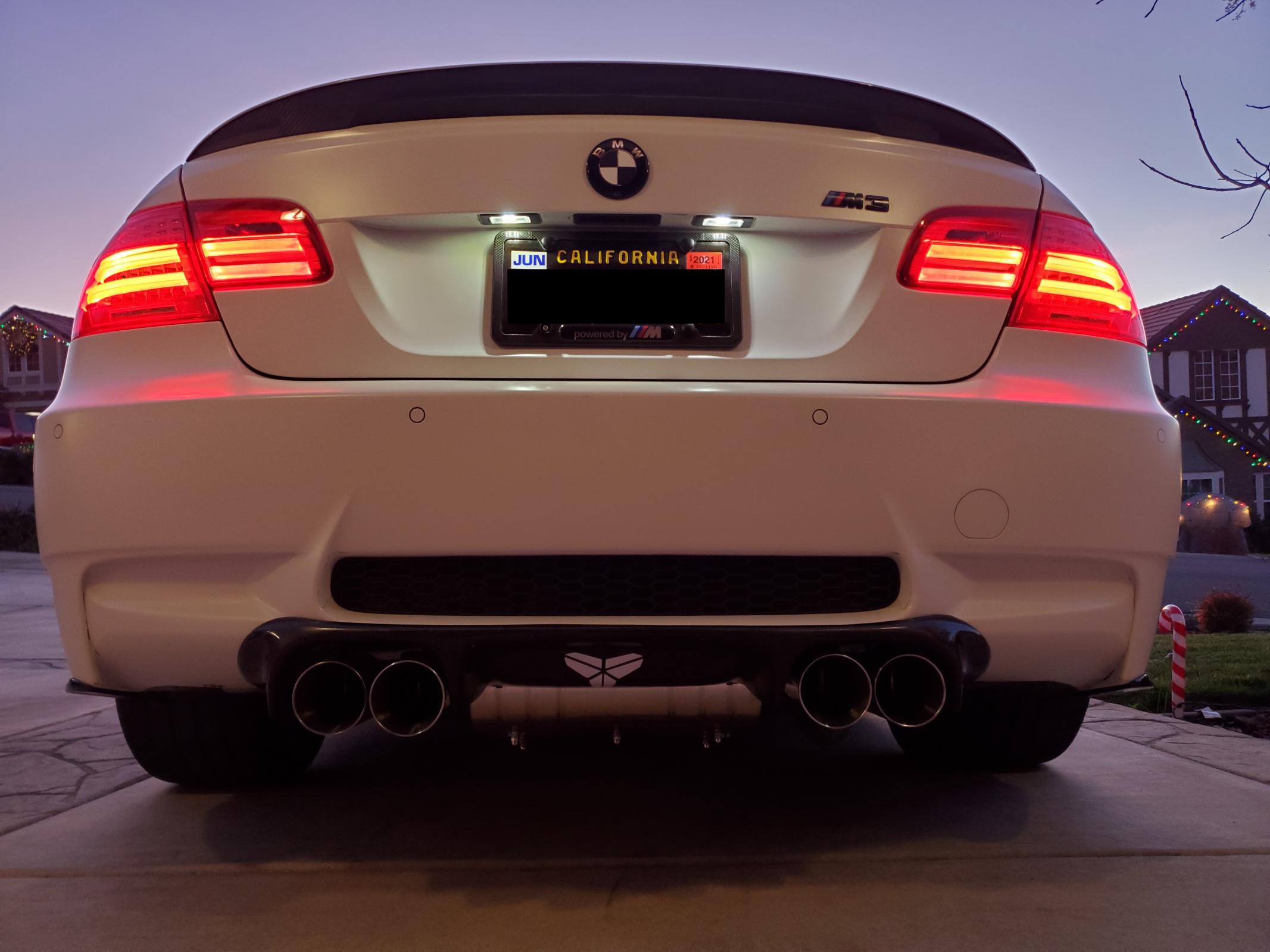

GT2 with RKP E92 M3 Carbon GT Diffuser - Sport.
Need to adjust the exhaust, hangs a little lower on the left.
