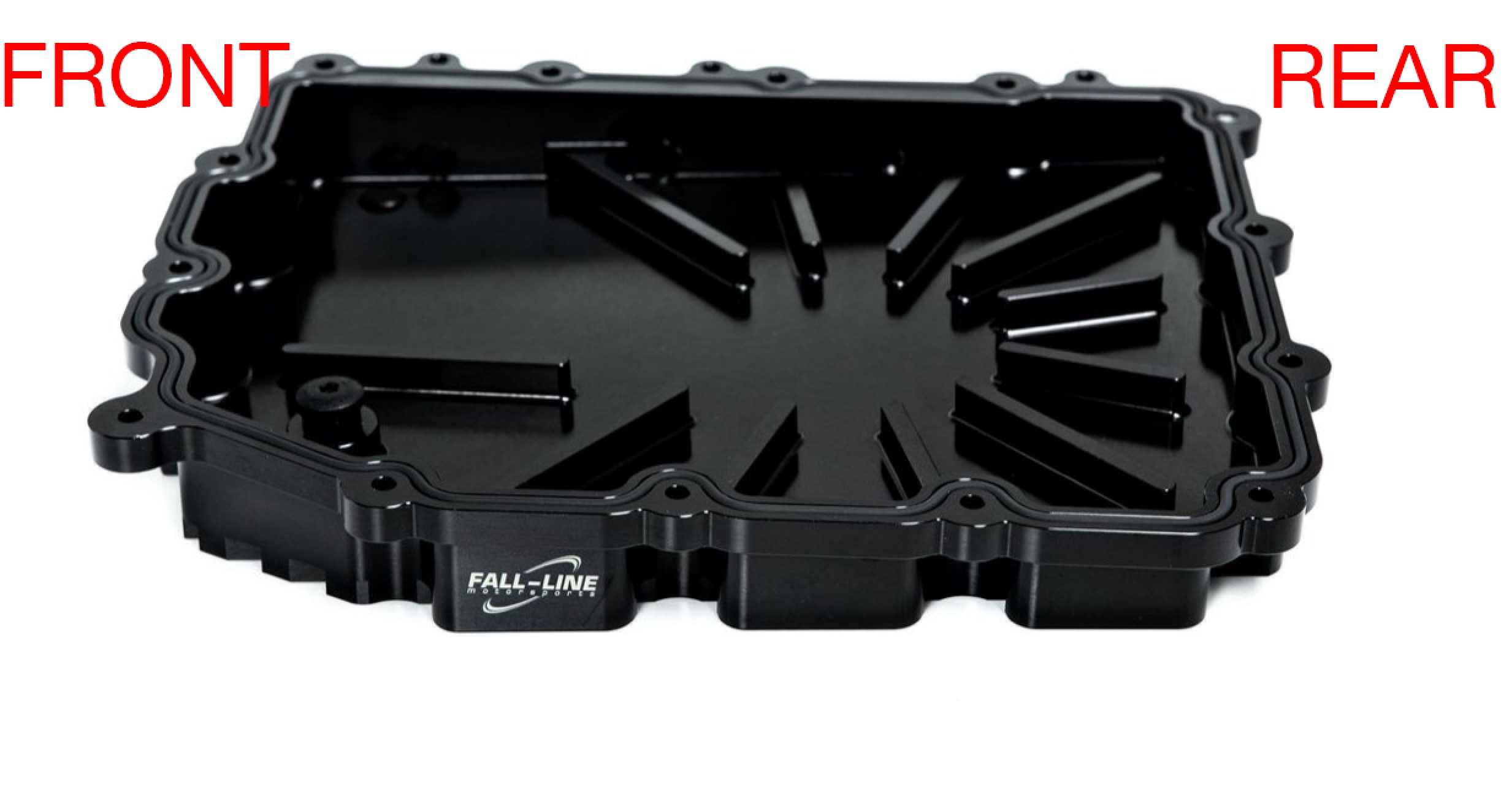

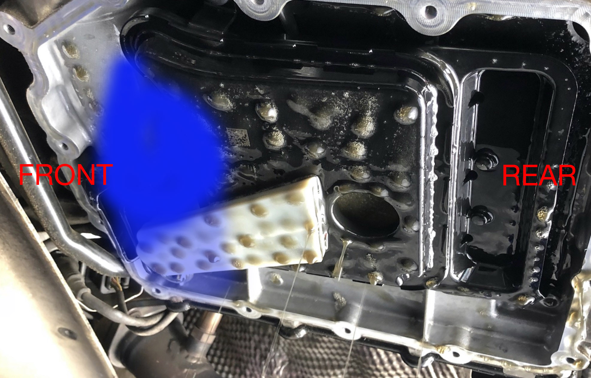

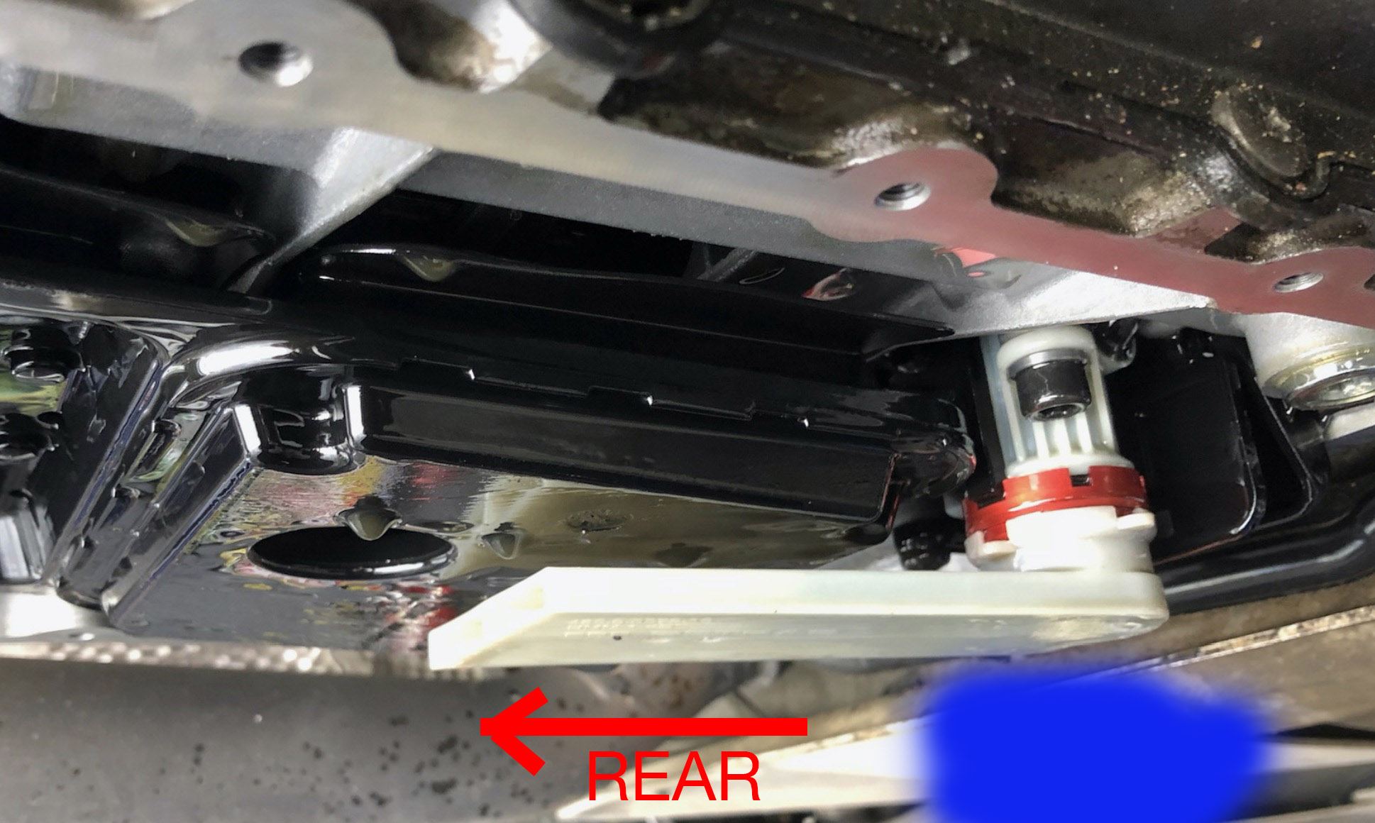

fwiw, the deeper part of the Fall-Line pan faces the front of the car. I wonder why they did that way. If the bottom of the pan doesn't sit horizontal to the ground---and I have no idea if it does (heck, the car's rake could affect that)---this would encourage fluid to pool in the front of the pan which is not where you want it. The intake points to the rear of the car and sucks from the middle of the pan.
In the pics below, you can see the flat white horizontally-oriented intake. I put blue blobs to show where the oil would be encouraged to pool if the pan doesn't sit completely flat---away from the intake inlet.
Here's the Fall-Line pan. I added text that shows the front and rear.
Since the Fall-Line pan is taller in the front, that also may semi-negate the potential advantage of clearance over other pans.

Originally Posted by slicer View Post
I have had the opportunity to lay hands on both the Fall-Line and the SLON pan. I currently have the SLON pan on my car and have had good results with it other than clearance issues (it has scraped the ground), and some slight seeping at the sealing area. While the SLON pan's extra capacity is welcome, it is now the lowest point on the car. That presents it's own challenges. I plan to switch to Fall-Line this winter.
The SLON pan is deeper and has more capacity, plus comes with an extension to the oil pickup, however.....
The Fall-Line pan is made to tighter tolerances and is designed to use a "Viton O-Ring that resides within a clever internal channel. Viton O-Rings, due to their exceptional resistance to temperature extremes (-20°F to 400°F operating temp) and low gas permeability, have incredible aging characteristics and therefore eliminate the need for regular replacement". This ring requires tighter machining tolerances then the gasket material that SLON uses.
The Fall-Line pan is modeled off of the OE M3 GT4 pan, and has been extensively tested in race use by Fall-Line. I know all of you here are tracking your cars and put down very fast lap times. However, Fall-Line has been at this for years and actually campaigned and supported legit e92 race teams. This isn't a part that they just threw together. It had been tested for years but not released to the public until now. The GT4 does not use a pick-up extension and my understanding is that the tapered design of the fall-line pan negates the need for it - PLUS improves ground clearance. As you can see in DogBone's pics (thanks DB), the pickup is towards the rear of the pan. This where the Fall-Line pan is tapered to a lower height. The other major bonus of the Fall-Line pan is the ability to add an additional DCT cooler. There will be a cooling package offered as an optional addition in the future.
I will add more techical information if/when I get it from Fall-Line but this is what I know thus-far.
