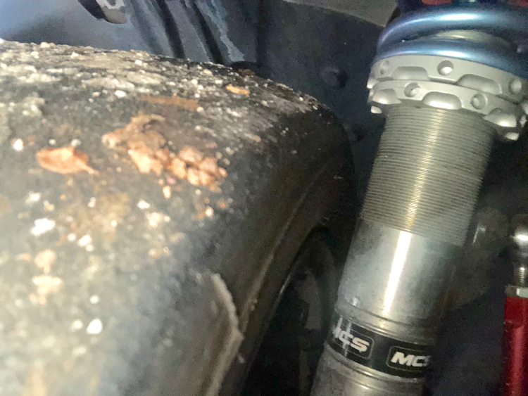

So who's done it? Also ...who has done it with MCS suspension?
For this to be accomplished, spring perch needs to be raised some. I'm on 6" 2.25 900lb springs. Currently run on 18x10.5 et33 with 20mm spacer upfront on 285 Hoosier slicks. Had a tire blow out at the Glen last session of a 2 day event. Tire got severely hot, expanded and hit the spring perch.
285 square feel great, but I want to step up.
Obviously shorter spring will compromise travel...would love some feedback of the .....Minds.
Thank you.

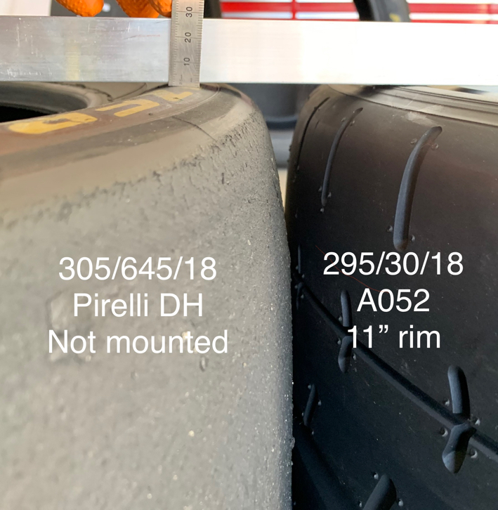

Pirelli DH 305 runs relatively narrow. It's actually narrower than a 295/30/18 A052. Pics for reference.

      07-27-2020, 01:10 PM   #17
fsmtnbiker
621
327
Drives: E92 M3, Evora S, E36
Join Date: Jul 2013
Location: Phoenix, AZ
Great comparison slicer ! Is the 295 AR1 also on an 11" wheel? Looks like it, mine were not quite as stretched on a 10.5"
I'm going to try fitting the 315 AR1s soon. Hopefully they run true to size like the 295 does.
315/30-18 Hoosiers on 18x11 ET25 wheels don't quite fit under stock fenders. No way its going to fit up front, even with camber at -3.7 its still a ways outside the fender. In the rear it might work with a ET30-33 wheel and a lot of camber.
