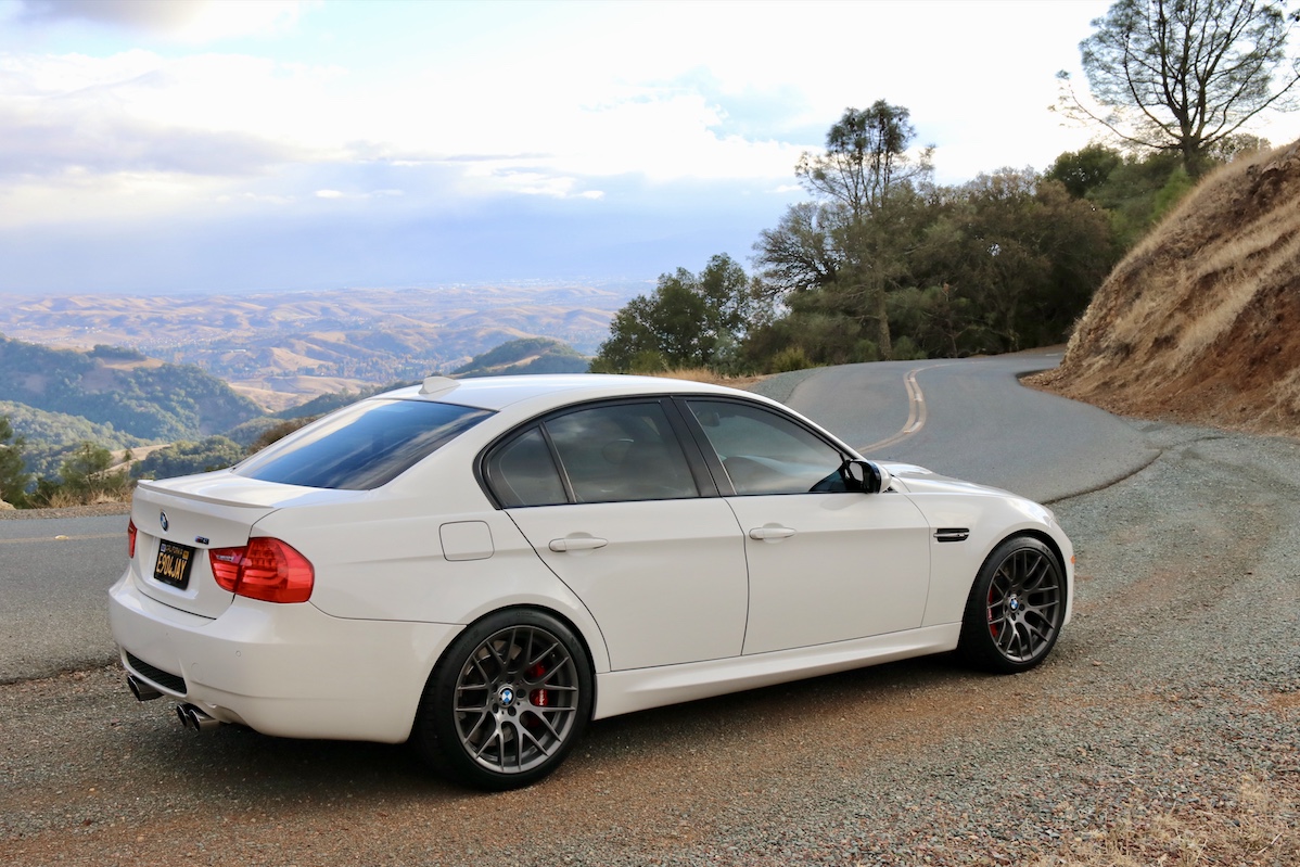

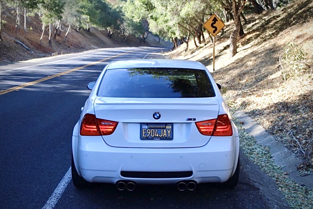

I can check what number mine says, but here’s how my tips fit (E90 spec, Black Series Sport). If yours fits, who cares what number it reads?

I agree. I installed it and loved the sound so I didn't worry about it. However now I'm selling the car and the exhaust separately, and I want to make sure I'm selling the exhaust properly.
For reference, here's how it looked on mine:
      12-02-2019, 08:46 PM   #11
munkey
28
136
Drives: E90 M3
Join Date: May 2017
Location: Virginia
But the weird thing is when measuring the tips, it was shorter than on an e92. But looking at the fit it certainly seems like it's too long.
