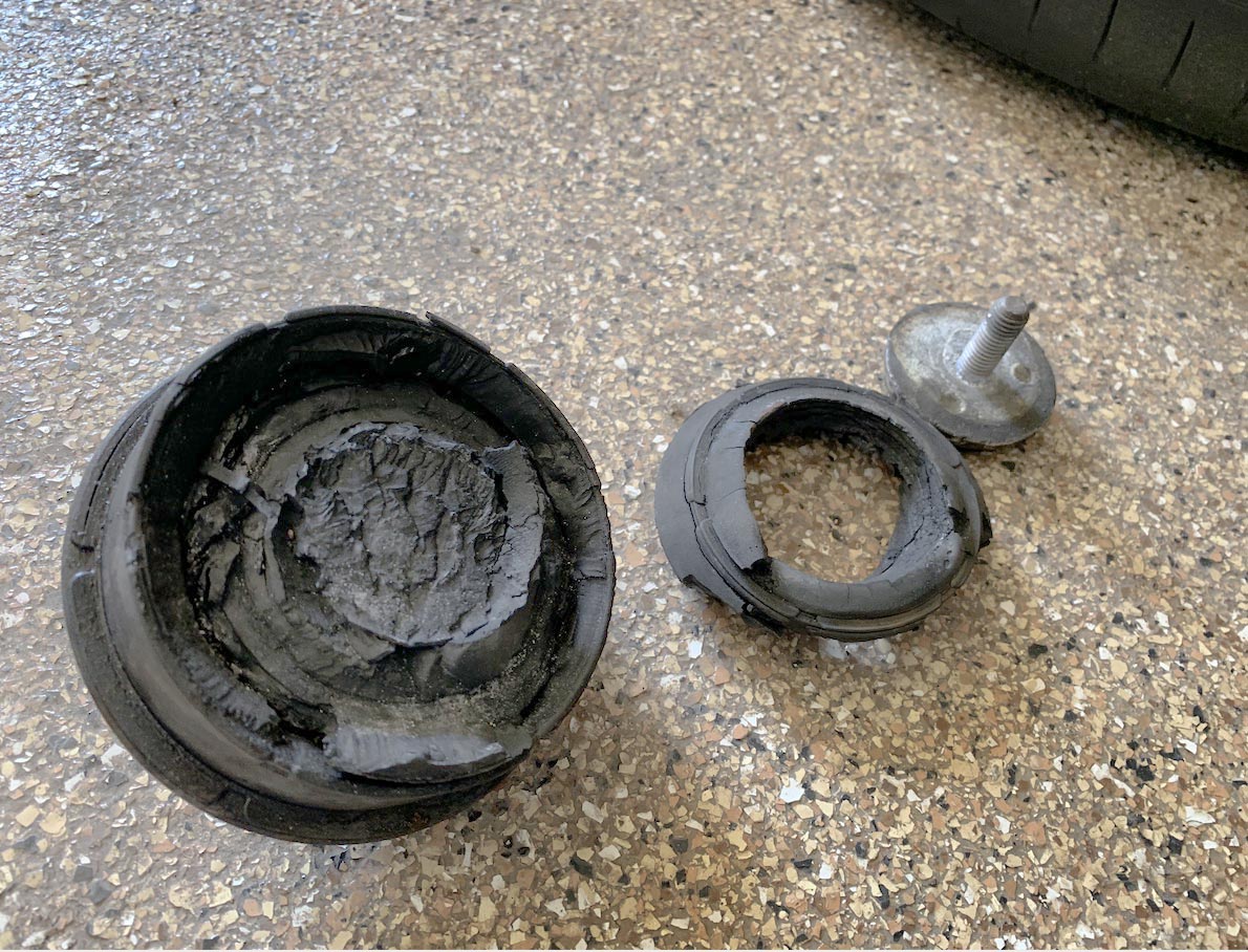

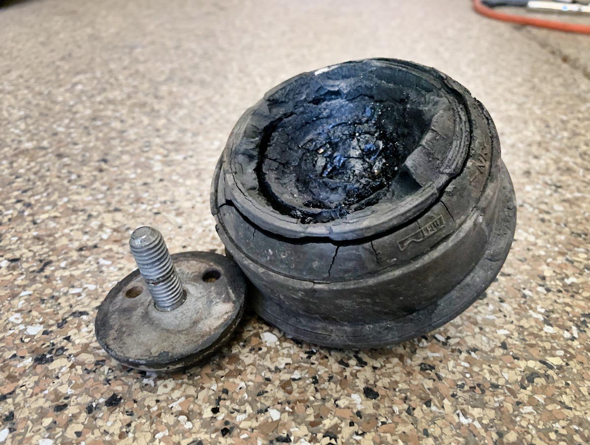

Alright----let's file this one under: You want $811 in labor fees to install engine mounts??....hmmmm maybe I'll try that on my own too.....
So, today's post is about my E92. I was mentioning that something was up with it---it wasn't revving up normally. An odd vibration appeared past 1500 RPMs. You could feel it and hear it. I took it to a race shop. They didn't find any smoking gun. But they did find some overly worn spark plugs and replaced them.
I was quite convinced that it was engine mounts. I even told them I thought it was that. But they didn't think so (and didn't look at them). The car has 87k miles.....and I doubt they've ever been replaced by any previous owner.
So I bought some engine mounts and then called around to see how much to install them. First----some shops said they would not use my parts due to liability.....then, I was just being given book rate---5.6 hours.....$811 in labor.....argh.....
So, thank you to the people who gave me book rate quotes. You inspired me to try to do the job myself. I'm happy to say that I was able to do it!
And once again, I want to thank the DIY section of this forum for demystifying the job. And some friends also helped talk me through it.
Here's how I did the engine mount install:
-remove felt transmission cover
-remove skid plate covering the oil pan
-remove rearmost bottom fender pieces on both sides.
-remove nuts from top and bottom of engine mounts
-remove airbox
-put a 2x4 piece of wood on a floor jack and place that under the oil pan and jack the engine up until the intake manifold is basically touching the braces in the engine bay.
-remove the 4 rearmost bolts in the K-frame
-unscrew the 4 remaining K-frame bolts until they are clinging on with their last threads. This should allow you to reach the mounts and remove them.
-On the driver side, there's a bracket blocking the entrance to where you want to place you hand to access the engine mount. I removed it with a Philips head screwdriver.
-remove the old engine mounts and replace with new mounts.
-Reverse your steps to re-assemble everything. (One of the K-frame bolts goes back in at an angle. It doesn't take much to ruin the threads. Don't ask me how I know. But I at least I am the proud owner of a thread tap kit!)
My engine mounts were in TERRIBLE shape. One of them was in three pieces and the other one was in two pieces. I mean----where is the fluid that's supposed to be inside? It's long gone.....they were both bone dry on the inside. Please see the artwork for yourself.
Once the mounts were installed, I fired up the car and-------the vibration/resonance problem was totally fixed. The car runs great. I was so happy that three days later, on Sunday, I ran to High Plains Raceway and participated in my first NASA event. How did my first NASA event ever go? Next post!
This E92 M3 is becoming my experimental test mule. I never thought I'd dig into a car like this. I am really enjoying it......but......I need some kind of lift. Doing this job on my knees and hips and back while the car was on jack stands was far more painful than it needed to be. Someone recommended MaxJax-----very interesting.
