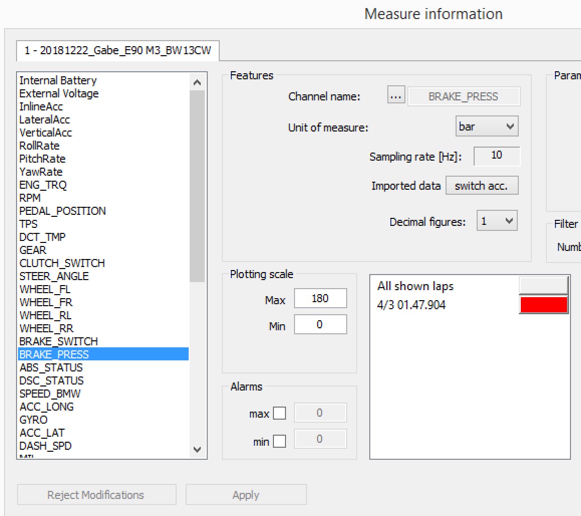

Get the AIM Solo 2 DL, wire it via CAN for the best accuracy and most channels.
If you are technically inclined, and know some basic math and physics, you can figure the rest out with YouTube videos and owner groups. I've also got some great books that I can recommend.

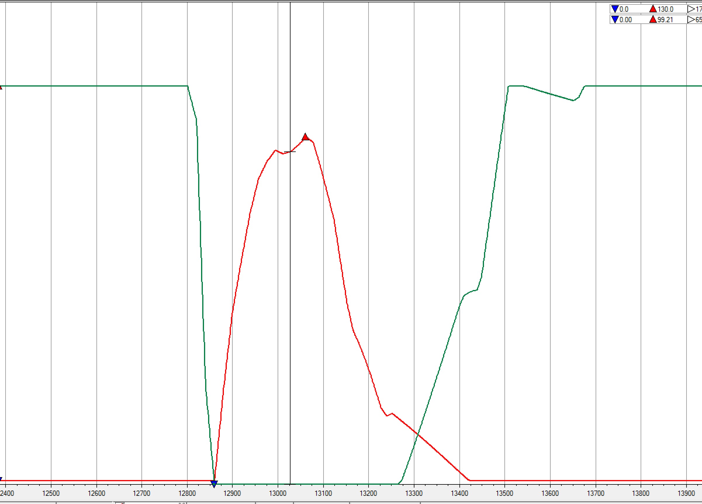

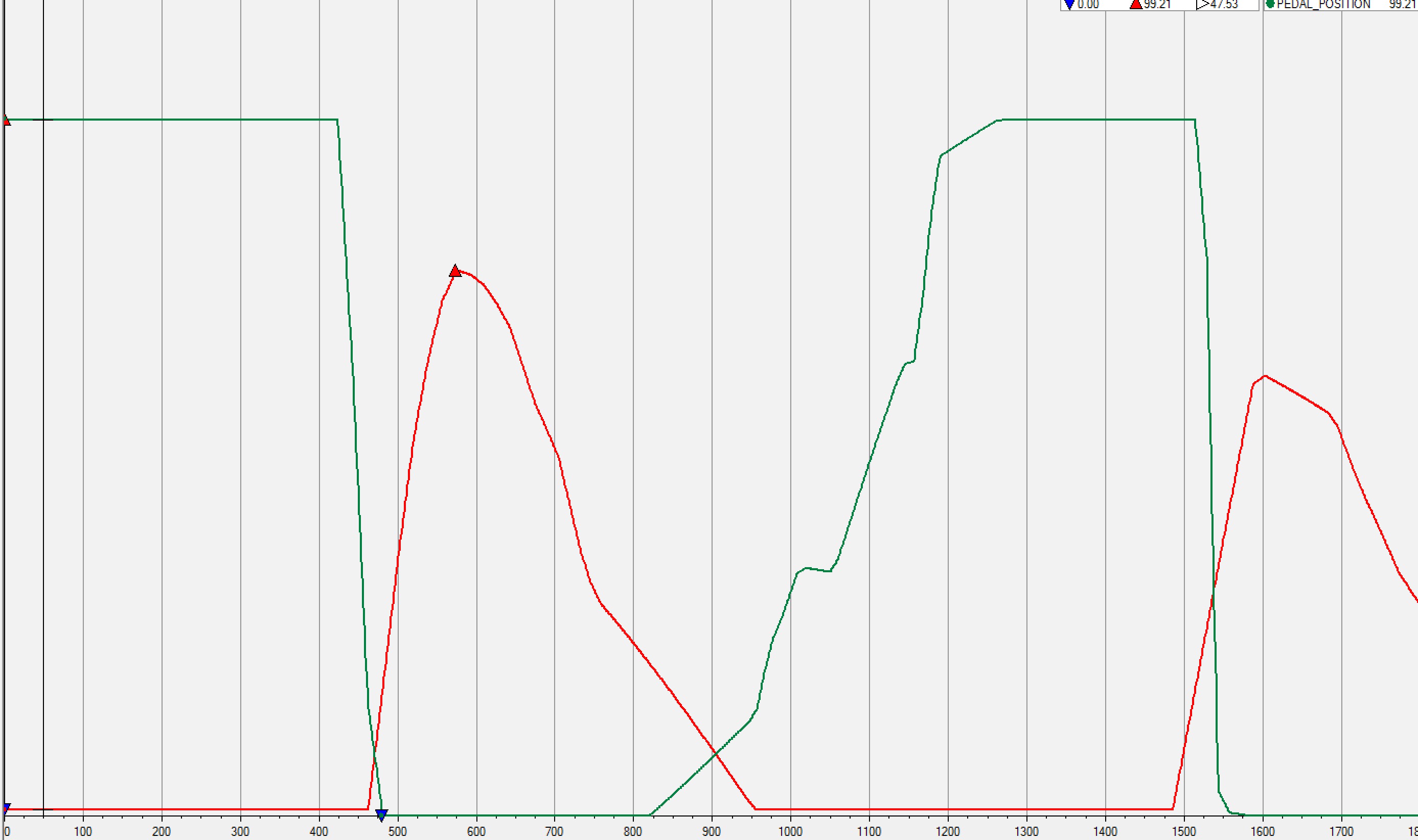

Originally Posted by dparm View Post
Can you post a more zoomed in view? The X-axis maximum value is quite large, it looks like an entire lap all at once. Would be more interested in seeing just one segment at a time.
Here's two pix: the first turn and last turn zoomed in.
I'm assuming it takes a moment for a pedal to return all the way to it's resting position. Most of the time, my movement is pretty quick from one pedal to another. But again, I do not left-foot brake. I did try it a few years ago. Didn't really take to it. I always laugh at myself because I feel like my left foot is a peg leg in terms of being capable of fine movement. I could never have been a drummer!!
I wonder if that is anti knock back springs not letting the piston release all the way until you're further driving off. But that means it's not reading pedal pressure? Interesting.

I'm going to keep asking this: what is the refresh rate/polling interval, and is smoothing enabled?
The AIM is at 10Hz when looking at brake pedal and gas pedal. Most of the parameters it samples on the CAN bus are at 10Hz.
(It samples G-forces internally at 50Hz.)

Thanks. Is the software performing smoothing? Can you turn that off or reduce the smoothing factor?
I've never used the AIM software. I am more familiar with Cosworth's Pi Toolbox but I assume it's similar.

In Aim, I study three variables in relation to timing. Steering Angle, Brake Pressure and Throttle %.
This is why I am never bored at a track day. I pretend to be Lewis Hamilton (just slower) and I find things to work on no matter what the weather like, wrong tires diameter, mix and match tires types, lousy brake choices, you name it, I am doing it wrong. But I have so much fun.
