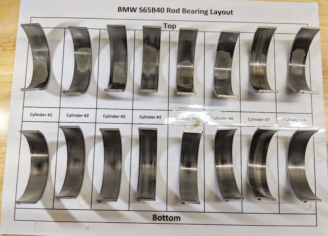

New member from Finland joining the thread!
M3 DCT -08, 142 000km (88 000 miles), original bearings and tracked propably every summer.
Bearings almost in correct order, you can spot the top ones quite easily...

2008 M3 150k Miles. What do you guys think of these bearings?
Would you guys care to share maintenance history, driving habits, etc. as additional data points?
Those look like they are made out of some kind of exotic hardwood... Yikes.

just finished installing new rod bearings. BE bearings, BE bolts. 08 M3, 69k miles. glad i did it when i did! anyone who owns one of these cars must get it done. here are some pics of original bearings

That is similar to what my 08M3 bearings looked like at 60k. No copper showing in center of bearings but wear patches in most and a copper showing along the parting lines and a little down the sides.
