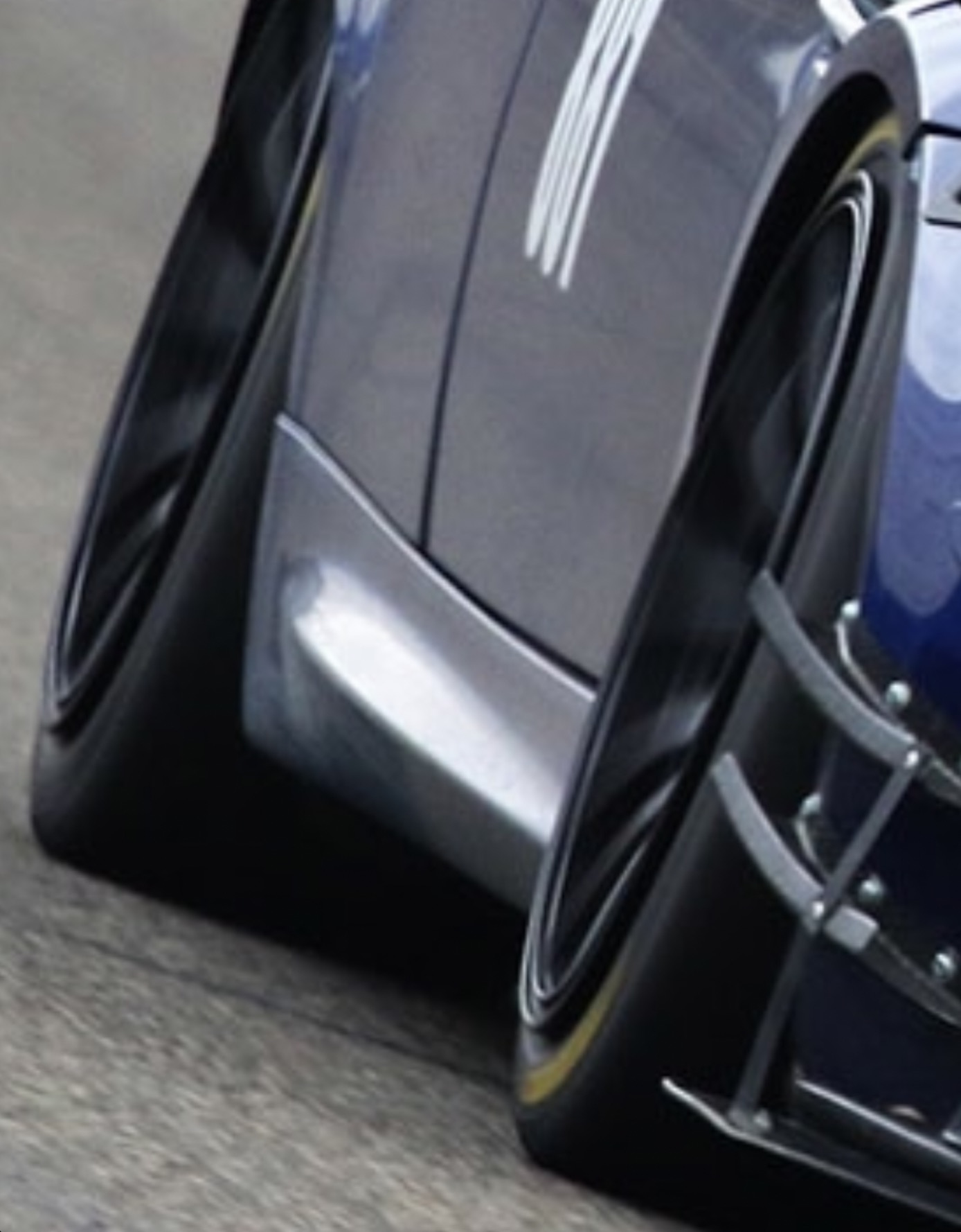

If the 305 tire that you want to run is a Pirelli DH, then a 10.5" rim is perfectly fine to run. Pirelli DH 305 tires run narrow, if anything. I have found no compromise by running Pirelli DH 305 on 10.5". The tire is responsive and fast, wears nicely and the tire sidewall of a 305/645/18 Pirelli is not stretched or pinched on 10.5". It looks very comfortable on there---ready for any type of load.
Let's look at DH 305 tires under load on track on a 10.5" rim, in this case, Titan 7 rims. This photo is taken with the passenger side tires taking serious load on the Auto Club Speedway Oval going at least 140mph at the time of the photo. We're seeing high-G's and high speeds on a banked oval. I can hardly think of a better picture to look at of a tire sidewall under a long duration of extreme load. The sidewalls look perfect on a 10.5" rim. No weird stretching or pinching or bulging or tucking or strangeness. You would have a hard time finding a moment where a tire sees more prolonged high stress than in this moment and we have it captured in a very clear picture and everything looks really great here.
A BFGoodrich R1S 285/30/18 is wider than a 305/645/18 Pirelli DH and that works fine on a 10.5" rim fine too. So, I believe that it is not necessary to run an 11" rim with Pirelli DH 305. (There's no safety issues as far as a 305 tire mounted on either of those rims.)
With an 11" rim in the front, you will force yourself to deal with fitment and rubbing challenges. You're just running out of room near the spring perch on the inside and the fender on the outside with an 11" rim. The 10.5" rim with 305 already rubs everything in the wheel well as it is. An 11" rim will just make it worse. Remember, just because a rim fits on a car when it sits in your garage does not mean that you can turn the steering wheel on a tight corner and then compress the suspension during high-G moments--especially if the car has been significantly lowered.
My advice: On the E9x M3 platform (without any widebody mods), don't go wider than 10.5" on the front.

I do run a 3mm spacer in front, but with 305 DH, it's mainly due to trying to keep away from the supercharger intake (which sin't working so well......). If I don't have a supercharger, I believe that I could run a 305 DH without the spacer and still be ok with the spring perch given how I've setup my JRZ. But as I recall, I needed the 3mm spacer for the R1S because it was just too close. JRZ said you need at least 2-3mm between the tire/rim and the spring perch due to flex.
Regarding my JRZ setup, I went with a 5" spring and removed the helper spring so I could raise the spring perch high enough to get it out of the way of the tires. And I run max camber----as much as the Vorshlag allow.
