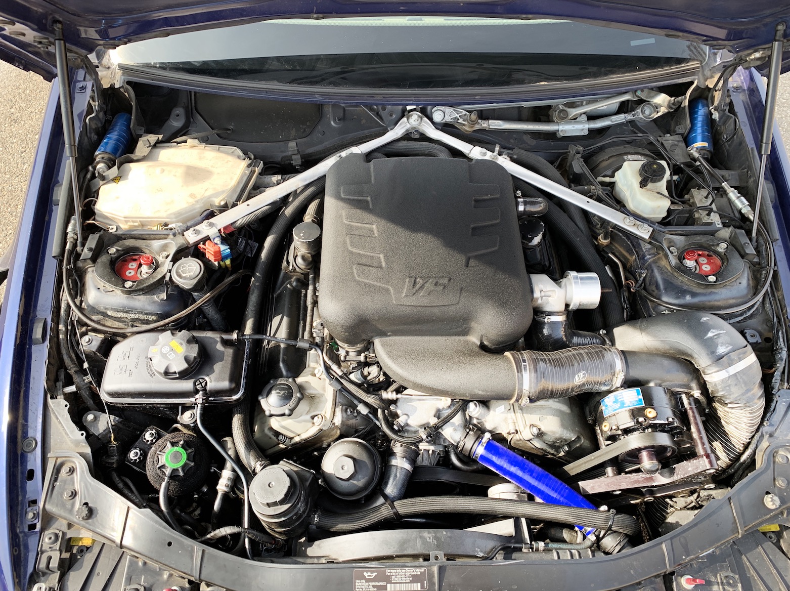

Came in, opened the hood, and the VF upper coolant hose was leaking.....argh. I got on the phone with Steve from EAS. He recommended adjusting the hose clamp. I did that but not much changed. I ran the car a second time for a couple laps. Brought it in, opened up the bay-----still leaking......Because the system was so hot, I was hesitant to touch the hose, so I was trying to use a small mirror to look at the bottom side of the hose, but it was so bright out and there was so much glare, I couldn't see anything.
Someone suggested the 7's-Only Racing shop that was onsite at the track. So, I ran over there. They were nice. But there was a guy who was not an employee of the shop who was VERY nice and jumped right on my car. He immediately put his bare hand on the bottom of the hot hose and he said, "your hose is cracked on the bottom"...........argh!!! Brand new hose with a 2" split. I was very lucky----7's-Only had silicon tubing in the exact diameter I needed. Even though the VF tube had a unique hump in the middle of it, it did not appear that the hump was necessary. We used a straight hose and it seemed to be just fine. Ran it for 2 days without issue. I plan on leaving the blue hose there for the foreseeable future. I was told it was very high quality stuff. Better be----they charge by the inch and it was $96.
So, my transaction with VF was disappointing. Of the three items I ordered---air filter, s/c drive belt and upper radiator hose---the belt was the wrong size and the hose failed on it's first run.......yay, the air filter worked.......yay. Oh---and I'm out the $100 for the silicon hose from 7's-Only.....yay. BUT, on the bright side, the hose is blue! Makes my engine look totally aftermarket! Yay!.....
Engine bay with awesome blue hose----so HAWT: (I hope everyone can feel the sarcasm dripping here. At least the blue hose isn't dripping.....)
I would like to give a shout-out here to the guy in the race shop that jumped on my car because he was awesome and his business is interesting. His name is David Ferguson and he owns VeracityRacingData. He was at Buttonwillow because he was hired to do data setup on a couple cars in the race shop that day. I bought him lunch and had a great conversation with him. He is ALL about data collection, but is also very technical on all aspects of engine building, etc. His shop has a dyno, CNC machining and other cool toys. Very cool guy. If you have data needs, this is a serious guy to go to. And he couldn't be nicer. Before being in the car/data business, he was one of the engineers at Apple that integrated USB into the first iMacs. And he races. Did I mention he was cool?
So, the shakedown day was a true shakedown day. Aside from the leaking hose, the car was SOLID. Really enjoyed driving it.

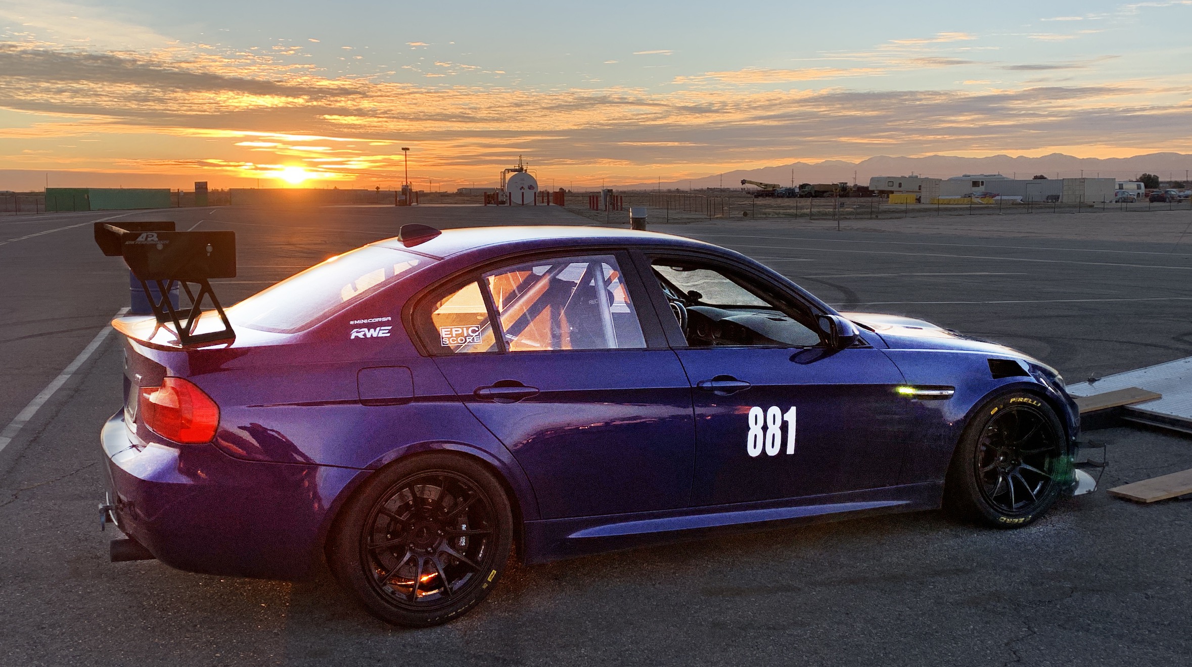

The sunrise on Sunday at Willow Springs was just beautiful. I rolled into the paddock at 6:30AM and my trailer was sitting there by itself with the sunrise behind it. Had to snap a pic of that!
And the car a little while later:

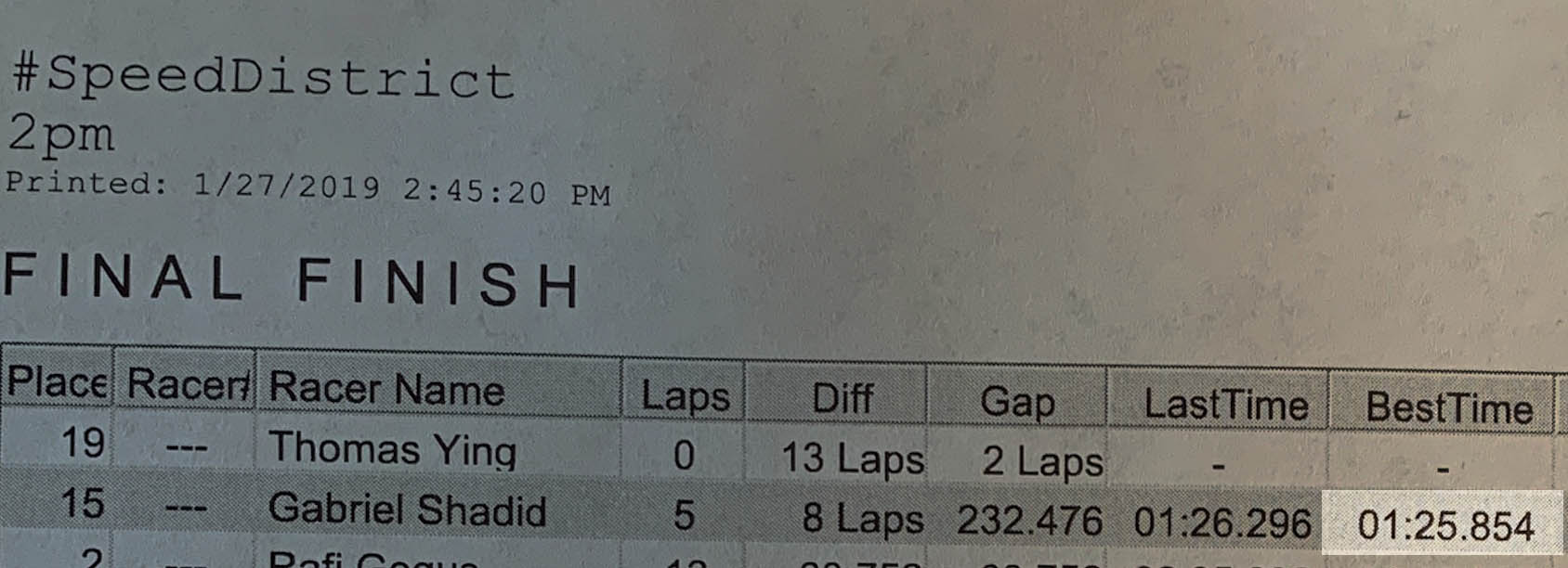

I decided to try something new. I never ever start the day with my best tires. I always drive a session or two on the lamest tires I have and then go for it on better tires later in the day. But I thought, I just drove a solid day at Buttonwillow, why not try going for it at Willow Springs on the first session? uh huh......MISTAKE!!!!!!! Oh man.....I had no chance. Drove like crap. So, I was burning the best tires I had for no reason. Nothing was at stake, so it was no big deal, but man, it was terrible. So, I REALLY stand by my operating procedure of running worn tires first and then put the good stuff on later. The only time I might not do that is when I'm at the same track for 2 days. I can see running good tires at the beginning of day 2. I know it's tempting to run good tires in the cool morning air. But on my end, I really need to get into the groove of a track before a fast lap is possible. If you have more than one set of tires, run the crappy ones first. Then move onto the good tires.
(Amongst all of this, there was an unknown element at Willow Springs-----they put a slurry coating on the track surface to freshen the look of the place. It also looked (and felt) like they filled the cracks in the pavement with tar. The tires were not liking the tar bumps. Made the suspension feel like it was really rough. Some people were saying there was less grip due to the coating. After driving on it, I don't think there's any difference. By the end of the day, some of the new tar in the cracks was lifting out of the cracks as cars drove over it......Willow Springs is in dire of a repave that I'm afraid will never happen......)
Anyway, by the 3rd session, I ran a 1:26.2, so I was getting in the groove, but the tires were suffering. I was jamming into Turn 2 and the tires would not hold the car. I couldn't go any faster. On the 5th session, they corded. In my opinion, Willow Springs is the most brutal track on tires that I have ever seen. I was rotating those tires and it didn't matter. If you're going fast, the left-side tires get punishment like almost nowhere else. You can feel the tires grinding in Turn 2. It's a long high speed (90+mph) uphill rounder and when going fast, the car is almost in a mild drift. It's cringe-worthy for the tires. (Even worse than the right side on the oval at Auto Club.)
So, now I had two corded sets of tires. One set left-----a marginal set of scrubs that were just ok. (I had taken these off at Chuckwalla CCW at Bimmer Challenge to put on better tires.) So, I swapped them on, and was in my car and ready to go out on track at 1PM, and my friend rolls back in the pit and says that a Corvette just blew his engine on the entry to Turn 8.......oil everywhere......ugh.
The track sat silent for quite awhile as they dealt with it. I was sitting there thinking that it was going to be impossible to hit a new best with oil and powder on the entry of Turn 8, and who knows if these tires had anything left in them. I was bummed.
2PM rolls around and the track is active again. Time to give it a shot. Saw the oil spill on the warm up lap on the entry to Turn 8......not great, but I wondered if I could still work around it. So first hot lap, I jumped into Turn 2. Turn 2 is where you learn if your tires are good or not. If they hold, you have a chance. If the car starts washing out in Turn 2, the predictive lights on the AIM Solo 2 DL will punish you immediately and you know there's no chance. So, I dive into Turn 2----and the car is holding! I get all excited and keep driving hard. I just skirted the edge of the white powder going into Turn 8----not ideal, but felt better than going over that crap at 140+mph. As I exit Turn 9, the AIM has 5 green lights on the sides of the display. This means that I'm at least 0.5 seconds faster than my 1:26.2 from earlier in the day, so I knew I had a 1:25-something. But I gotta tell ya, it's a LONNNNNG run from the exit of Turn 9 to the Finish line. I was like 'Come on baby!!!!! Let's goooo!!!!!" And it was a 1:25.85. phew. So, I looked up at my GoPro in the rear view mirror-------and the battery had died! argh.......it died like 10 seconds into the warm up lap......not even a chance. I forgot at a Speed District event that you drive so damn much that you absolutely need to change the battery at lunch. And to be honest, I wasn't that hopeful going into the session, so I wasn't worried about video. So, I came back into the pits and swapped batteries, figuring I could do that lap time again if the tires would hold. I went out and rolled a faster lap going into Turn 9, but got hung up by a Mustang and lost a 1:25.5......I do have that on video. At that point, it was time to get packed up and get to the airport. I am now convinced that the car can do 1:24 on good tires (once I'm in the groove.) But honestly, I have no plans on showing up at Willow Springs with fresh slicks. They'd be corded in a single day.....

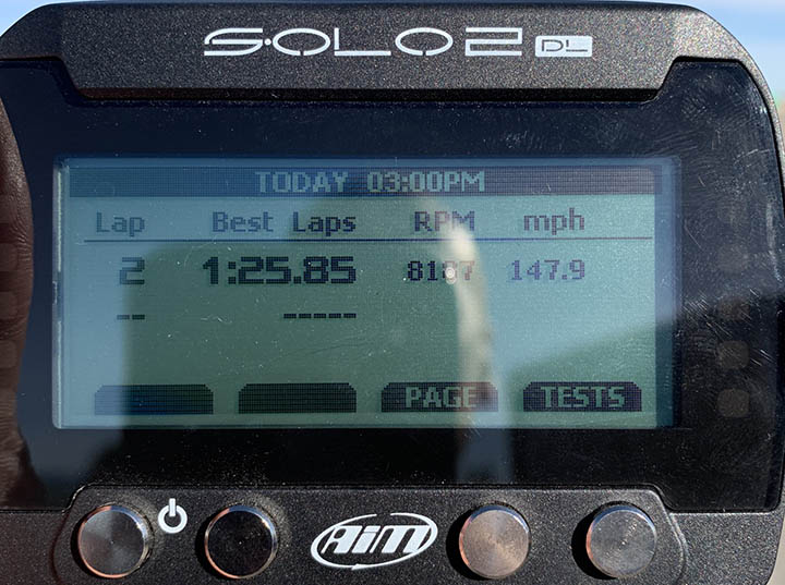

The AIM Solo 2 DL continues to prove it's accuracy. At times, it was exactly the same as the transponder. Pretty cool:
