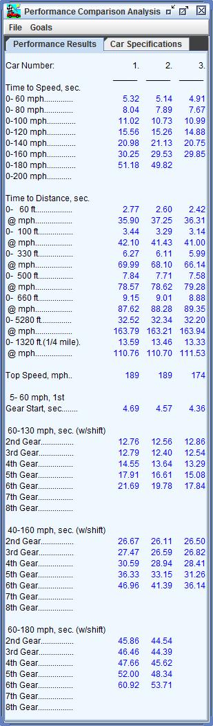

Originally Posted by sterile stork View Post
Wow! Thank you very much. I most certainly didn't expect for such extensive research as that, but sincerely appreciate the thought and would be delighted to see the comparisons!
Here's a simulation of different performance based on final drive and keeping everything else the same.
The dyno chart used in this test should be pretty similar to you (give or take).
  • 371whp, 271wtq
  • BPM Stage-1 ECU
  • RD Sport Underdrive Pulley
  • Macht Schnell Stage 2 Intake
  • Both CAT Delete
  • Akrapovic Evolution Exhaust System (Titanium)
  • 91 Octane (US), 95 Octane (RON)
  • 6-Speed Manual Transmission

Originally Posted by regular guy View Post
Again, although accurate absolute performance levels are not a prerequisite for accurate A to B comparisons for things such as a FD mod, I'm still curious about the overall low levels of performance here. 0-60 in 5 seconds and 13.3-13.6 1/4 mi times. These are substantially lower than most magazine times and lower than my CarTest results using crank power and 12% or so total losses. Any idea why these sims show such underperformance?
E92 M3 | Space Gray on Fox Red | M-DCT | CF Roof | RAC RG63 Wheels | Brembo 380mm BBK |
Yeah, I based these results on my slow shift speeds and my fat ass in the cockpit with a half tank of gas. I'm sure the magazines shift substantially faster than I do, and that could easily be 0.4 second difference right there on a 0-60. There's also weather conditions which affect power output; but not sure how much difference that would make because I didn't model it. Tire size was heavier 19's in this simulation. What do your simulations show for these same results?
Last edited by regular guy; 04-02-2014 at 02:28 PM.. Reason: Should be: half tank of gas...
I use a 0.3 second shift time for MT, 0.05 for M-DCT. My weights are 3581 for MT and 3626 for the M-DCT (less 165 for driver). Losses are 12% total. CarTest does not do a wheel weight calculation based on wheel size. Here are my MT and M-DCT results which correlate well with the best (or near best) magazine times.
I don't really see a need to run the changes to the FD as the delta's will be pretty well identical to yours.
Those were the days.
It seems we repeat many topics, but to new audiences.
  • 371whp, 271wtq
  • BPM Stage-1 ECU
  • Both CAT Delete
Sorry if I am absolutely blind (I swear I have looked at the entire post, but I have my moments), but could you specify what FD each of the columns of data represents?
Cheers,

Originally Posted by srmast1 View Post
I know of this product through Turner, but isn't there an OEM 4.1 gear set as well?
Ten-years ago, I installed the Dinan 4.10 in my E-92. It's wonderful through the gears, not making 1st too short, but adding oomph, particularly in 2d and 3d. I used to autocross a lot and it's the perfect setup for that. There is noticeable noise on the overrun, but not too much for most. My wife never complained about it, so it passed one critical test in that regard. It's still going strong, ten-years and 85,000-miles later.
Dave

I've always wanted to do this and every time I cruise on the highway for any extended period I am cured of it and start wishing for a tall 7th gear with a shorter 3-6 gearset, but that's called a DCT and I don't like the downsides that come with that, soooo oh well
