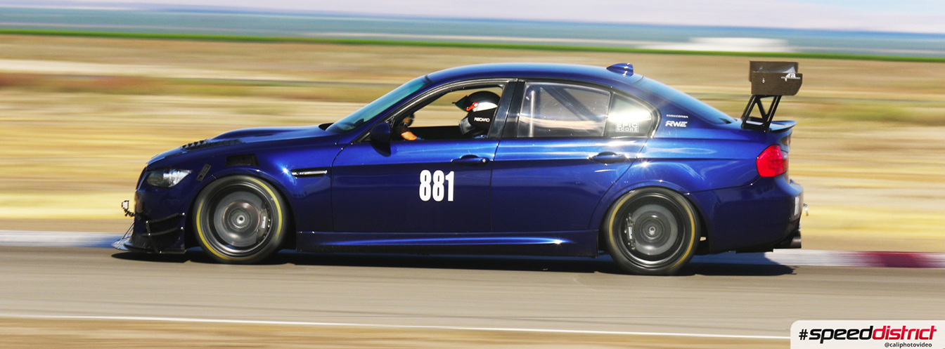

Let's file this one under: YESSSSSSSSSSSS!!!!
I wanted to get a quick update in before I have to run out the door for Bimmerfest this AM----I am very happy to report that the Slon-Workshop DCT Oil Pan seems to have fixed my DCT shifting issues!
I went to Buttonwillow yesterday to shake the car down after the big round of maintenance. I did not have a single shifting problem all day--no auto upshifts, no double upshifts, no refusals to downshift, no shifting into only even gears or odd gears, no nothing. The shifting just worked fine all day long. And I had some laps in the 1:48's and 1:49's.

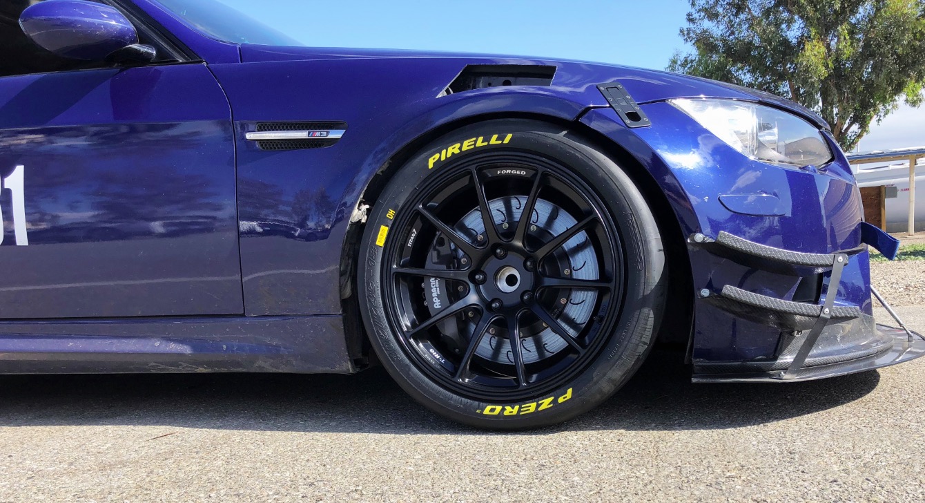

I am very impressed with the Slon pan. Perhaps just one track day is not enough to make a full conclusion, but it sure went darn well. (Actually this was day 2, but I only had 2 sessions on the first day because of the hub issue.)
I also liked the new Titan 7 rims. Felt good.
The track photographer got a nice rolling pan shot of the car on the new wheels. It's cool how the black wheels sorta disappear.
Today, I'll be out at Bimmerfest at Auto Club Speedway. Looking forward to seeing everyone and having a fun day!
Appreciate 8

That is such good news! Thank you for the update
Good luck at Bimmerfest
Lets see how the dct keeps holding up. This is really a big deal, an actual solve to the dct issues that have plagued this platform

Good to see the Slonik pan and Titan 7 wheels are working well, congrats!!

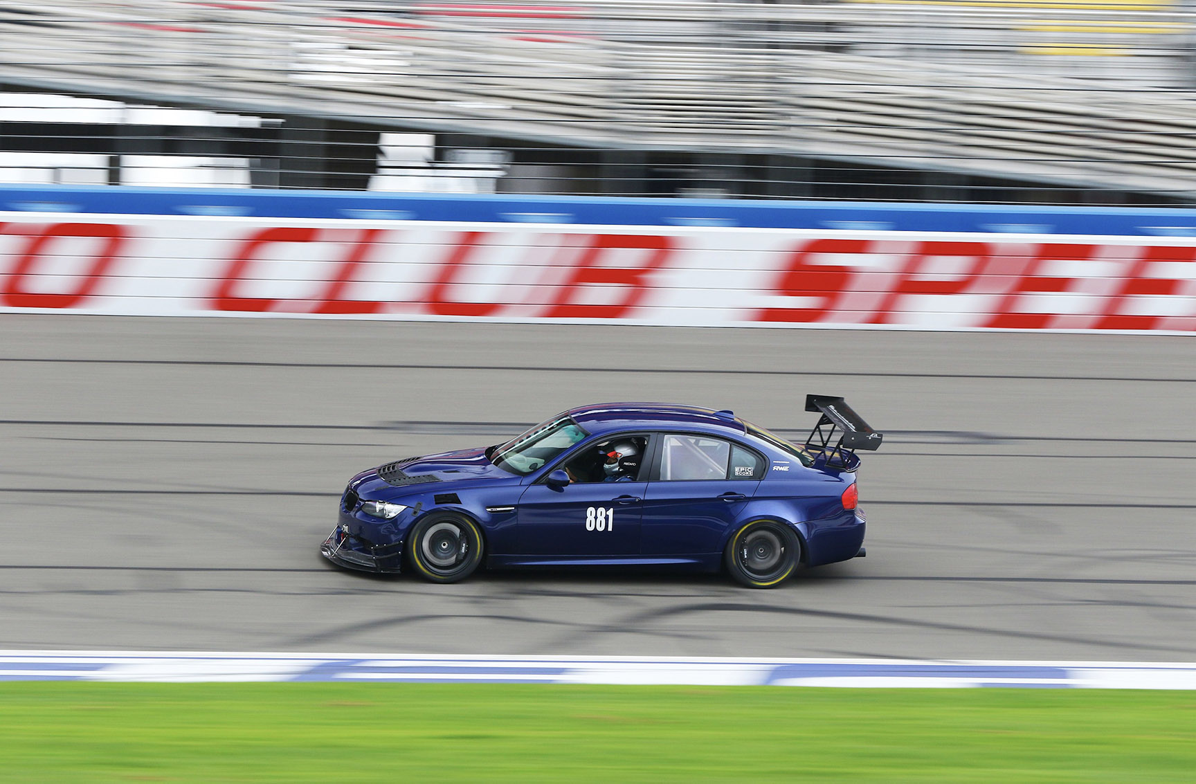

So, car has gone through another hard day at Bimmerfest at Auto Club Speedway. And-----no shifting issues!! This is now three days at 3 different tracks and not a single missed shift or double upshift:
1. a short day at Big Willow. Ran a new personal best so the forces were high, but the day was short because of the hub problem. No shifting issues.
2. Solid Buttonwillow day. Drove a good number of laps. Had fresh, high grip tires. No shifting issues. I ALWAYS (did I mention always?) had problems at Buttonwillow.
3. Solid day at Auto Club Speedway. Had very fresh, high grip tires. Bought two run groups, so I ran a lot of sessions. Drove the first 80% of the course faster than ever, but they changed the course by putting up a tire barrier in the Playground near the end which slows you down, so I didn't set a new faster lap. No shifting issues.
I am very very happy with this Slon DCT pan. I just don't know what else to say.
That is impressive
You should open a thread in the engine/drivetrain section. This is a big deal, these issues have plagued many members and slonik has actualy solved them.
You've got to spread the word. There are so many aftermarket parts for our cars that do *absolutely* nothing. For one that does...

Thanks. Yeah, the car is feeling good. I'm enjoying the new look of the car. And I'm very happy to not be having shifting issues.

Bimmerfest and Bimmer Challenge took place at Auto Club Speedway on Saturday. The weather was just incredible for the end of May. Temps stayed in the 60's and it was cloudy most of the day. Could not have asked for better conditions.
The Bimmerfest show brought out thousands of people. My paddock spot was between the vendor booths and the food trucks, so with all the foot traffic, there was a lot of people checking out my car all day long. Everyone was very friendly. I really do enjoy the general camaraderie of BMW enthusiasts.
Bimmer Challenge was interesting. I was told that I won my B1 class, but that's all I know. There was some confusion in the AM because Speed Ventures seemed to have issues with the timing system. These days, Speed Ventures usually posts times on the Race Hero app which is very handy. But, there was some issue and they weren't doing that. And they weren't printing times for awhile. Some people were saying that they didn't capture the times, but that was incorrect. As a result, no one knew what anyone else's times were. Later in the day, some times were being printed, but it was still messy. Ultimately, at the end of the day, they were not able to hand out all the prizes because the timing issues prevented the Bimmer Challenge organizers from getting a final printout of times.
I had a weird tech issue on Saturday. I have always had weird tech issues at ACS---blown fuses that cut the engine off, misting system malfunctions......just weird stuff that doesn't happen anywhere else. On the second Red Group session, I was on my out-lap, I exited the pits, touched the brakes for the first turn, and a bunch of water---like half a gallon---lurched up through the hood vents and splashed on my windshield. I was like---WHAT THE------??!!! Then, every turn, I was gliding and sliding.....what the hell? I took the rest of the out-lap slowly because I was slipping through the turns and worried about the car. (Apparently, in the driver download meeting after the session, people were pissed that the out-lap pace was too slow.......sorry everyone, I had a tech issue.) So, I pitted immediately, looked under the car and water was dripping everywhere. Someone looked under there in the hot pit and thought I blew all my coolant. I pulled the car into the paddock and water was still dripping away. Since the car didn't get hot, I was able to open the coolant reservoir----totally full. I opened the supercharger cooling intercooler system----totally full......The misting system on my car is fed via the windshield washer reservoir. The cap to the reservoir was open. Did all that water coming spewing out of there? It must have, because it was virtually empty. But why did it belch all the water out the top at once just because I tapped the brakes?? How the heck did it even do that? I wasn't going fast. I just came onto the track. SO WEIRD. Casey from Racewerkz came over and looked at the car and said it looked fine. I got back out the next session and the car felt fine and I ran my best of the day.
Regarding my lap time----I was disappointed that they changed the course slightly by adding some tire barriers to the Playground near the end. This slows the lap down just a bit because you specifically have to go around a new barrier. In the past, you could just carve your own path through that fairly open last part of the Playground ground section. So, I guess we have to consider this a new configuration......I ran 1:43.8 with this new tire barrier. (I haven't made a video yet. I'll try to do that soon.)
I had my passenger seat in this weekend because my brother-in-law was visiting. He had never been to a track, so I had the seat in so I could give him a ride. I ended giving several people rides over the weekend. The biggest reaction I got from everyone was regarding the braking force. Cornering grip and acceleration and overall speed didn't interest anyone like the braking did. Most thought that there was no way we would make the next corner.....hehe. (A couple weeks ago we were talking about braking in this thread, and I'm almost done writing a post about that with some charts. I'll post it soon.)
The car overall ran great both days---Friday at Buttonwillow and Saturday at ACS. The new hubs, new wheels....all that stuff came together nicely. Again, I'm really happy with the Slon-Workshop DCT pan. Such a relief to not have shifting issues all the time.
On a personal note, our family is moving from California to Colorado in a couple weeks, so this past weekend may have been my last track days as a CA resident (unless I do GTA on Sunday, which is doubtful.) I've been living in Los Angeles for 20 years. I can work from anywhere, so we're making it a life adventure to move to a new place.
I will leave my E90 M3 track car in CA for now, so I'll fly back and go hit the CA tracks with my buddies. You CA guys haven't got rid of me yet!!! There's still plenty of things to try at CA tracks! (I still wanna try slicks at Sonoma and Thunderhill. Really looking forward to that.) In CO, I do plan on taking my E92 M3 street car to High Plains Raceway and checking that out. I have my old AP brakes that will go on the E92, I have a set of 9.5" square track wheels with DH scrubs on them, and I had EAS put the CAN bus connection for the AIM in that car, so it can go out and do some fun track days.
On another personal note, I am blown away that my little build thread is approaching 100,000 views. (99,970 at last look.) I guess in the next day or so, it will cross the 100k mark. When I posted pix of my build in 2015, I had no idea the thread would turn into such a long running thing. I want to thank everyone who has taken the time to participate in this thread up to this point. I have enjoyed it immensely. I hope it's been useful and fun for those who have checked it out. I plan to continue writing in here, but the next couple months may be a bit quiet due to the move. (As I mentioned above, I will post about braking characteristics soon.). I do have an interesting project planned for the car this summer......something to make it lighter. Once it really gets going and becomes a real thing, I'll start posting about that in here too.
Anyway, I found a couple more cool pix from the track photographers on Saturday:
