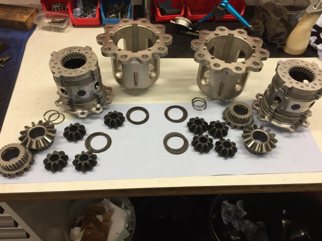

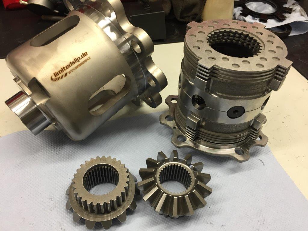

i recently did some modifications on drexler gt3/gt4 setups to improve durability and get a smoother reaction.
the amount of high performance drilled clutches remains untouched but i realised to add some slight preload and (depending on application) individual ramps... steeper for street, more shallow for pure racing.
here you see the weight-optimized core on the left and the GT internals on the right:
two units in the making:

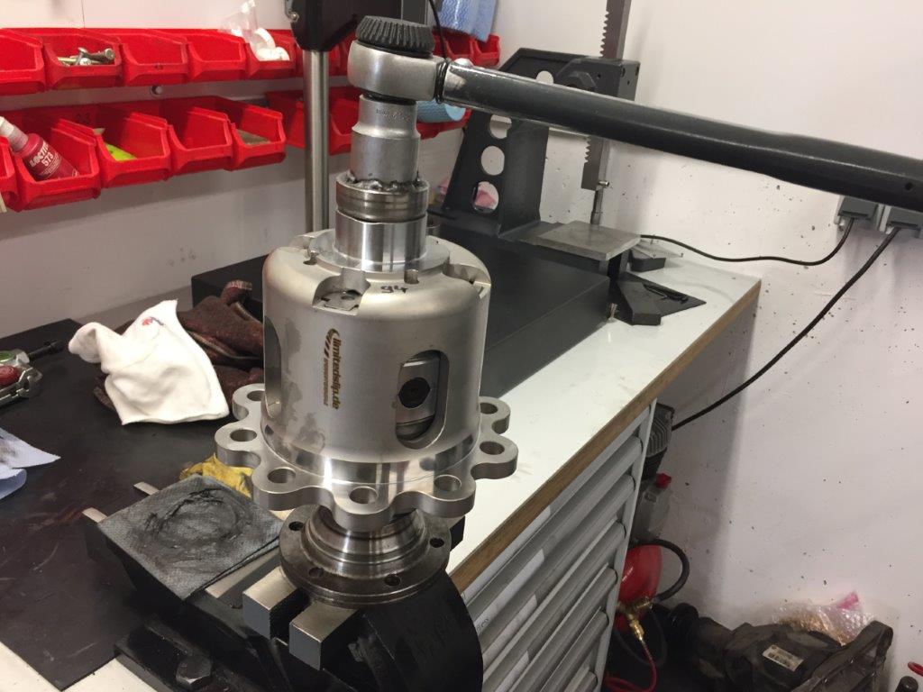

final check of the breakaway torque before these two units will be shipped one to the states and one to taiwan:

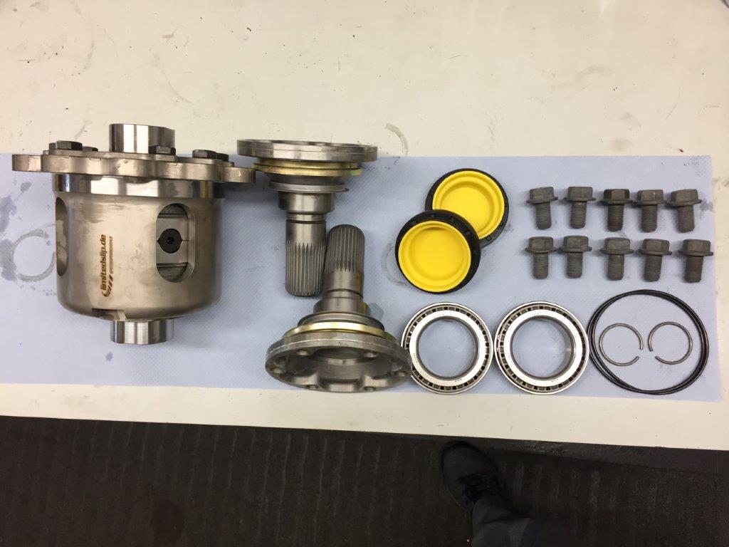

this is what most customers will need to perfectly install this unit:
these internals are also used at bmw motorsports for the brandnew m4 gt4... only the lsd-case is different to fit into the new m4 diff carrier. i am building a few m4 diffs at the moment as well... will post some pics here when i am done.
