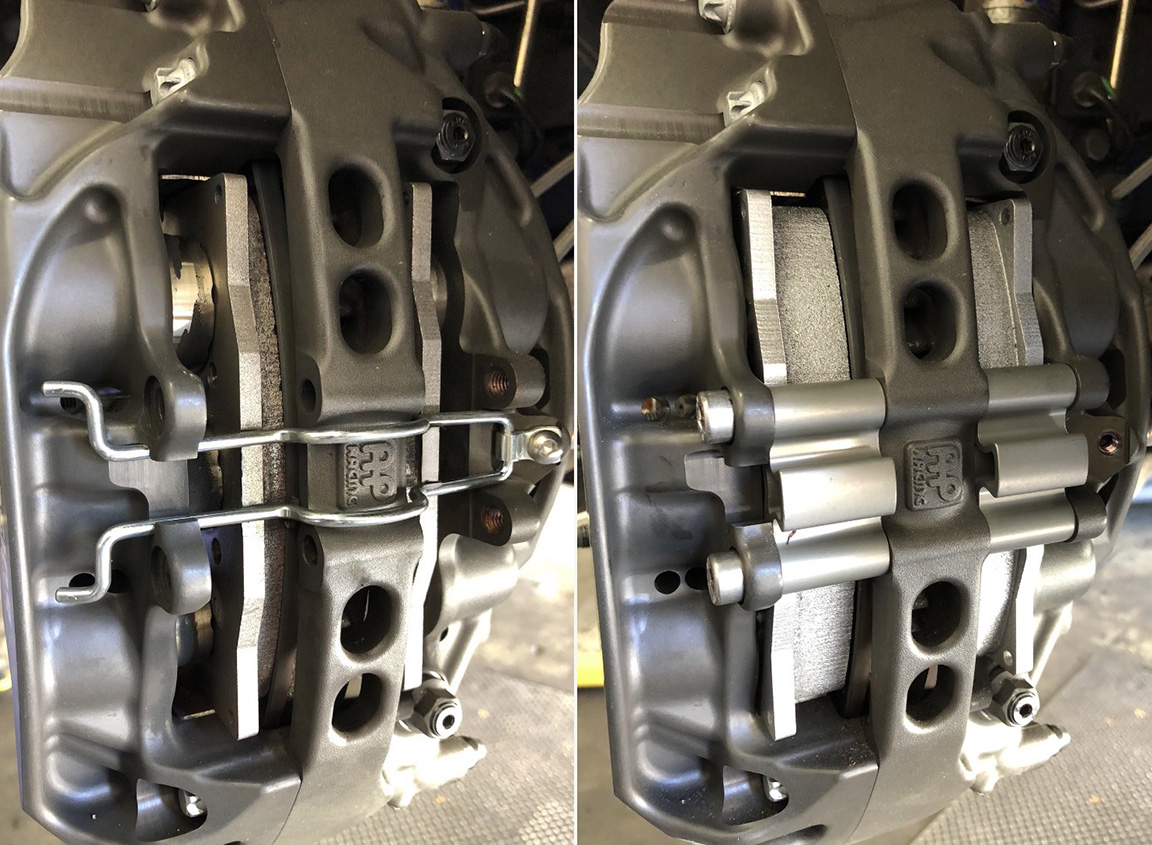

In a previous post on the 9668 Essex AP kit, I was talking about the Quick Release bridge clip versus the bridge bolts and block spacers. I had the Quick Release setup in there, but when I switched over to the new 25mm pads yesterday, I removed the Quick Release clip and put the bridge bolts and block spacers back in. I like the sturdiness of the bolts and spacers. Let's see how that goes.
Here's how the two setups look:
One other installation note: I was not able to move any pistons with my hands. It required using my orange GiroDisc pad spreader to press them back into the caliper. Even with the GiroDisc, this kit is so wide that the spreader can't push on just the backing plates to push the pistons all the way back. The spreader just doesn't go that wide. I had to push on the inside faces of the semi-worn pads to push the pistons all the way in. I'm going to keep those semi-worn pads around as a piston-pushing spacer in case I run other pads too narrow and the spreader can't push far enough. I'm glad I pulled these out now because they're the perfect thickness to push the pistons all the way in. I used to be able to push the Stillen AP kit pistons with my hands without issue. I could not get any single piston to even budge with my hands.....(I was told later that perhaps opening the cap of the brake fluid reservoir could make it easier, but I've never had to do that before.)

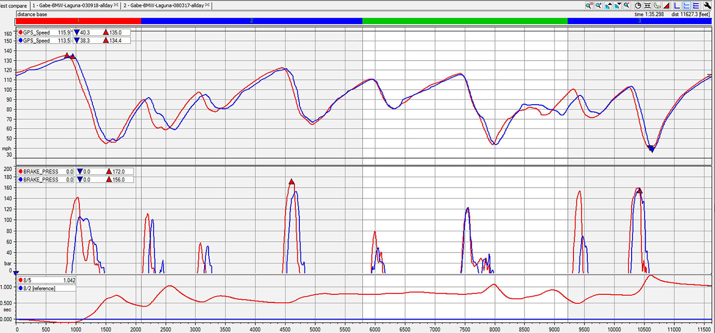

The following AIM chart compares my fast lap from last August (1:34.3 in Blue) and my fast lap on Friday (1:35.3 in Red). The top chart shows my GPS speeds. The middle section is the brake presses. You can see how far down the track I press the brakes and how hard I press the brakes. The bottom chart is the time difference between the two laps. As the Red line moves up, the Red lap is getting slower compared to the Blue lap. As it moves down, the Red lap is getting faster compared to the Blue lap.
Starting with the middle chart, looking at how I pressed the brakes——in every braking zone on Friday, I braked early. The Red lines from Friday start to the left of the Blue lines from August, meaning that I was braking earlier on Friday.
Before diving into the chart too much, I want to take a moment to explain how I look at net losses or gains over a complete section versus just looking at a single moment and dwelling on that. When comparing one lap to another, I don't think it's fair just to look at a braking zone and say, "look how much time I lost when I got on the brakes early here." It’s more involved than that because getting on the brakes early usually means that you can also get onto the gas early, so the time it looks like you may have lost might be gained back by getting on the gas early. So I like to look at, not just the braking into the corner, but also the acceleration all the way until the next braking zone. That way, you can see the complete effect of all your actions. I think this is a more accurate way to judge overall gains and losses of time.
One other setup note: The car was accelerating very well on Friday in the 55ºF air. In August, it was 77ºF during my fast lap. This helped cover some of my early braking woes as we’ll see in Turn 4.
-At 840 ft when I touch the brakes on the Red lap - The red lap was actually 0.1 sec faster at the braking zone of Turn 2 thanks to the cool air and great acceleration. But I get on the brakes early (90 feet earlier than the Blue lap) and the time delta of the red lap shoots up, and by the braking zone of Turn 3 at 2100 ft, my net loss is 0.5 sec. Argh! Now if you were just to consider the braking zone of Turn 2 by itself, I lost 0.85 sec, but then I gained back 0.35 sec on the earlier acceleration out of Turn 2. You could also say I over-slowed for Turn 2, but it was not grippy there, so that slowing may have been necessary due to a not ideal track surface.
-Turn 3 - At 2100 feet, I again press early and by Turn 4 braking zone, I've lost another 0.1 sec.
-Turn 4 - Again, I press early, but the strong acceleration in the cool air covers that by Turn 5. No loss. Again, another over-slowing here too.
-Turn 5 - at 4400 ft, I braked early and too hard. Over-slowed the car. On the speed chart at the top, you can see the Red line dips below the Blue line at 5000 ft. From 4500 ft of Turn 5 to the braking zone of the Corkscrew at 7400 ft, I lost 0.3 sec due to starting from a slower speed and babying the throttle. It would have been even worse in warmer air.
-Corkscrew up to Turn 10 braking zone - I was experimenting with different lines going into Turn 9 and it seemed to pay off. I actually did better here than last August and picked up about 0.25 sec by the braking zone of Turn 10, but then I brake early and too much.....blah....just no confidence in the pavement....or the car…..or the tires…..or myself I guess….hehe
-Turn 11 - This zone wasn't dirty, but I just wasn't going to try to kill it here because I hadn't been killing it anywhere else, so I lost another 0.3 sec by the time I got to the finish line. In looking at it, I'd say the pavement is getting wavy in Turn 11. In the montage below, you can see the change in the pavement since last August. You could see the uneven tire markings just slightly last year, but on Friday the undulations in the pavement from the tire markings were quite clear. This also did not encourage me to brake really late going into Turn 11. When looking at minimum speeds in Turn 11, in the top left corner of the chart where it shows mins and maxes, you can see that I actually picked up 2mph at the apex of Turn 11 (38.3 vs 40.3mph). That's cool!
So, looking at this chart confirms that my conservative approach to braking resulted in most of the time losses. No surprises there.
(It's also worth noting that I was braking harder on Friday in most places. This seems to be in line with what I've been seeing with the new calipers on the front. (Although braking harder AND earlier is not the recipe for success......))
Unfortunately, I do not have any video from my 1:35.3 lap……my bumper GoPro has been shutting itself off and I somehow missed recording this particular session with my in-car GoPro…..*one more sigh*……
