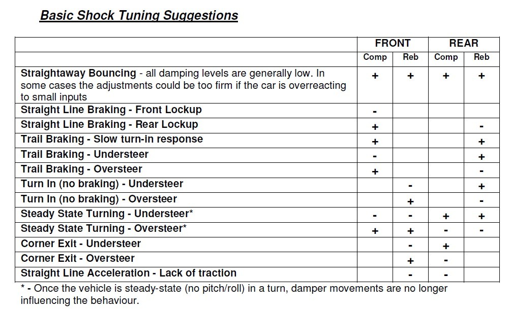

In terms of setup, this is very basic, but for double adjustable, it works. I use another one that is more detailed, and it just takes guessing game out, and I find you can tune the car quickly.
Bilstein Trouble Shooting the Car at the Track
If your car is:
Loose (Oversteer) from 0° to 90° (Corner entry)
• Increase compression rate on front.
• Decrease rebound rate on rear
Tight (Understeer) from 0° to 90°
• Decrease compression rate on front
• Increase rebound rate on rear
Loose (Oversteer) from 90° to 0° (Corner exit)
• Decrease rebound rate on front.
• Decrease compression rate on rear.
Tight (Understeer) from 90° to 0°
• Increase rebound rate on front.
• Increase compression rate on rear.
When analyzing corner entry, or deceleration handling,
realize that the chassis is affected by:
Compression rate in front.
Rebound rate at rear.
When analyzing corner exit, or acceleration handling,
Rebound rate in front.
Compression rate at rear.
