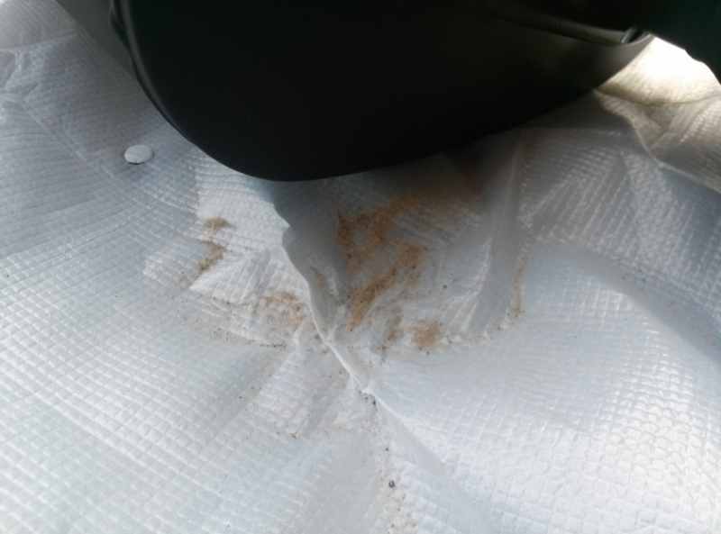

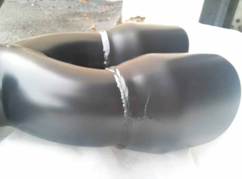

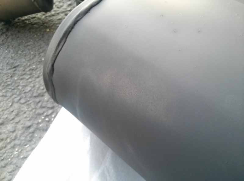

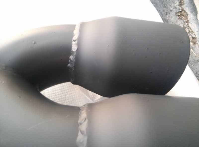

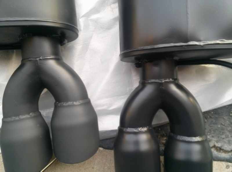

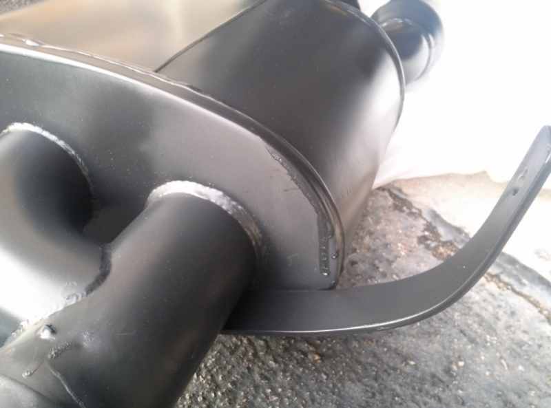

So here's the story about the "long time" part....apparently in Austin, quality welders are getting soooooooooooooo much work, they can afford to push small projects like this aside. Here's the novel. I feel like I should preface this post with "TL;DR".
After calling around and visiting a few metal fab places in and around the area (including places an hour away) and getting constantly turned away or being told 4-8 weeks, on
-6/21/14 I took everything to Custom Sheet Metal in Pflugerville, which is right outside of ATX. On
-7/2/14, Ron, the President of the company sent me an email saying that he's been getting slammed, and to come by the shop to revisit the scope of what I was asking for. On
-8/8/14 (more than a month later), he sent me an email advising me it was $237.50 for the cutting of the reducers and $82.50 to weld them to the cores, then said that the didn't really want to cut and weld the x-pipe. I called him and he said that if I was game, I could come to his shop and he'd allow me to cut everything and then tell him where to weld, and he would weld, at a rate of $125/hr. Mind you, when this was done, the rearmost O2 sensors would have to be moved. So, I told him I'd pick it up and cut the sections myself and bring them back to him to weld. In the interim, I had been calling other shops and found another, Lake Services Inc, out in Lakeway, Tx, (http://www.lakeservicesinc.com/) which is also pretty much on the outskirts of Austin. These guys do custom metal work, repairing boat docks and stuff underwater, as well as building boat docks, etc. On
-8/12/14, I dropped off the work for the x-pipe, and had them cut off the Corsa tips and weld on another set of tips. These guys rocked it out, and on
-8/15/14, everything was done. They cut out and welded in the cats, moved the O2 bungs, and cut off the old tips and welded the new parts in. 3 days to do what the other guy took over 6 weeks to do. Mind you, I told both places I was patient, which I was, but Walt and the guys @ Lake Services knocked it out. As an added bonus, I mentioned to Walt, the President, that I've always wanted to learn how to mig/tig, so he told me to drop in on Saturdays and he'll teach me, free of charge, and I can keep coming back until I feel I've mastered it. Awesomeness. My first Sat will be this Saturday, as my schedule has been kinda hectic. On that same day, I dropped off the rear section to Mike @ Austin Powder Coating (http://www.austinpowdercoating.com/) to Cerakote the rear mufflers and tips for $60/side. He advised a 20-30 day turnaround. I put $60 down with the rest due upon pickup. And this is where things get really screwed. On
-9/15/14 I sent him an email advising I'd like to pick up, and rec'd this reply "if no prob then the exhaust should be ready by end off day. but we will call you when we are done. thank you mike." Uhhhhhhhmmmmm, what? Alarm bells immediately went off in my head b/c a) why'd you wait until the last possible minute to do the work and b) why are you posturing as if there might be a problem? 2:47 that afternoon, I rec'd this (his caps, not mine): "JUST SHOT THEM. AM NOT TO SURE UNTIL THEY COME OUT OF THE OVEN. WILL KEEP YOU UP TO DATE. CERAMIC IS VERY TOUCHY WHEN IT SPAYS SO LIKE I SAID IF EVERY THING LOOKS GOOD I WILL CALL IF NOT IT WILL BE ABOUT 7 DAYS MORE." @ 3:23, I rec'd "Well i just pulled them out of the oven and am not happy. can you call me?" I did, and explained to him that the car was supposed to be ready for the BMW Car Corral @ the Continental Tire Series race being held that weekend @ COTA, and that I had a dyno appt that Friday that would have to be rescheduled, as well. Nothing he could do, he said. He'd run out of Cerakote, and would have to get some more in. They are hella expensive in the shipping department for some reason (I verified) unless shipping by ground. Fast forward to:
-9/19/14 and I get an email saying "exhaust are ready i will not charge you for the exhaust for waiting. but this is friday and we will be closing the shop at 1pm to day to go on vacation until tuesday." Mmmmmmmmm....I already paid a deposit, but whatever. I went to pick up the exhaust, and his employee is there. Everything is wrapped in plastic wrap to protect it, which is cool. I unwrap it when I get home and find this:
And the Coup de grâce
It would appear these guys didn't have the common sense to shove a rag down the exhaust to prevent sand from getting in there when they sandblasted it. As I turned the exhaust in my hand, you could hear sand moving around in the muffler. A LOT of sand. I kid you not, I poured out about a cup of sand per side. Needless to say, I was pretty pissed, and it was after shop hours. I fired off an email and rec'd this response on
-9/22/14 "The sand will blow out and that's no big deal, the color thing is. and yes i see the what you have point out, it was no charge to you and you can bring the back and i will reshot them." So I took them back, at the very least to have them sandblasted again. On
-9/26/14, this email arrived: "I have to let you know that the ceramic has not showed up at the the shop.I reorder new ceramic cause of the color in the last run. I have the tracking for the new ceramic and will be here on monday. They are sand blasted ready to go. I can refund the money or it will have to be monday after the ceramic comes in to be done & if all goes well. Sorry". In for a penny, in for a pound, at this point. On
-9/29/14 "it just dont want to work in ceramic by the two exhaust.it just want to run and be two colors. want to know if can shot in high temp flat black powder good up to 1200. you shound not see that high of temp ant the rear exhaust." Nope. Ceramic was what I wanted, not powder. I told him I was going to pick them up, so he sand blasted them again, and wasn't even there when I arrived. For having places like Elite Performance, BoostLogic and Cobb Tuning here, I can't figure out why there are no ceramic coating places around here. I got on the web and started looking for places in surrounding cities, and found http://acepowdercoatinggarland.com/ which is about 4 hrs from here. Turns out this guy is right up the street from Kenny Tran @ JoTech and does all of their ceramic coating. Score! On
-10/6/14 I shipped the rears to Jocko @ Ace and on
-10/13/14, I had them back. Somehow the tip on one of them rubbed off on the packing plastic (it looked scratched, but the metal wasn't scratched?) so Jocko told me to send it back and he's reshoot it so on
-10/17/14 it went back and I got it back, pristine, on
-10/27/14.
This ordeal has been a labor of love, to say the least. Biggest hold ups were the first machine shop and the first ceramic coater. Between them both, I lost over 2 months.

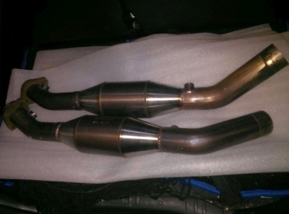

Now that I've had a few days to drive it around, I'll have to admit I'm pleased as punch with it. Although it is obviously a bit louder than stock, it is truly "loud" only when I want it to be.

Actually, no, and here's why: they don't make what I needed *lol*, which is a 100 CEL cat w/pre-welded reducers that have a small end diameter of 2" or smaller, which is what is needed for welding it to the the x-pipe.

A couple more pics of the before and after of the cats. You can see how far the downstream 02 bung had to be moved.
