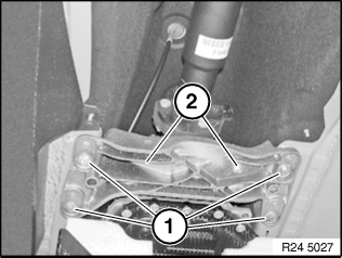

4. Support the bottom of the DCT with a jack and remove the DCT support bracket.

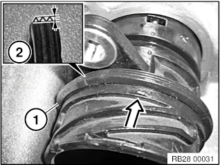

8. Insert the temporary protective cover over the exposed mechatronics sleeve electrical prongs (BMW part # 83300494213).
9. Thoroughly clean the exposed portion of the mechatronics' sleeve and the surrounding area. I used brake cleaner sprayed onto a rag to avoid over-spray onto the wiring or possibly into the DCT.

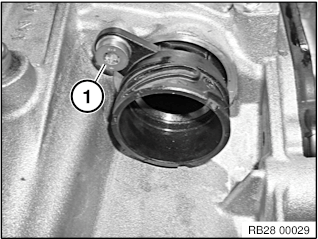

10. Remove the machine screw (T27) holding the mechatronics sleeve in place.

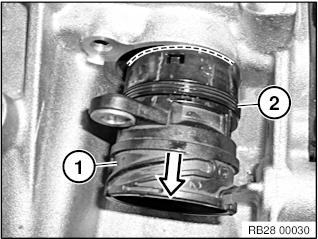

11. Pull the mechatronics sleeve out of the DCT by approximately 2 inches exposing the mechatronics harness O-ring.
12. Very carefully, using a pick or similar tool, remove the mechatronics harness O-ring by sliding it over the mechatronics sleeve towards you (towards the rear of the car). The O-ring is flexible enough to go up and over the "arm" that the T27 bolt sits in.
13. Place the replacement mechatronics harness O-ring on to the mechatronics sleeve back into the same location being careful to position the tallest end of the O-ring on outwards (towards the rear of the car). The new O-ring will stretch up and over the "arm" that the T27 bolt sits in without deforming.

How come the o-ring is on one side, in pic #11, but on the other side in pic #13?
cuz its mid-install, and highlighting make sure the orientation is correct before installing all the way.
