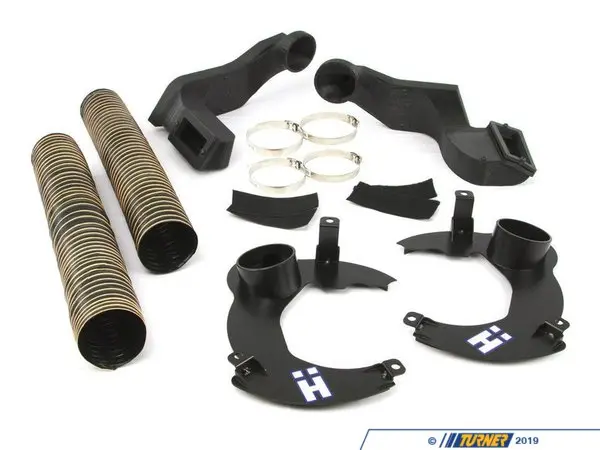

After reading many of the posts on this thread, and having once driven professionally for over five years (a while back), I thought I'd throw my hat into the ring here. In my experience, unusually high degrees of brake pad taper and premature wear are caused by multiple things, and all of them typically need some degree of mitigation, adjustment, or modifications:
1) COOL air goes a long, long way to helping all aspects of braking performance and keeping components cooler on track. Brake ducting (which is properly oriented towards the rotor center core) is paramount since the rotor is a vaned air pump moving air radially from center to extremity. Incorrect rotor direction of rotation exacerbates rotor heat build up, because rotors are typically directional i.e. left and rights. The E9X chassis is tight for adding ducting, but solutions exist. Start here:
https://www.turnermotorsport.com/p-3...it-bmw-e9x-m3/
