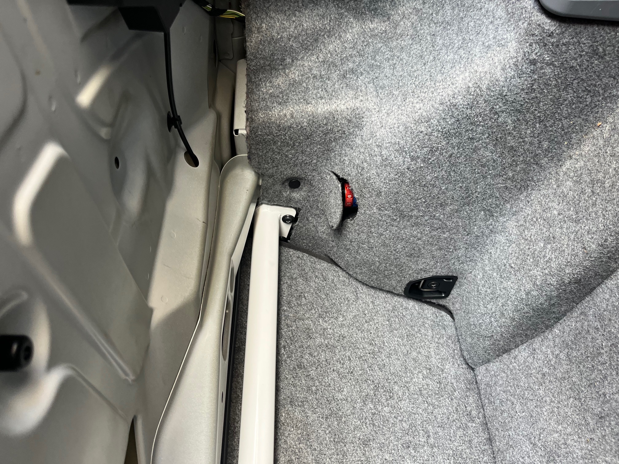

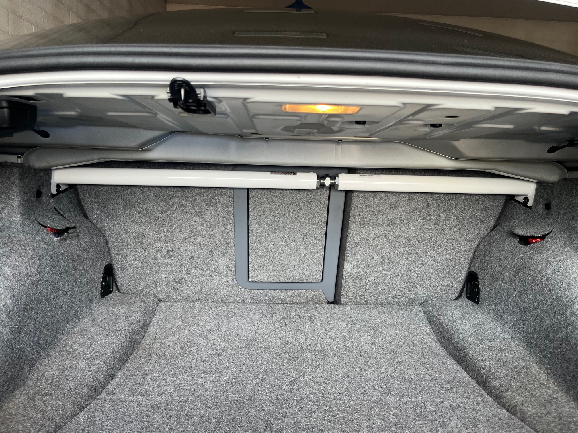

I've since updated some things on my car, to give it another small "upgrade" since it's last major update.
1. I sent off my Bilstein Clubsports to PSI for rebuild and re-valve for ideal control of the 850/1200 lb spring rates. Car def works better since the revalve, as I have a more useable full range. These rates are approaching 50% more than the baseline valving, so def doesn't hurt.
If anybody questions those rates for the track, I suggest you research the Ohlins TTX kit, which uses 800/1142 lbs rates for their kits (with stock rear contol arm). My rate choice is very good for a full interior/weight street car.
The previous 700/1000 iused was still pretty darn soft. Those Ohlins "Dedicated" kits need to update their spring rates.
I still have my Hotchkis bars front/rear, with front set on 1 off full soft, and rear to full stiff. I also added some Powergrid adjustable endlinks to remove any sway-bar pre-load.
2. I have added some small additional chassis bracing at the front/mid/rear of the car to tighten up things a bit more. After driving some new BMW M cars, you can really feel the effects of all that extra bracing on the chassis. These are all nicely engineered pieces that add some meaningful stiffening using all factory mounting points. The front factory strut brace is nice, but I always felt like it needed some triangulation to help a bit more. The Ultra racing parts are steel, which adds better stiffening without too much weight.
