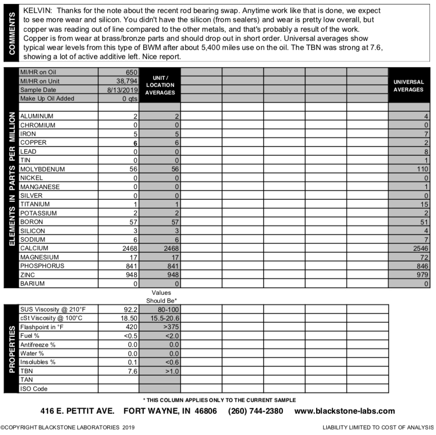

Hey guys,
New to the forums and have bought a 2011 MY last year from a dealership at 42k miles. Fastfoward to now 65k miles, I finally decided to do the analysis and was pretty surprised at the results (In a negative way). I know that only one oil analysis isn't suppose to say much or mean anything but mine just scares me a bit. I"m usually doing oil changes at every 5k but when I got the sample, it was at a 7.5k interval.
I just wanted to see your guys' take on this one just so I can know what to do. Thanks in advance. If I'm missing any info, please feel free to ask.
View post on imgur.com

Originally Posted by ATLm3LOVE View Post
Hey guys,
Iron and aluminum are quite high, all else look ok. Given this is your first report I’m going to guess that oil has been in there longer than indicated. Iron usual tracks to mileage and often aluminum does too. Other option is you have bimetal bearings near failure. The latter seems less likely with iron being so high.
Thanks for the reply. That would be scary if it's a bimetal bearings failure. Yeah I normally do oil changes every 5k. This sample was taken after about 7500 miles driven. Any thoughts on the copper content?
To me the copper looks ok and my guess is that it’s wash out from the oil cooler. That iron looks really high for that mileage though. Only thing I can Monday morning quarterback is shorten the OCI for a few back to 5K and trend it. Hopefully it ends up being a particle streak or dirty sample. Also,
ask BStone to re-run. Could be a lab error.
      08-23-2019, 05:07 PM   #1032
kcdedric
kcdedric's Avatar
773
649
Drives: E90 M3
Join Date: Apr 2011
Location: Norcal
Oil change after 650 miles on new BE bearings. Oil is BMW OE 10W-60.
