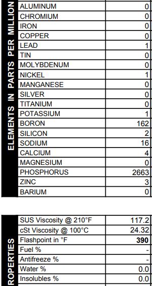

Here's a VOA of the recommended rear end oil for our machines. Search dparm's UOA from a couple years back on BITOG and note nearly identical results when excluding wear metals.
