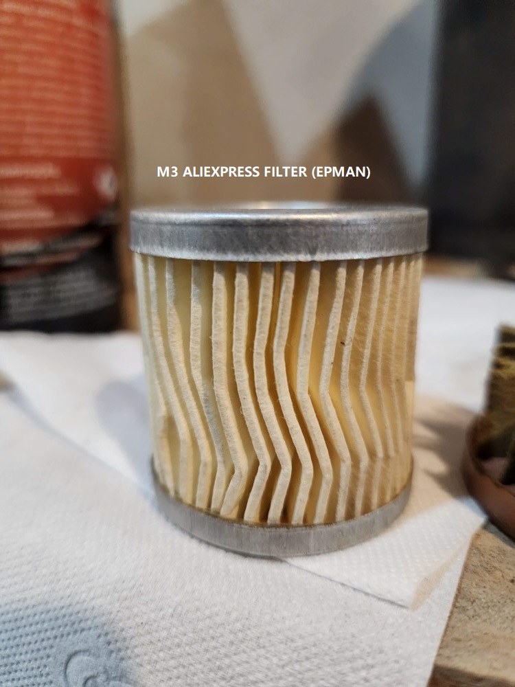

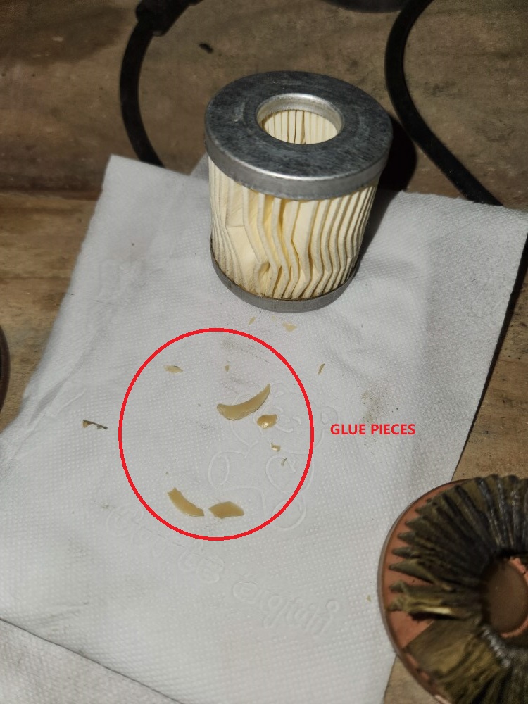

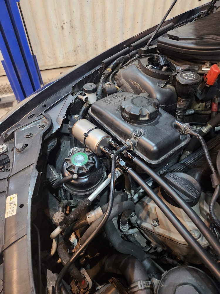

So, I went to change the filter because it's been 4.000km and when I was inspecting the inside, I suspected of the glue aspect and thought, "well is this glue good to be there?"
When I pushed it with the finger, it broke down in pieces. I mean, it was not dropping pieces yet, but I discovered it was very sensible to start dropping, for maybe a sudden pressure change?
Then I decided to crack open an OEM filter, removed my daily car filter for that (Toyota), and saw that the glue aspect is completely different, very clean and strong.
After that, I stopped the car and waited until my new alternative filter came in. The Hengst H490WK.
It's used in Volvo >2010 gas engines, supports 15 bar pressure and have quick release coupling.
By the way, the Toyota filter is very dirty because it has more than 20.000km on it and uses regular gas, while the M3 aliexpress filter is clean and had only 4.000km on it of top tier fuel (Petrobras Podium).

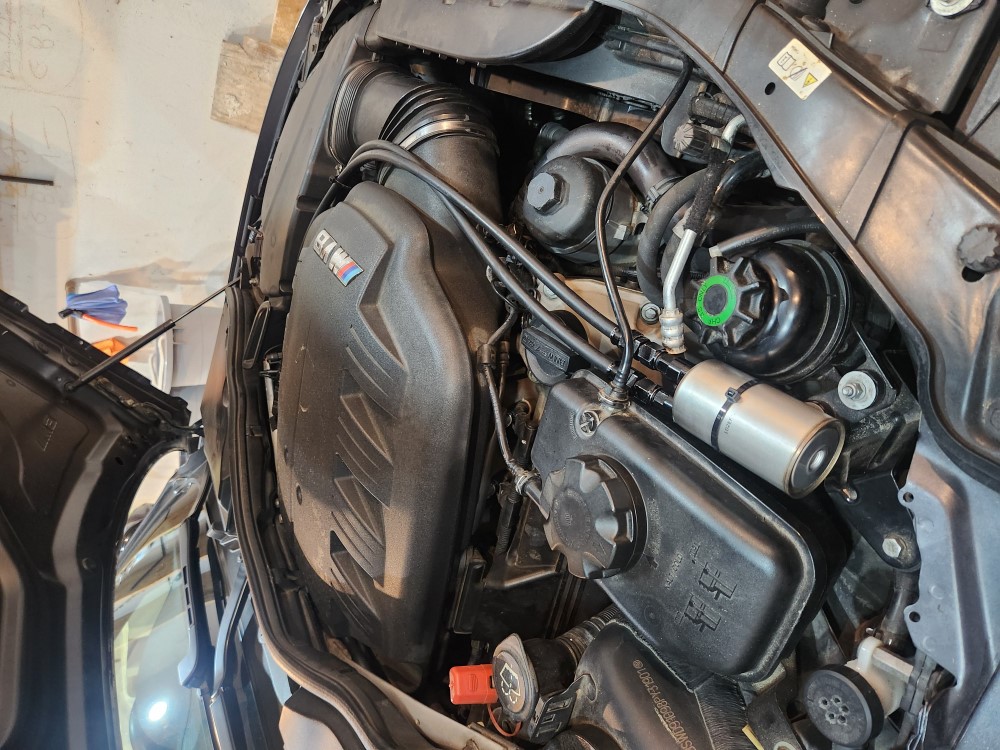

Originally Posted by BashBosh View Post
I'm back on the road. Replaced the other 7. Scoping and leak down were all fine - so I've dodged the bullet twice. I'll get oil analysis at next change as perhaps the road bearings got trashed (they are new bearings so perhaps the extra clearance saved me).
One other thing I've pondered after 2 consecutive failures. I have a tendency to run low on fuel and had recently gotten to a couple of refills at ~16gallons. I wonder if that is bad practice and dredging up stuff in the tank (of course the fuel filter should catch it I realize).
I'll be putting in the NRW filter in asap.
It's a myth that running low can somehow pull in more dirt, the fuel pump draws from a well (a recess) in the bottom of the tank anyway, so fuel is always being pulled from the lowest point (to prevent fuel starvation going up/down hills or hard braking or acceleration). Running low makes no difference to that.
If you actually run out of a fuel though, you could argue any dirt in the tank would get concentrated and drawn up in one go, that wouldn't be good! But bear in mind the filter will catch any harmful size particles (like you said). If the filter got saturated with dirt over time, then this would cause fuel flow problems under high load and RPM first.
I think the only real question mark about the filter, is that are they prone to breaking up as they get old?
That surely would've been answered by older cars? These types of tank filters have been around for over 20 years!
