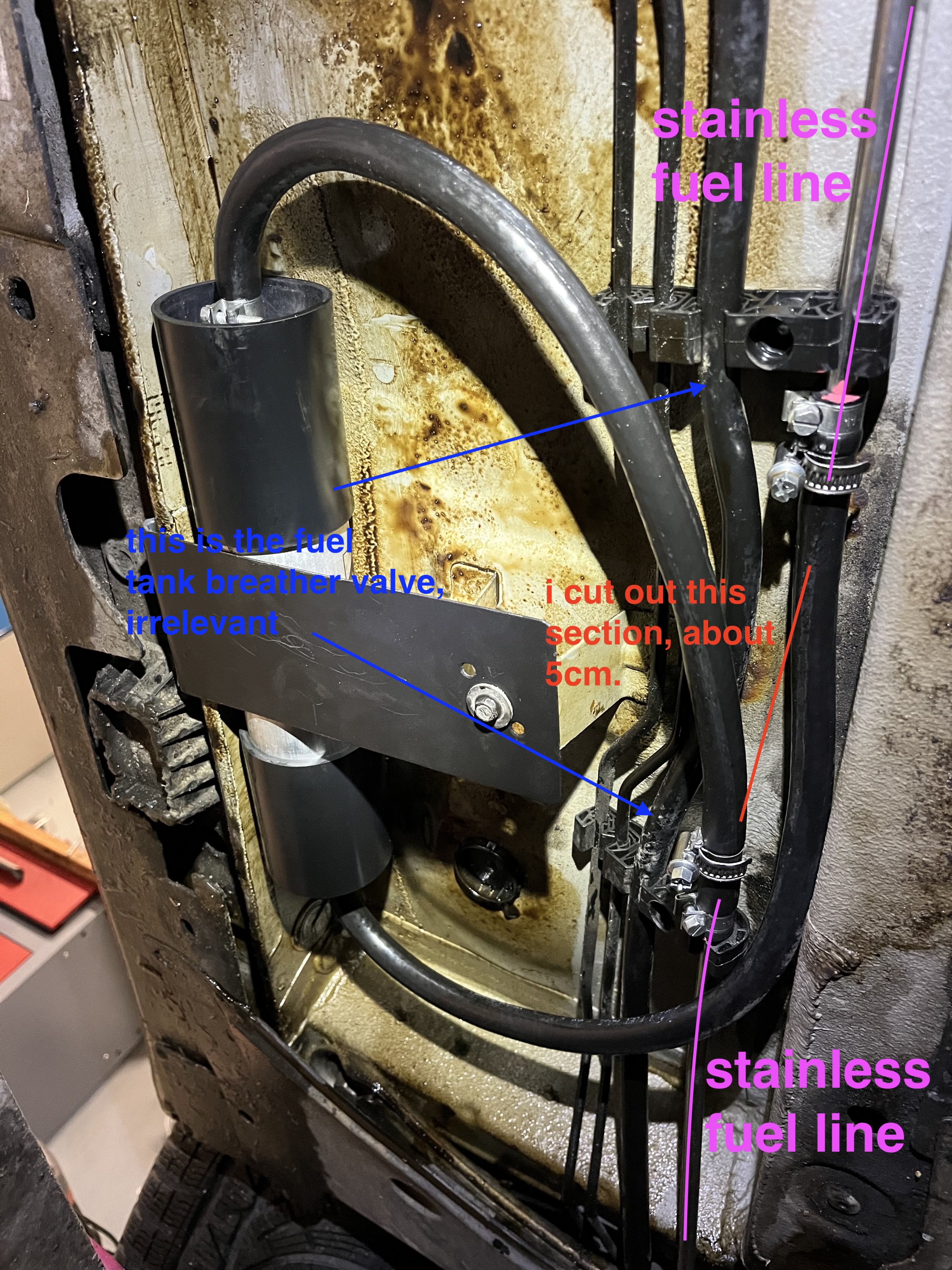

Originally Posted by andrihallik View Post
Recently installed e36 m3 inline filter on my 2008 dct e92 m3.
Have done 4-5 tanks now with some spirited backroad driving and with some high rpm winter fun.
Have not yet checked the fuel pressure or condition of spark plugs but overall cant see, feel or hear anything different - will update in few months when the weather is warm and track is dry.
As the filter is located before the fuel pressure sensor i doubt that there are any issues. Seems like the Chinese market e9x m3 has same kind of filter in same location.
Also was not feeling confident about installing fuel filter right above the veeery hot exhaust manifolds.
In total ~5cm of the original fuel line was cut off so that the original fuel line holder brackets can still be used. Also after cutting the line its not hard to clean lines from debris - can access the line from engine side and from tank side can just turn the ignition on and fuel pump blows the remaining debris out. Also flanged the fuel lines - that required hydraulic flange tool .. PITA.
Made simple aluminium bracket - didnt want to cut holes into the cars frame so used the original underside panel holder hole for one side (underside panel didnt have hole for it) and other is just aluminium sheet turned into U shape, added some rubber protection for the aluminium bracket and also fuel filter so there will be no metal to metal contact. The filter is fixed and super solid - no movement at all and with underside panel on cant see anything.
Todo: 3d printed bracket for fuel filter, replace rubber fuel line with braided and use AN fittings? or something more solid - nothing leaking but before going to track just want to be sure.
- does anyone have picture from underside of the Chinese markets car? There is probably part number for the original bracket
Sorry for ugly pics - car is extensively covered and filled with Dinitrol ML.
How did you flange plastic pipes?? lol
Btw, am I right in what I think I see, 1 of the OEM pipes is plastic, the other steel?

As well as my above questions, do you (or anyone) know what size is the fuel line from the tank to rail? Item 1 here.
Btw, this is the OEM inline fuel filter bracket, it's not fitted to any M3 version I could see, but used on various e9x's, both petrol and diesel. Part No 13328513540
There's a better picture of it here.

Answering my own questions, the fuel line is 8mm diameter and it is probably made from stainless steel (seemed too hard for aluminium), which probably explains why andrihallik had difficulty flaring it (could you confirm that?).
Btw, here are some part number for the fuel filter fitted to the M3 e36 (3 ltr euro, all US versions) - BMW 13321740985, Bosch (F5905) 0450905905, Mahle KL 66, Valeo 58714, Mann WK 516/1. 300mm long, 55mm diameter, 8mm pipes.
That is big enough btw, as the M3 F80 chinese version is fitted with a 250mm long, 55mm diameter fuel filter (Mann WK 6030).
Looks like I'll be nearly copying andrihallik's setup, except I'm going to try to use the OEM fuel filter bracket (BMW part no 13328513540).
The protection plate fitted to diesels and chinese petrol versions isn't need, nor can be fitted to our M3s.

25k km later now - after replacing the filter once i did not tighten the hose on the fuel filter enough and it was little bit wet - instantly smelled the petrol. So if it leaks even little bit u will smell it quickly Otherwise no issues at all!
I did not touch plastic lines at all. There is only one stainless steel fuel line from which i cut out like ~5cm. Flared both sides - bought some general brake line flaring tool which did not work, later rented bigger one. Flared both ends so the fuel hose would hold on stronger. As it is not high pressure i think it might work without flaring also. As i use 2 clamps on both sides i pushed the fuel hose on for quite a long way. The e36 m3 filter is turned another way around because that way the fuel hoses route better - no hard bends etc.
For the plastic line - do you mean fuel return line? The plastic line underneath should be fuel tank breather line that comes from the air intake plenum and goes to tank. This is irrelevant.
The m3 e36 filter is inline so there is no separate return line. I used 13321405092, BOSCH 0 450 905 942
The petrol models of e9x chassis has returnless fuel system, there is fuel pressure regulator inside the fuel pump additionally to the one in engine pay so no unused fuel is sent to the engine.
Thank you so much for the bracket code 13328513540
I think it will not mount to the hole that is meant for the underside plastic where i attached my diy bracket.
Might have to bend it little bit or diy some extension bracket. There is no other place where this might attach.
As i located the filter right next to the pinch weld/seam below the car i dont think any protection plate is needed.
The pinch seam is little bit higher than the fuel filter and the underside plastic is quite strong.
I think the protection plate wont help much.. unless you go offroading
Also heard from one race mechanic that has prepared few e9x chassis cars for BATCC does this same thing on all his e9x because he messes with fuel tanks and lines all the time and does not want any debris to get to the injectors.

I mentioned in my last post here that the protection plate couldn't be used on the M3s . They are fitted to the diesels though, up front of the floor, the M3s have a crossmember or part of the subframe there.
Yes I used an extension plate to attach the BMW bracket to the floor bracket, I also had to slightly straighten out the bracket to get the right angle.
I would strongly advise anyone against fitting hoses to unflared fuel pipes. From what I gathered they can creep off over time, additionally I don't recall ever seeing a manufacturer do that.
I was unable to hire a flarer capable of doing stainless steel pipe, nor did I want to remove the fuel pipe and take it to somewhere that could, lots of hassle and time! Compression fittings along with hosetail fittings did the job nicely . Several hundred miles on and it's holding just fine
The petrol models of e9x chassis has returnless fuel system, there is fuel pressure regulator inside the fuel pump....
This only applies to the M3, the other petrol versions have a regulator in the fuel filter(!), hence 3 pipe connections. This was where I was getting confused, and yea later I realised it was just a vapour line.
Also I've answered your other questions in my DIY fuel filter thread.
