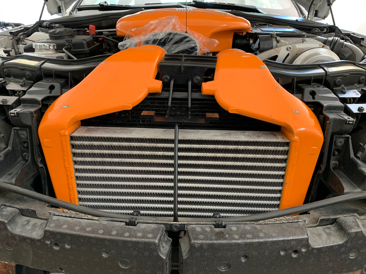

Looks like the GP-Infinitas (G-Power) kits have come WAAAY down in price since my kit was purchased.
Not sure, but it could be that the install is more demanding than other kits though, because of the intercooler installation?

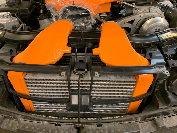

https://www.mstyle.co.uk/bmw-3-serie...s/g-power.html
The G-Power kit requires cutting of the radiator support for the heat exchanger inlet/outlet, which most are not prepared to do. If ever going back to stock - that entire piece must be replaced. #1 in the diagram below.
Yes, 100% the surgery is necessary to fit the intercooler.
However, the kit comes with templates for cutting the support and the other items behind the bumper, so at least if you are going to cut, they remove the guesswork from the operation.
I even took it a step further than they did to enhance serviceability.
It was a total bitch to work on the front of the engine when I couldn't remove the radiator fan assembly because the intercooler prevented me from doing so.
But again, my kit is a really early version and judging from the latest pictures, the intercooler mounting looks to have changed a little since 2009?
As far as going back to stock, if I were to sell off my kit, yes I would probably replace the support, or at least fabricate some patches first, to see what that would look like?
Also, I go back to stock every two years, just the way it is, and so far no structural or cooling issues, but it looks stupid because part of the stock airbox snorkel has to be left off.

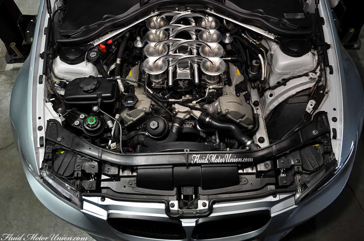

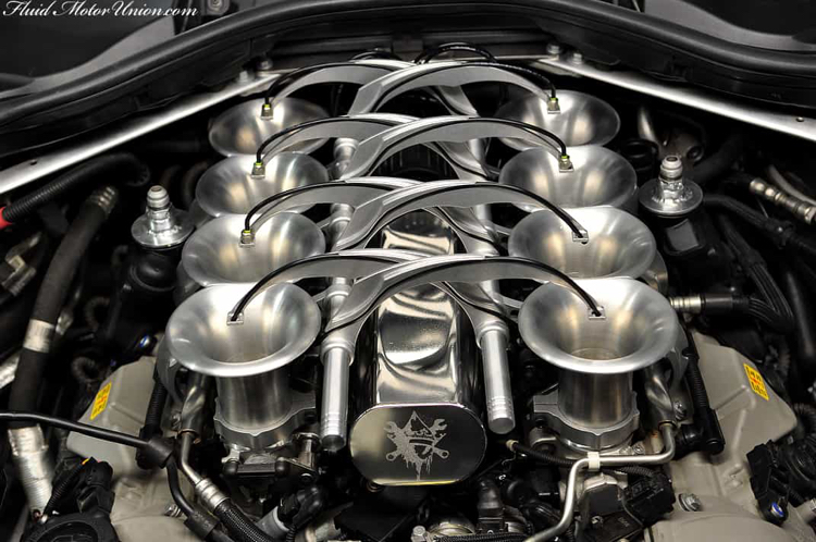

      08-08-2021, 04:29 PM   #41
pbonsalb
7679
13,758
Join Date: Feb 2011
Location: New England
Fluid Union
https://www.***********.com/content....-of-art&page=5
DrFerry10035.50
      08-08-2021, 05:49 PM   #42
DrFerry
Field Marshal
DrFerry's Avatar
10036
2,641
Drives: 2008 E92 M3
Join Date: Jul 2010
Location: Greenville, SC
Originally Posted by pbonsalb View Post
Fluid Union
https://www.***********.com/content.php?1400-Fluid-MotorUnion-E9X-M3-S65-V8-velocity-stack-intake-system-with-water-methanol-injection-completed-Work-of-art&page=5
Wow, I'm lovin' that work of art..
